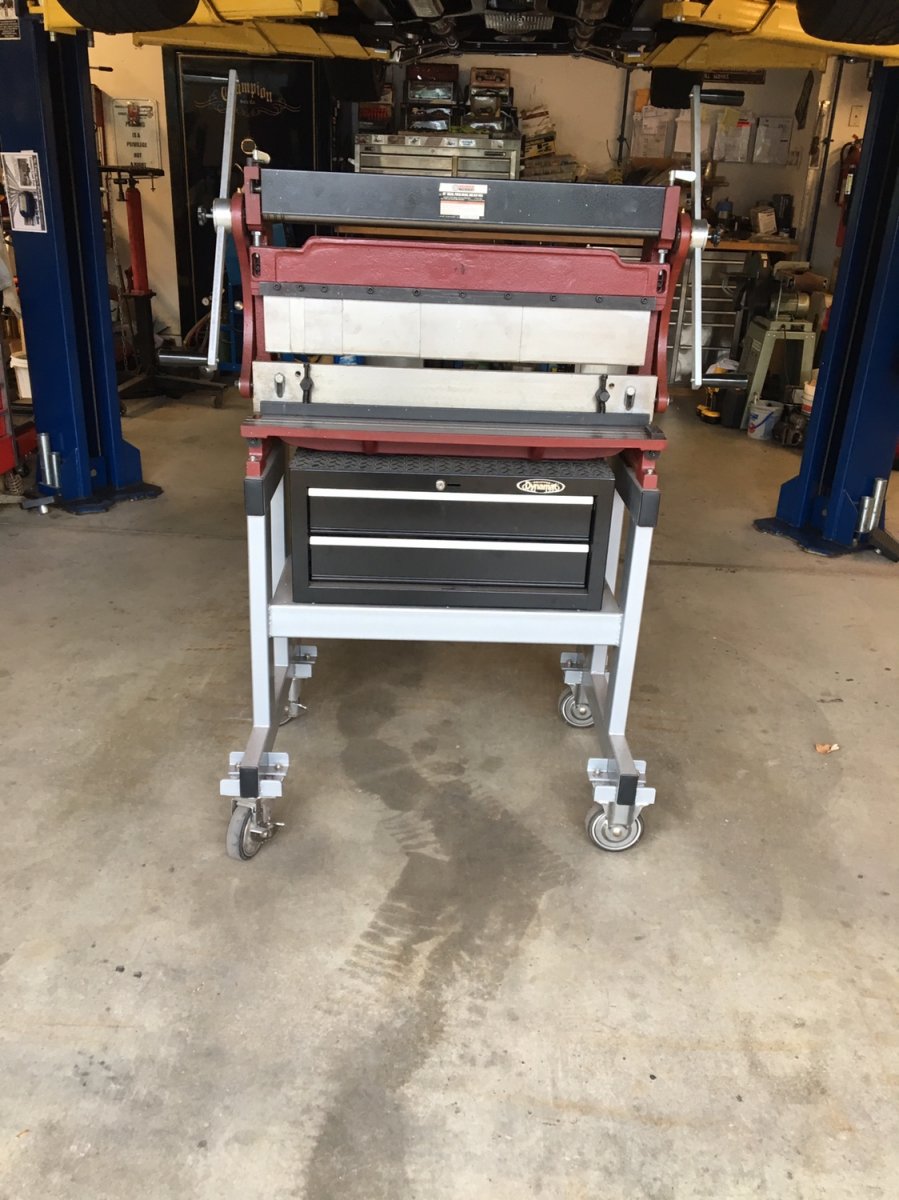

    A second handle is a must. Nice setup you've built there:)
