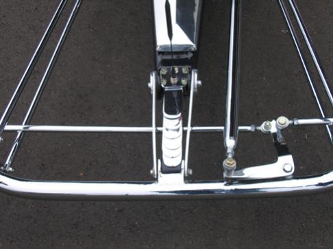

    I found this picture from Guffey interesting. It has a single 1/4 elliptic spring in the middle of the axle. They even put a shock absorber on it. I was thinking of using this on an I-beam with hairpins to add a little roll control. Hopefully Guffey will chime in and let us know if it worked well or not.
    http://i281.photobucket.com/albums/kk225/wellohhhkthen/waterpipec.jpg
  2. Well looking at the height of the spring attachment,
    and hence roll centre, that has too be low enough to defeat any arguements by Warpspeed with regard to roll couples.
    Certainly shows proof of concept, my guess would be that it was 'good enough for a few runs before the next game plan', sure is built light, way more fragile than the kind of thing I figure you have in mind using a beam axle and over sized hairpins.
    Actually I have to say that seeing that gives me a lot more confidance in my own home made tube axle design,
    Reversing the king pin set up allows the hub upright to carry a couple of cheap taper races, which are very easy to pop out and change track side, plus it meant the axle could be two fairly thin walled tubes rather than needing to go for much heavier walled or very large diameter for a single.

    Thunderace, I'd like to see more pictures at different angles so I can understand it better.

    It is all certainly built extremely low, but so is the ground clearance.
    Can you imagine the damage if the front of that ch***is dips on it's spring a couple of inches, and the ch***is then hits something solid ?
    Another problem I can see with this greatly extended front ch***is, is lack of torsional rigidity at the very front. The ch***is is going to flex long before the front antiroll bar does.
    My guess is, with a still reasonably high front roll centre, and a flexy ch***is there is not going to be sufficient roll couple transferred to the front to eliminate the m***ive oversteer caused by the high rear weight bias.
    As mentioned earlier by Tunderace, Formula V's have this exact same problem, and they get around it by having very high roll resistance at the front and very low roll resistance at the rear. Rear engined Porsches have this high rear weight bias problem too.
    But that long extended ch***is will prevent you from building in sufficient front roll stiffness, without making the ch***is heavy and ugly.
    Your problem will be getting enough front roll resistance. Building a zero roll resistance front suspension is absolutely the wrong way to go with this design. I ***umed this was going to be a conventional wheelbase hot rod ch***is, not an ultra long wheelbase slingshot dragster.
    This design certainly has it's virtues, but good cornering ability, and neutral handling, are not going to be a**** them.

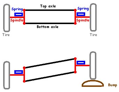

    Suspension theory is all well and good, but it doesn't seem that's what the OP is looking for. All he needs is an innovative front end to hold up the front of his street digger. Like a regular spring perch, turned 90degrees and attached to the center of the front axle, to hold the front of his spring. The perch will pivot up-n-down and allow the axle to rotate (one wheel in a pothole, the other on the curb issue). Some radius rods/wishbones/hairpins/whatever to locate the axle. How about some rotary shocks from a motorcycle (like a Suzuki TL1000) for damping? A Watts linkage to keep the whole thang from getting overly wobbly. I'm thinking a ring or oval that the spring pokes through, with mounting studs mounted at 12:00, 3:00, 6:00 and 9:00 (or North, South, East, West if you want to think of it that way). The East-West are mounted to the axle (somehow, it's gotta be behind the yaw pivot point so that will still, well, yaw..."an exercise left to the reader") -- think of the center mounting of a traditional Watts linkage -- and the North-South points are the end-points for the rods that mount to the frame. Just some more non-educated wondering to further stir the pot...

    O/k then, why not use only one front wheel ? I am serious. That has zero front roll stiffness. Build a trike. That would be both unique, simple, very light weight, and have the pointy front end "look" he is seeking.

    Lots of good ideas there, Nitrobrother. Would it be too much trouble for you to draw this? I think I can see it in my mind's eye but not sure.

    I will grab some more pictures of the Thunderace tube axle, but for now here is a picture showing a bit more detail;
    The stub axles have two inches of lead ahead of the king pin axis,
    which reduces the rise and fall of the frame when steering with a high caster angle.

  14. nitrobrother
    Joined: Dec 24, 2004
    Posts: 4,379
    nitrobrother
    Unfortunately I **** when it comes to graphics...haven't done anything worthwhile since 2002 and my Paint Shop Pro days. All I have is GIMP on this laptop and I don't have the skills or patience to do anything of value. I can't get my head around how to give the "ring" the pivoting capabilities of a traditional Watts linkage. The other ideas was to have a spring perch that pivots to allow the axle to articulate, removing the twisting stress on the spring itself; basically the spring only does what a spring it 'posed to do: suspend the car.
    I don't know any theory or practical implementation of how a "hollow-center" Watts linkage would work with narrow front frame rails, but hopefully someone smarter than me (which wouldn't take much) can throw out some ideas to further refine this.
    IMHO, it seems that wsdad isn't going for ANY kind of handling prowess, and is looking for "how can I make this work for the street" rather than "that's the most stupid thing I've ever seen".....

    My brother pointed this out to me also and it troubled me for quite a while. I almost s****ped the idea because of it. But if you look at the suspension, the forces are actually at the corners. This is kind of hard to visualize and hard for me to explain, but I’ll try.
    First, let's deal with the spring in the middle, "as far from the wheel as possible," as you rightly said. Then we'll examine other parts.
    1. In theory, when both wheels go up at exactly the same time on a perfectly smooth road, the force of the spring is transmitted equally to each wheel. There's no instability there due to the distance of the spring from the wheels. Please don't point out that there's no such thing as a perfectly smooth road - just humor me for now.
    2. When the axle is pushed perfectly sideways, the flat part of the spring resists any sideways movement of the axle. The leaf is several inches thick in that plane and cannot bend. Even though it's a long way from the wheel, it's ok because it is pushing in line with the load. It's pushing through the axle to the wheel. No problem. (Imagine you're squishing a bug on the floor with the end of a broomstick. The bug will feel the same weight whether you grab the broomstick at the top, middle or bottom. Your hand is the spring and the broomstick is the axle.)
    3. When one wheel is pushed back, as if hitting something it can't roll over, the leaf spring is useless because it's so far away from the wheel. The wheel has a mighty lever that the spring is unable to resist, no matter how thick it is.
    That's what the hairpin does. It resists the "pushing back" force of the tire. Because the hairpin is mounted very close to the wheel, it’s stable.
    The other end of the hairpin is mounted on the frame several feet behind the wheel. One would think this would be a problem, being mounted so far away. It still works OK though, because the hairpin is in line with the force of the wheel. (Imagine the bug is on the wall this time and the broomstick (the hairpin) is pushing into our poor little abused friend. It still doesn't matter whether you hold the broomstick in the middle or end, the bug will be equally pissed. The only way I can see that this might be morally OK is if the bug were some sort of Beetle from Germany. No one but hippies care if you crush Beetles. Muah-ha-ha-ha! Just kidding - I like Beetles.)
    4. When one wheel is raised, as in rolling over a bump or if the body rolls in a corner, the leaf spring is too far away to do any good. Again, the wheel has a mighty lever, rendering the distant leaf spring useless. The hairpin is also useless by itself. It just goes up and down with no resistance.
    However, if you add a torsion spring to the end of the hairpin by the wheel, it pushes the wheel back down. Now attach the other end of the torsion spring to the other hairpin near the other wheel and you’ve got yourself a sway bar.
    The torsion spring is the axle. You can't get any closer to the wheel than the axle.
    Because the torsion spring and the hairpin are both mounted so very close to the wheel, they stabilize it in all the places that the distant leaf spring fails. If we were relying solely on the leaf spring for stability, it would be a disaster.
    Because the leaf spring is pushing in line with the lines of force acting against it and because the wheel is mounted so close to the hairpin and torsion spring, it’s stable.
    At least that's the theory. We'll see once it's built.
    Here's a close-up of a nice looking 3 link on Ewald’s dragster (Thanks 64Dodge440!).
