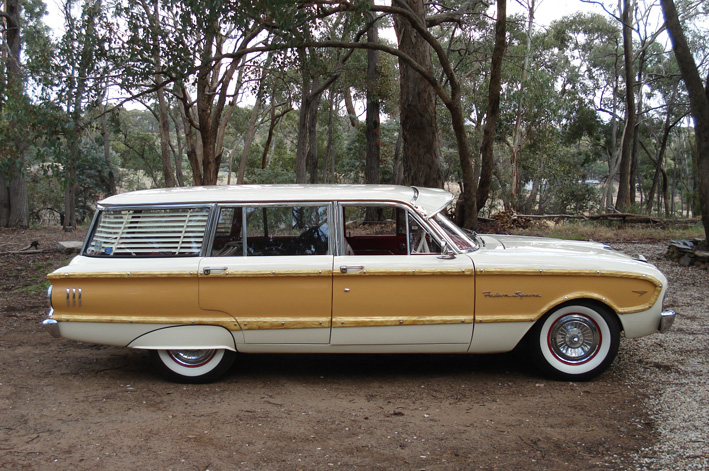

  10. Unfortunately you can't get a falcon super low without making major modifications.
    I have 3" blocks in my squire, and as others have mentioned i have opted for 14' wheels and a tall profile tire.Ii dont have any tail-shaft scrubbing but it is close.
    A mate has put 4" in his 13" wheeled falcon and it makes the spring shackles scary close to the ground!
    Good luck with it.
