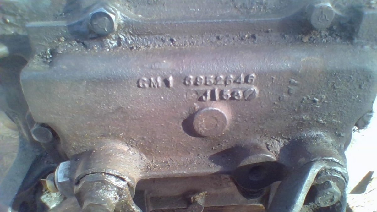

    wow! Awesome info. Thanks. I wonder what the 83mm is about? Thats about 3.25 inch I think. The driven gears maybe?
    Its a shame there is all these little references in charts, and manuals, but nothing that flat out states what its actual name is, application, dates of manufacture etc....
    I'd bet this one still works, but I would like to rebuild it. Sadly I would never tear it down unless I was sure I could get parts....
    //edit// Found it ----> The heavy-duty 3-speed (RPO M13 in 67-68, or MC1 in 69)

    The 83mm refers to the center to center distance from the main shaft to the countershaft.

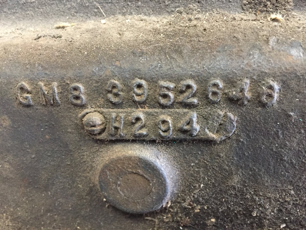

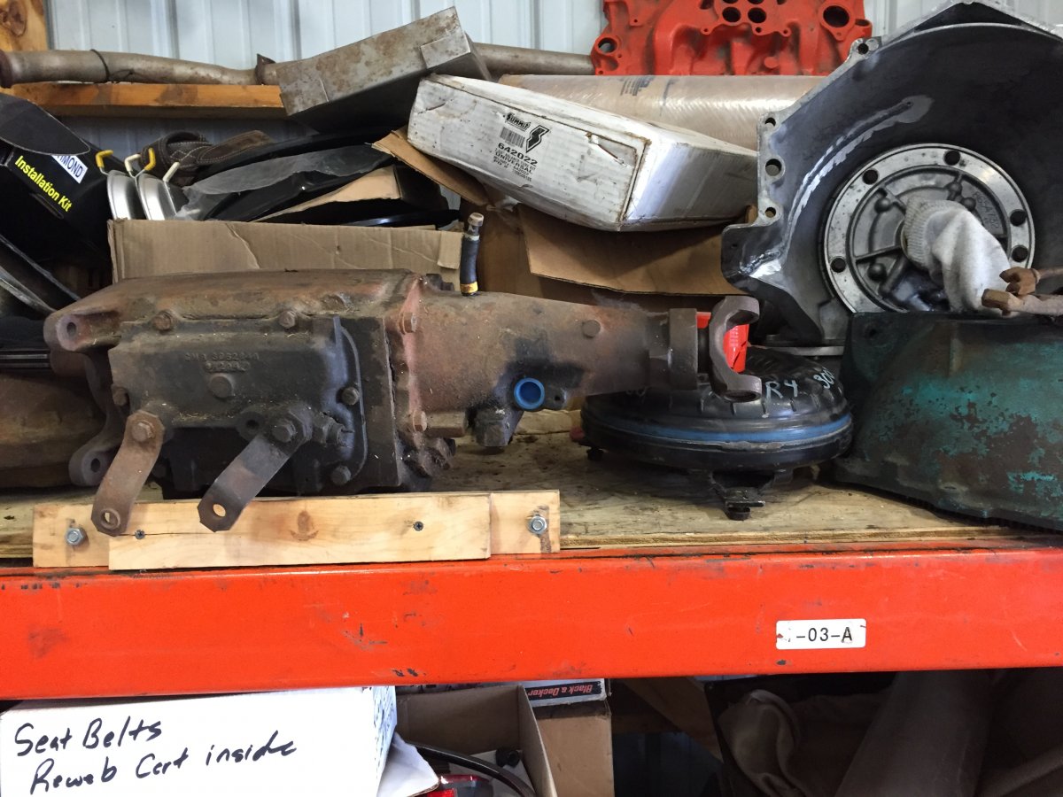

    Thank you for the info, picked this up at a swap meet and it has the same casting number as blockhead555 :cool:
    Any one know what transmissions can be used for a donor for the speedometer drive. :rolleyes:

  10. If you don't mind what number do you have on your tail piece mine is 3968035
  11. your date code on the side cover is August 29 1974 so as long as the tailhousing number numbers match I think you have a donor
