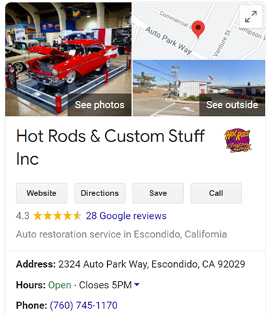

    That number sounded familiar when I was scrolling through my research for hot rod shops in So Cal. The 760 area code is in San Diego County and when checked, it ends up in Escondido, CA. Home of the recently cancelled "Cruising Grand" event that is/was so popular in So Cal.
    Jnaki
    The website is listed for Hot Rods & Customs Stuff, Inc.
    Last known Google Photo: Nov 2020
    But, a review was posted from a month ago. So, you might want to call them to ask your questions.
    Bob Lowry likes this.

    That's a cool shop. I was in the area on business with a co-worker and as we drove past the place we noticed it and spun around and went inside. They took the time to give us a tour, and it's a good size piece of property, a good stash of old hot rod parts, and they do some really good work; and they have a shop in front for speed parts.
    jnaki likes this.
