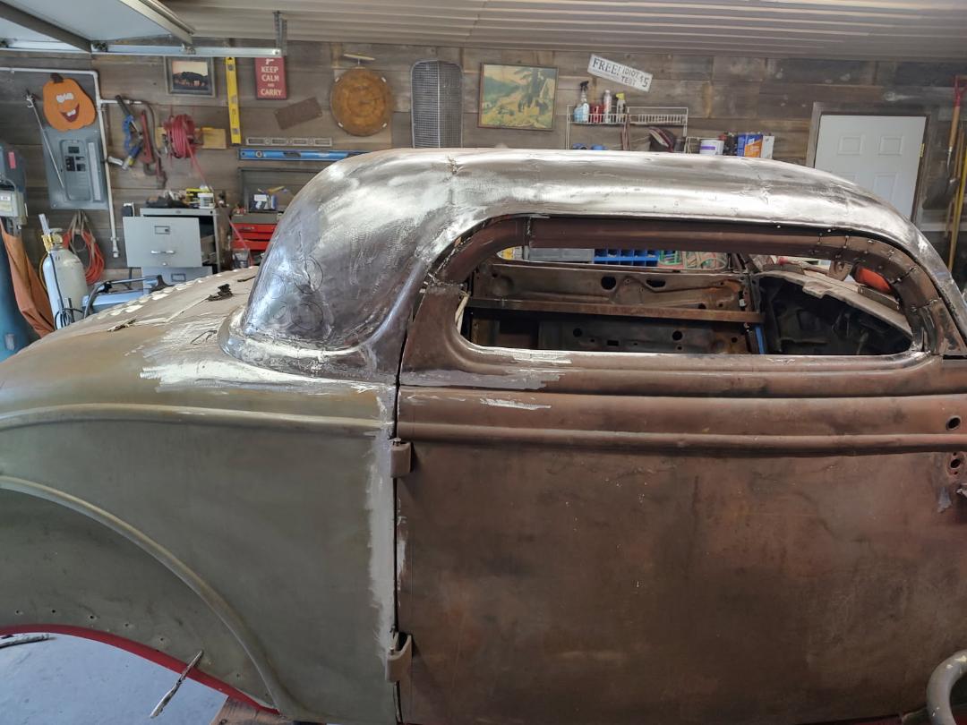

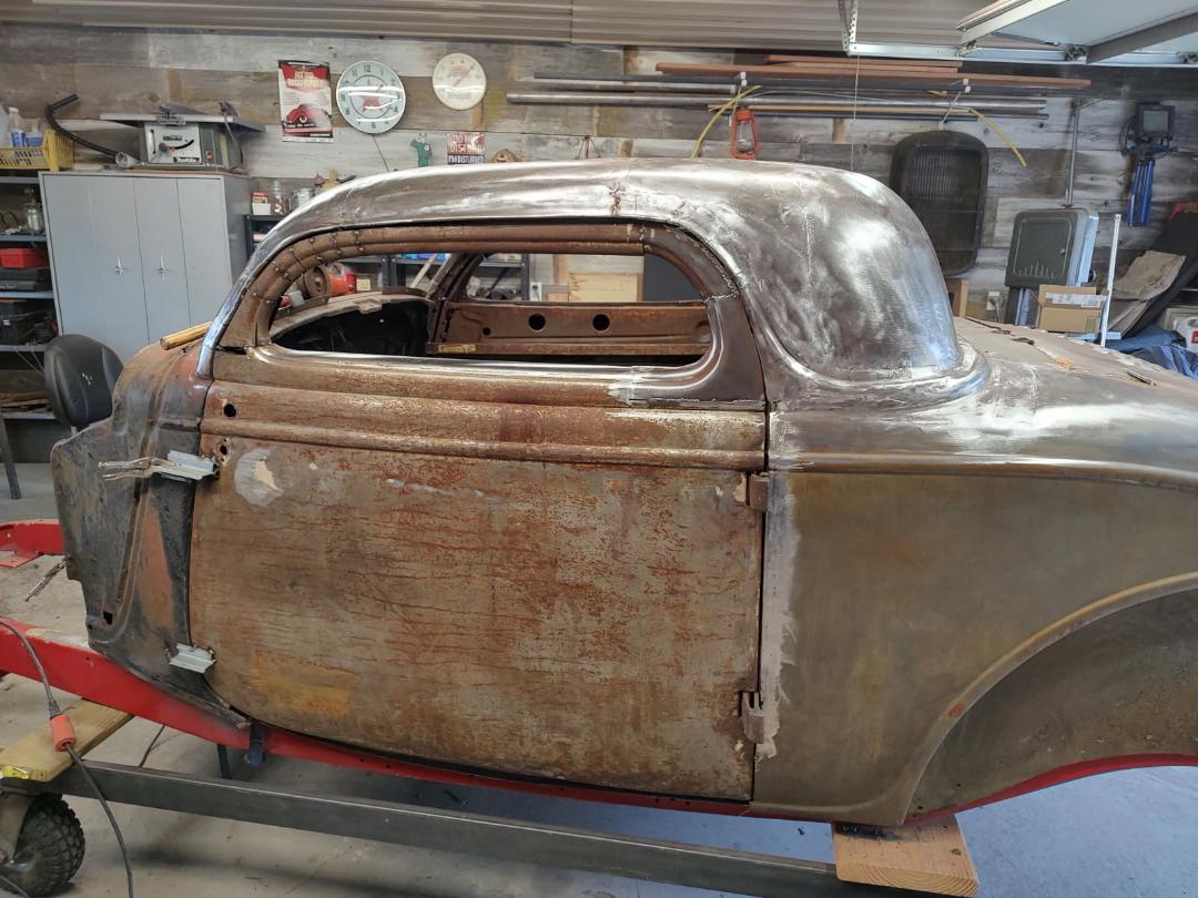

    Thank you, I'll be away from the car for about 2 weeks and I keep looking at the last pix I posted and wonder if the rear section of the roof needs to come down a little. Opinions are welcome.

    I don't think so. Personally I think they get too boxy/squished looking with a heavy chop if the front and rear are the exact same height. I like what you've got going.

    man, really cool... The best way to figure out if it is right or not is to roll it outside and step way back from it... Looks fantastic to me though... carry on!

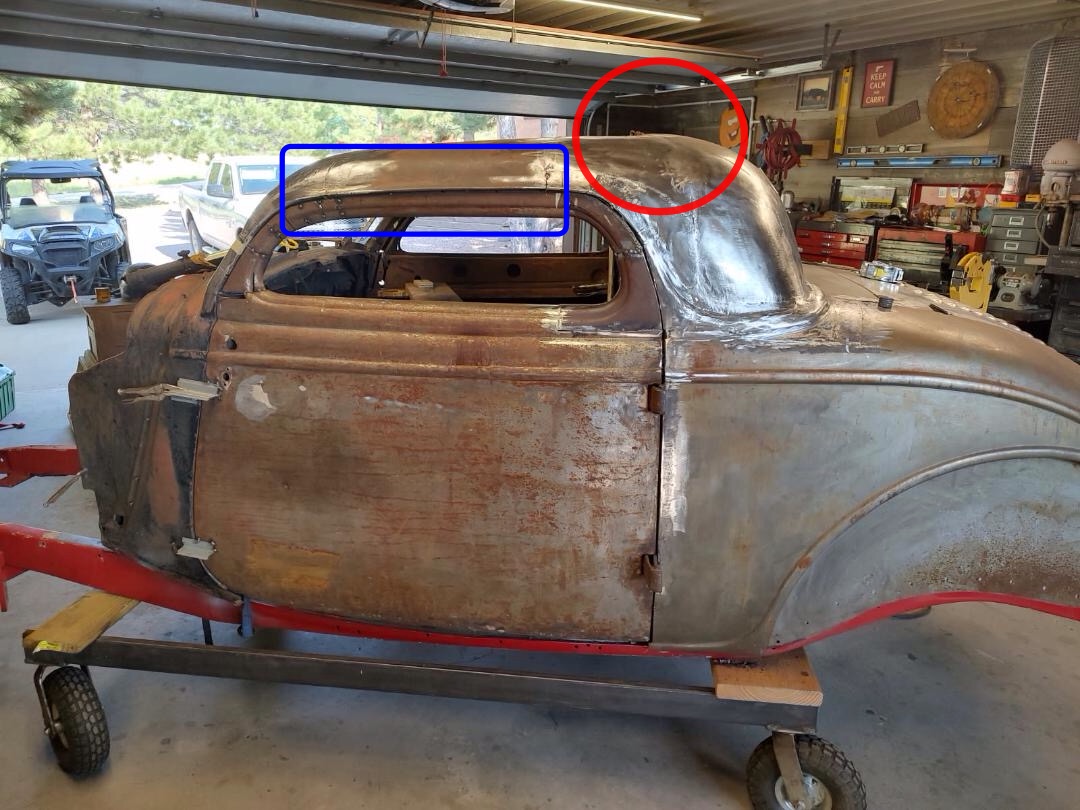

    It looks like there’s a small hump (inside the circle) is that an optical illusion?
    The straight portion of the window surround (in the rectangle) looks off to me. The factory three-door has a subtle curve there.

    I'm concerned about the hump, I think it looks to full if that makes sense. I may have to get a better look when I get back to work, The door top doesn't bother me as much, I think there is only about1/4' to 3/8 " of rise in the blue box.

    I think it looks badass…considering what you started with, I certainly would not sweat a small rise or a hump or perceived humb.

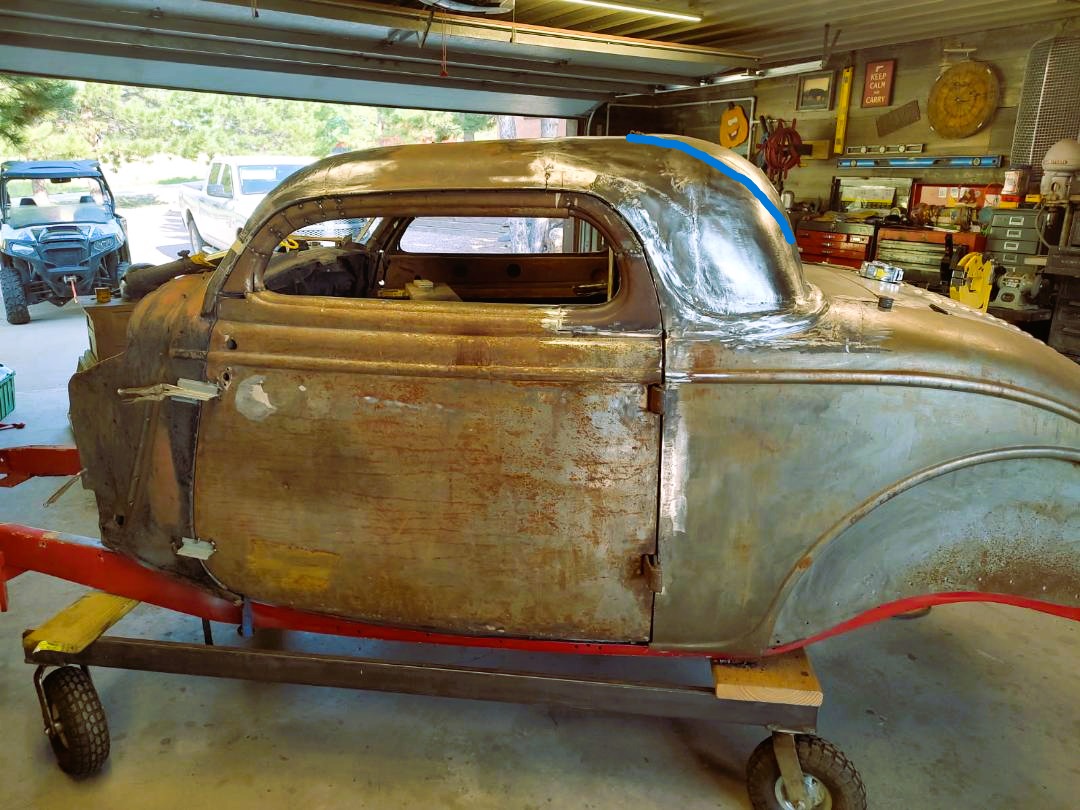

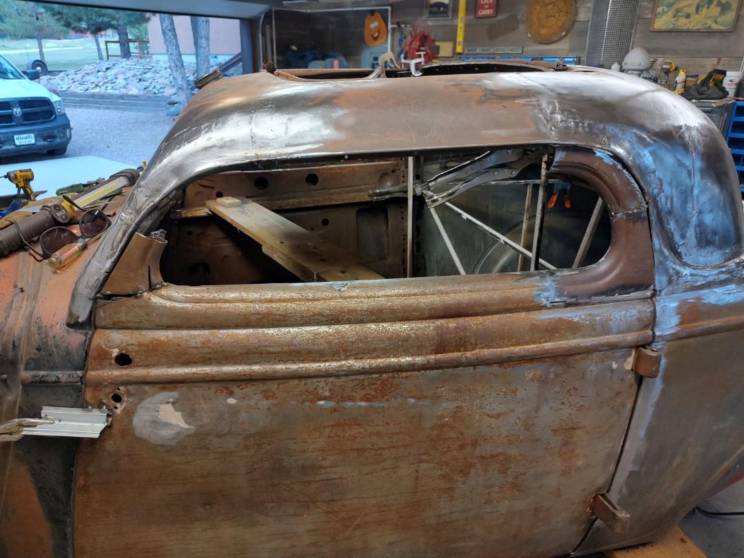

    Gary, I've looked at a lot of pictures of heavily chopped 33-34's, I think I need to bring the top down and thumbnail (55).jpg forward like the blue line in the picture

    Your top is lower, but here is a profile of the Kalifornia Kid. The back of the roof appears to be somewhat in the same plane as the raised area behind the door. Parallel ? The-California-Kid-LR-RGB-300x157.jpg

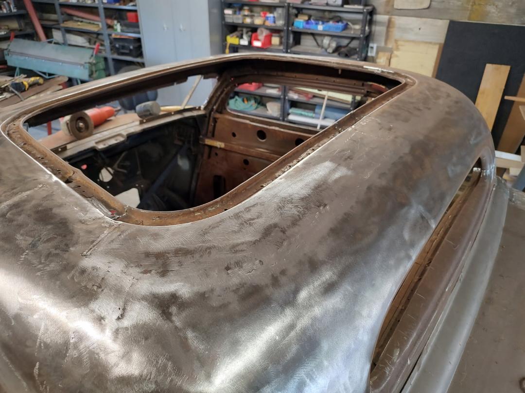

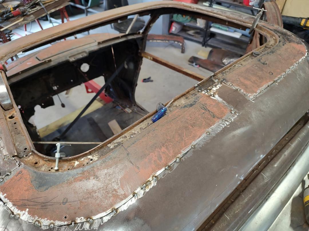

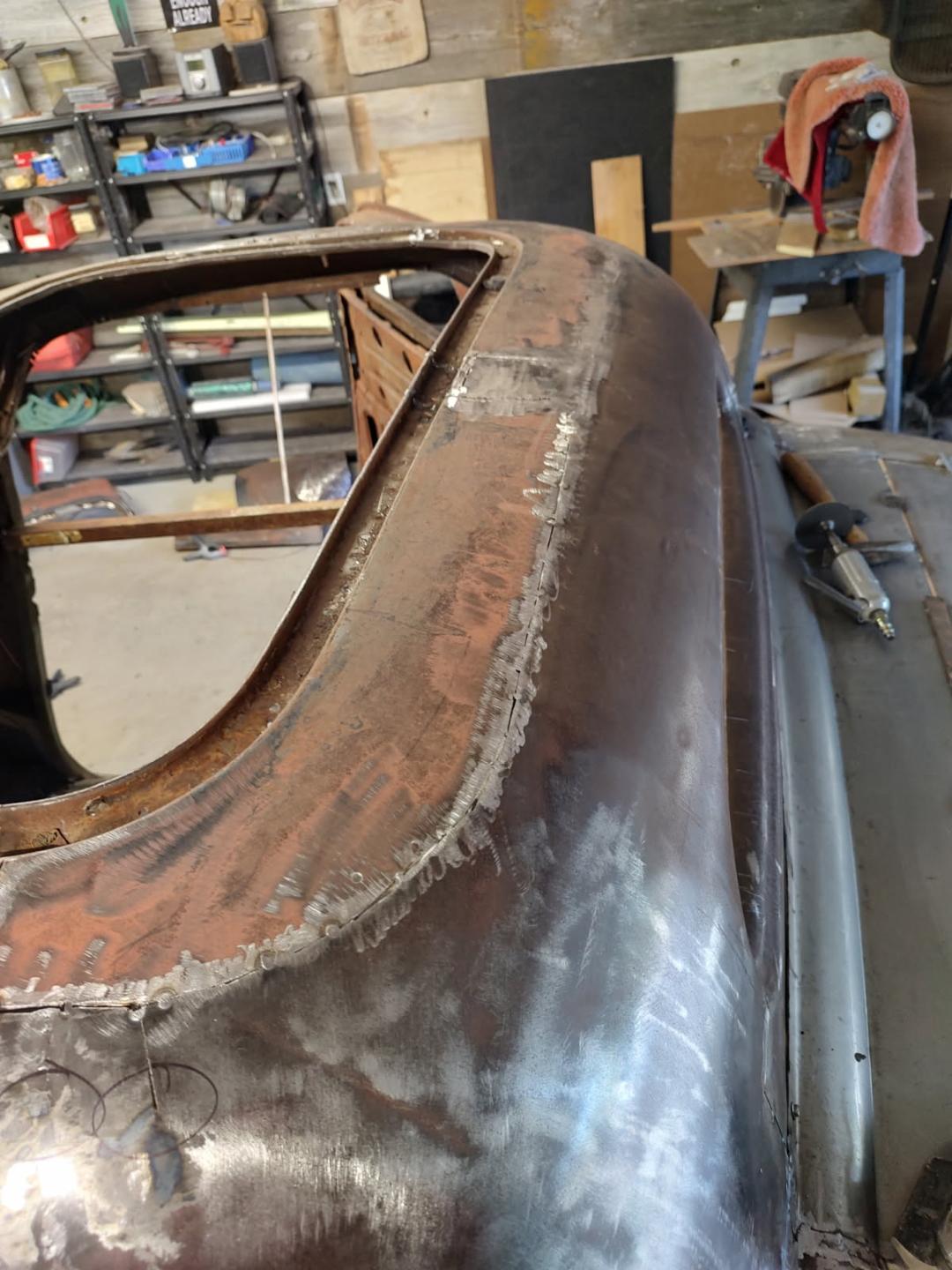

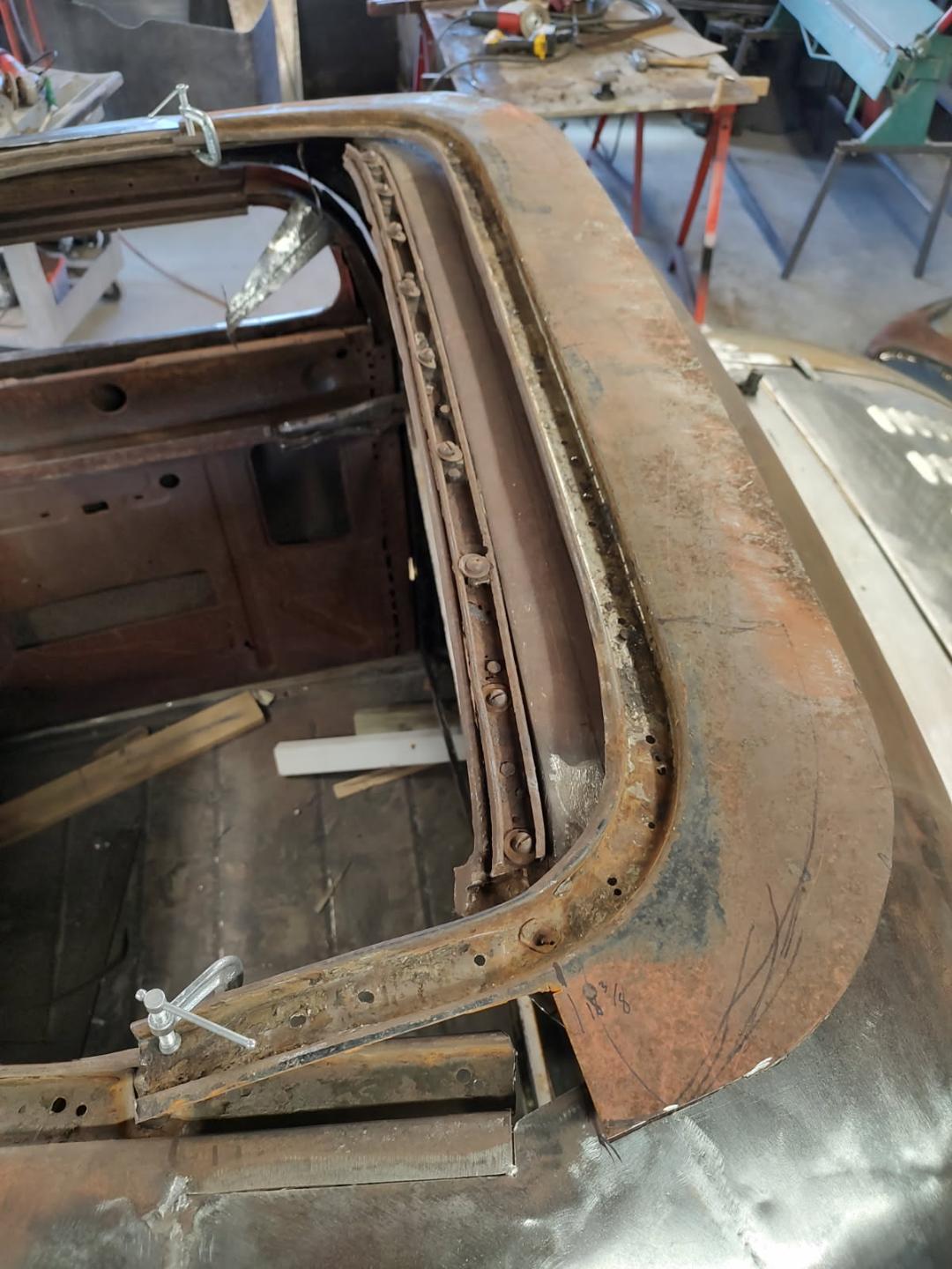

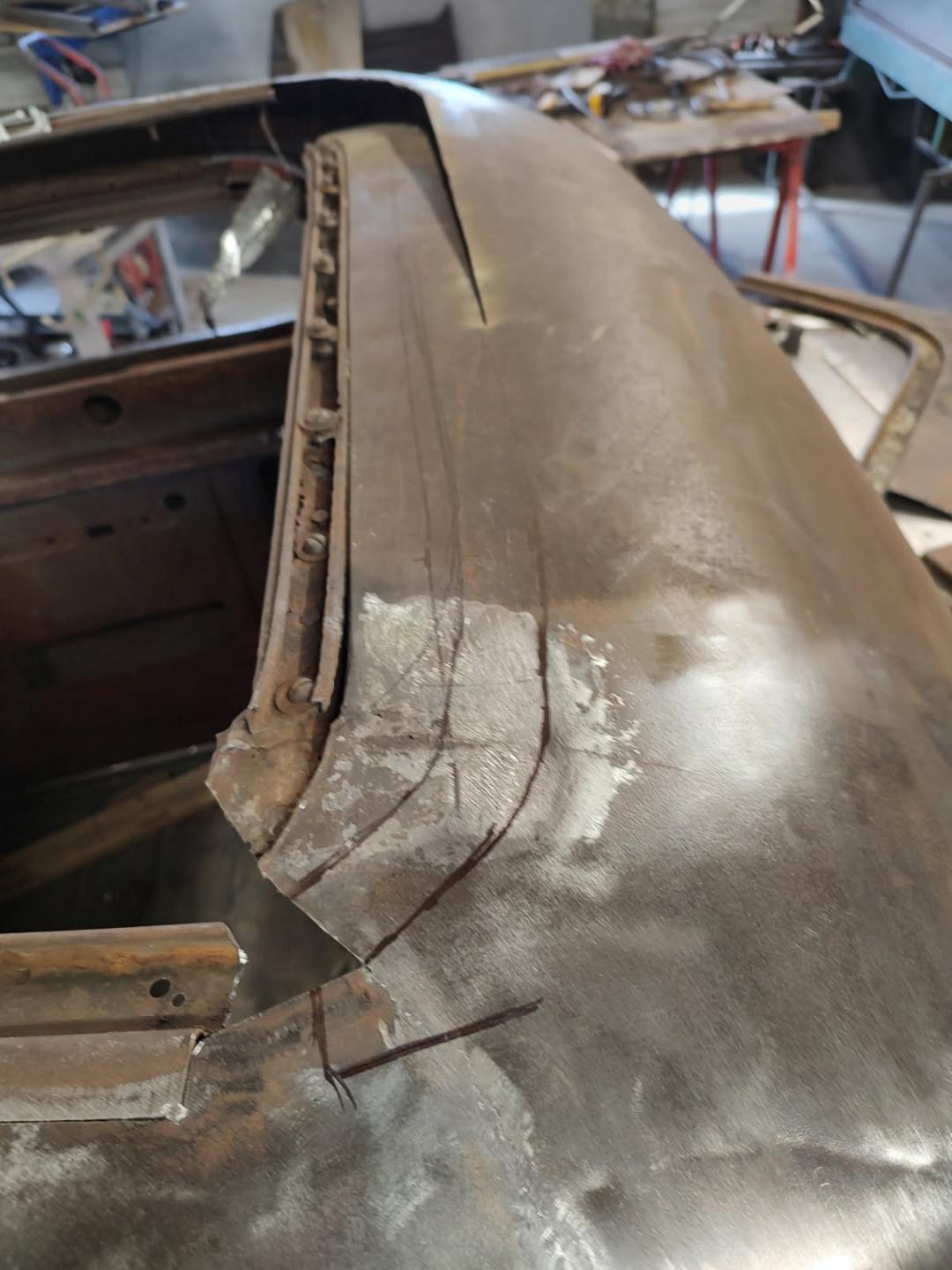

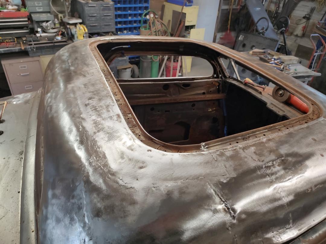

    I think I worked out my problem with what I considered a hump in the roof. I had to make the roof opening about 2" longer to match a 3W opening. I used the front section of another roof and flipped it around and widened it 3" to line up. I was able to lower it about a half inch where it tied into the sides of the roof. I'll have to shrink a few of my welds and do some welding under the back window, I'm happy where it ended up. thumbnail (39).jpg thumbnail (40).jpg thumbnail (42).jpg thumbnail (43).jpg thumbnail (45).jpg thumbnail (46).jpg
