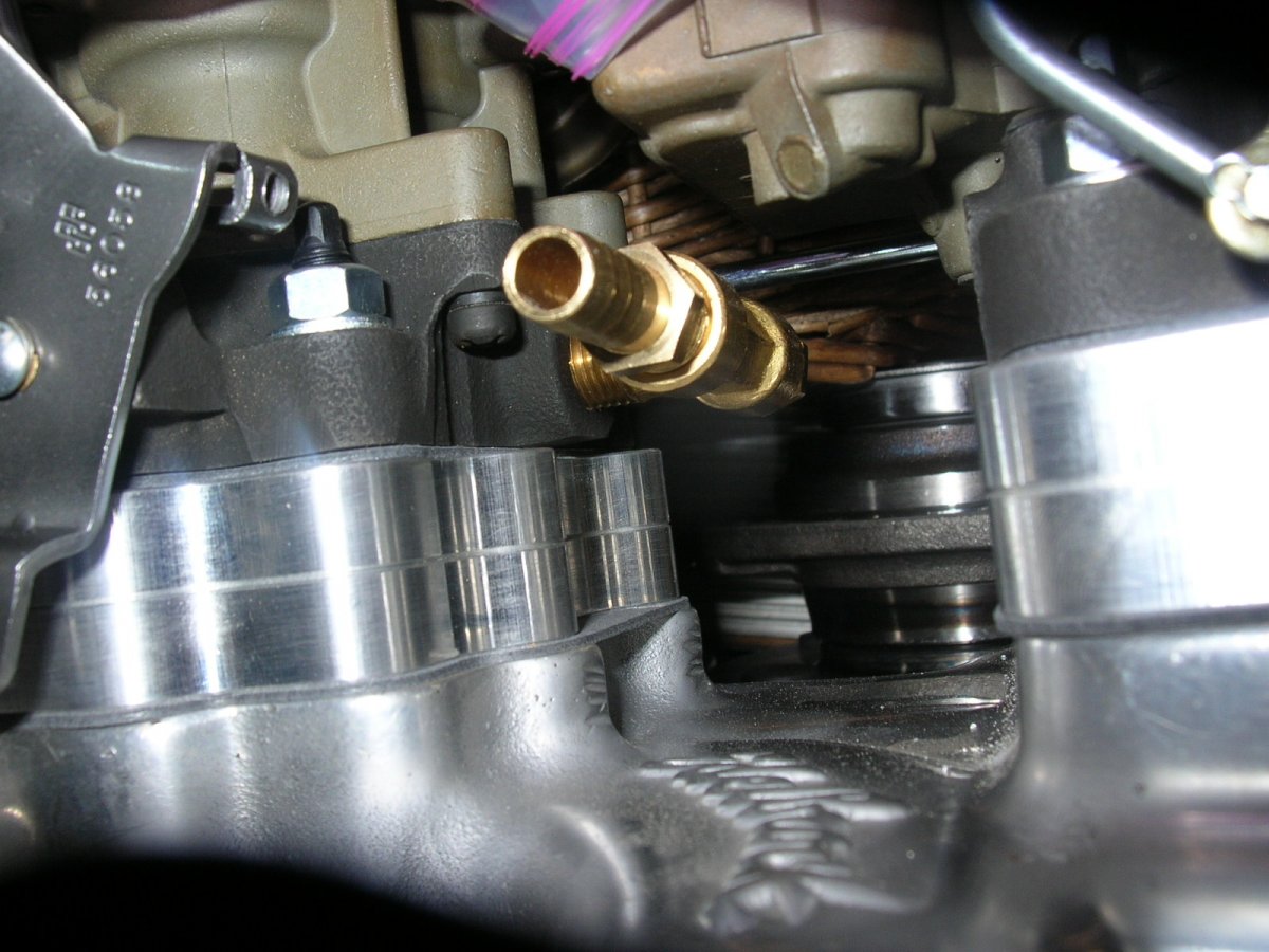

  2. Good timing I am wrapping up a build of a 3x2 rochester setup on an Edelbrock intake.
    You want to use manifold vacuum for your distributor advance, Many carbs have the PCV / power brake teed in with the distributor advance and or transmission modulator. DSCN2795.JPG DSCN2796.JPG DSCN2797.JPG

    Use the 1/8" threaded vacuum port on rear of manifold for the distributor advance. T the pcv and brake booster off the center carb. The booster only uses vacuum when you step on the brake pedal, so it should be fine with the pcv.

    If you Tee the power brake off the PCV it's like there's a vac leak to the booster. Don't ask how I know, it was maddening (!), but you want an independent source for power brake vacuum.
