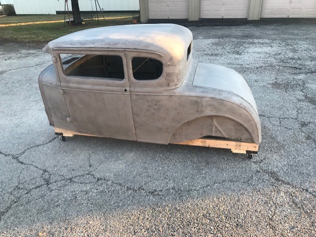

  8. Mo rust
    Joined: Mar 11, 2012
    Posts: 880
    Mo rust
    I don't use any wood when I build a model A coupe. I locate where I want the body to sit (I always put them on 32 frames) and lay out some sub rails connecting them to the cowl and I weld the body panels together and fill the top with the roof skin of a 90's gm extended cab pickup. By the time you get the body all stitched together, it's solid. Ford used wood because he was building bolt together bodies and needed the wood for structure. If you weld it together the only reason for wood is to anchor upholstery and there's ways to do that with steel too. For the guy with a nice survivor body with wood in it, by all means preserve it like it is but if you're piecing together a body without wood, just weld it. Here's an example that I welded together using a 32 firewall and cowl vent and 30/31 sedan doors for 1 1/2" more leg room and a 5 inch chop. It's already setup for a 32 frame. This is one of my dozen projects waiting their turn to be built.

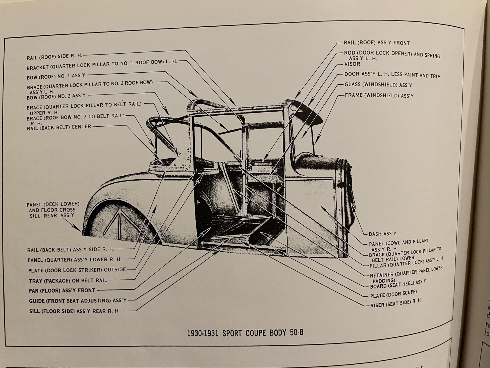

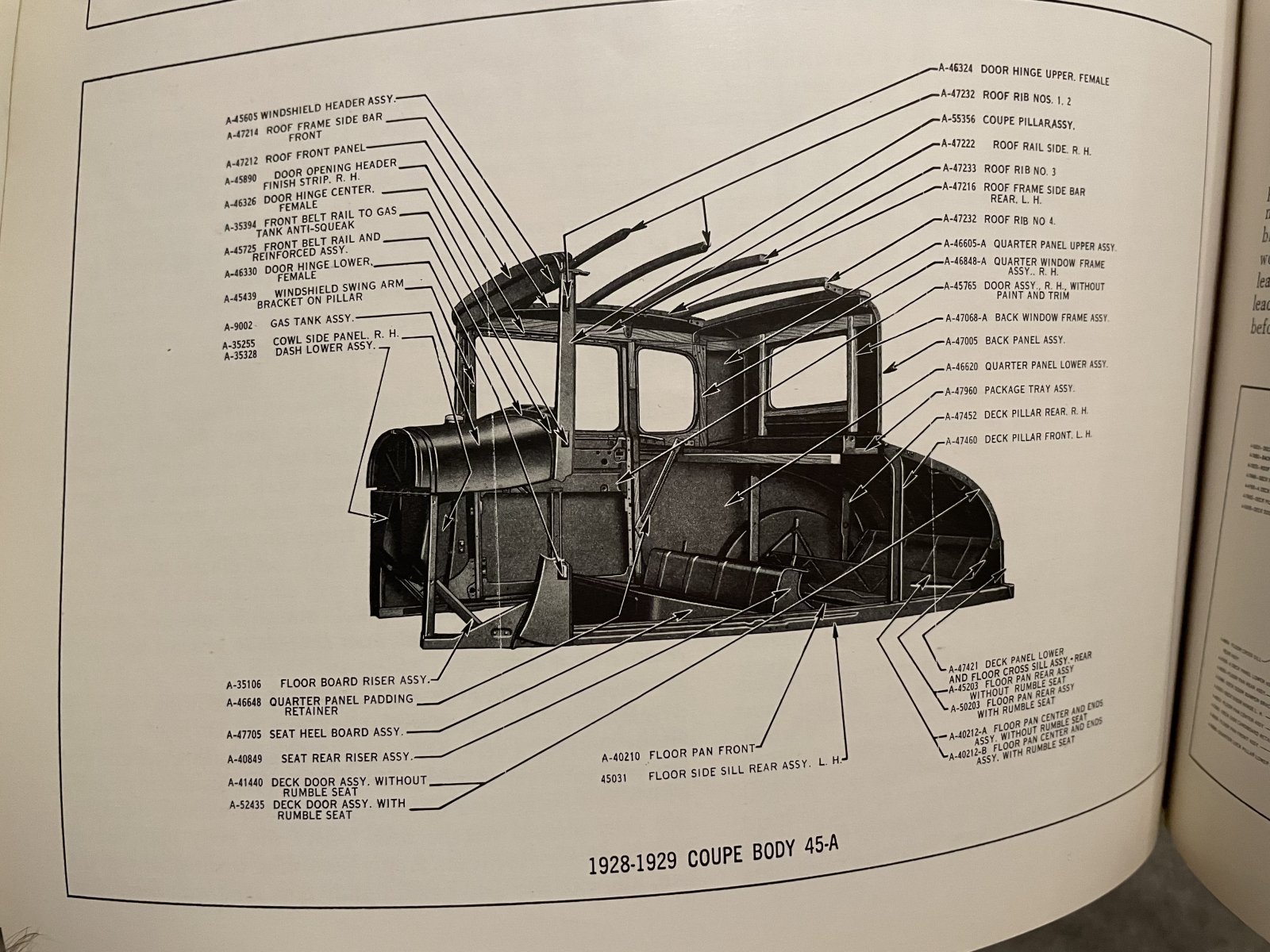

  10. Tim
    Joined: Mar 2, 2001
    Posts: 19,599
    Tim
    from KCMO
    This isn’t exactly what I was looking for but it’s a 29 coupe and a 30-1 sport coupe to get some ideas I know I’ve seen a page with a skeleton of just the wood I’m just not grabbing the right book yet 329EDCF2-E10E-4FA2-853E-D2520FDAAE62.jpeg D4EAAB74-6B67-4A37-8596-79FA21653673.jpeg
