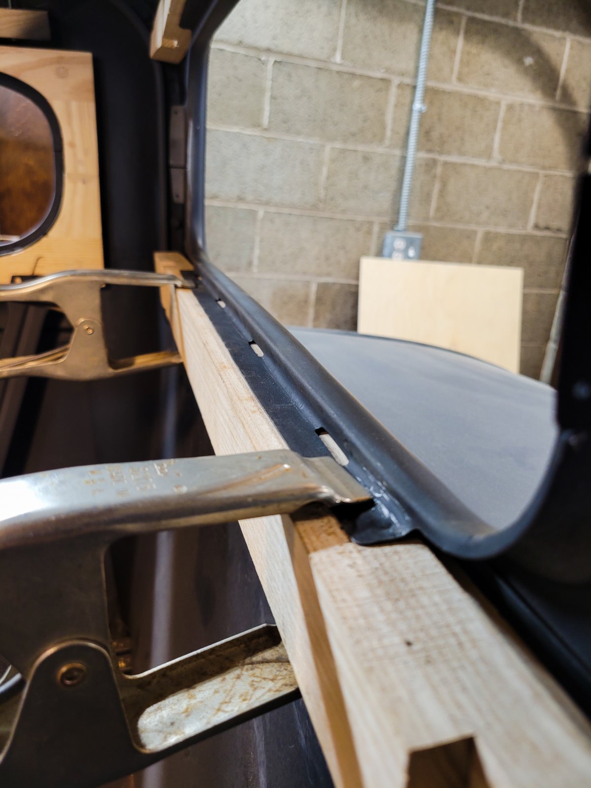

    I have been working on fitting the wood around the windows in my 30 coupe but I came across something that doesn't seem right and I never noticed it.
    At the bottom of the window opening the slotted lip doesn't jibe with the lower section of wood. I am not sure if I ever had the wood to compare it to but something isn't right.
    Even comparing it to pics online it seems different. Is this a roll-down window opening? If so, have any of you fitted a standard wood kit?
    Model A guys can you help?

    Since the bottom flange is bent straight down it most likely had roll down back window. The 30 coupe used thinner wood, when the went to the roll down window for 31 the wood is much thicker even on non roll down windows. I can post a photo tomorrow of mine which is 1930 style.

    A 32 coupe I've been working on had the lower flange like yours since all 32's have roll up windows. I didn't want the roll up feature, so I bent that flange to match the other sides. I made my own wood so it fit perfectly.

    I don't want roll up/down windows either. I hadn't even considered that my car was anything but standard until tonight. Since I have the standard wood kit, it looks like I'll be modifying something soon...
    Here I was thinking I was going to get off easily!:D

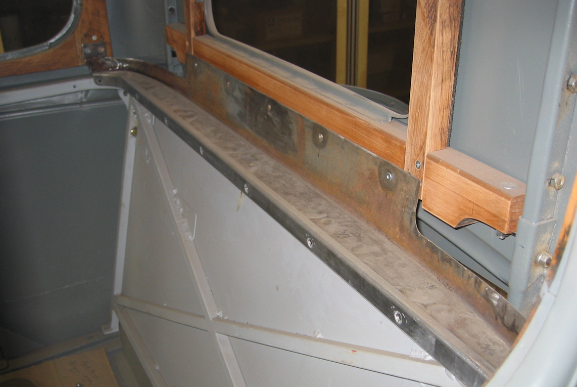

    This is a '30 coupe still intact with the package tray and no roll down window. Never been apart. DSC06821.JPG

    @A 2 B thanks. I definitely have the roll-up/down type opening on my car then. Thanks for the clear pic.
    Thanks so much, everybody!
    Now to figure the best way to proceed...
