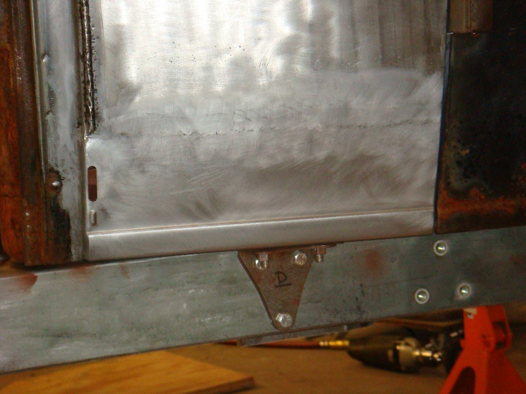

    body stand 1- speed week 2 005.JPG Building a low buck Cabster body ; '30 closed cowl, '30 tudor doors and '29 sport coupe quarters...
    bought a pair of '35-'36 tudor sedan door patches... 35" long... they curl upward towards the front... the front 13.5" of them does the cowl patches ...look cool on the cowl... added the wedge shaped strip under the bead because '29 roadster does that... the '29 qtrs don't have a wheelwell reveal so i stopped that reveal about 7" beyond the door gap... [rounded it over] ... this leaves about 14" of the original panel, enough to patch a flat bottomed '30 - '31 cowl...
    6 patch panels from 2... pic is of a previous '30 coupester build...
