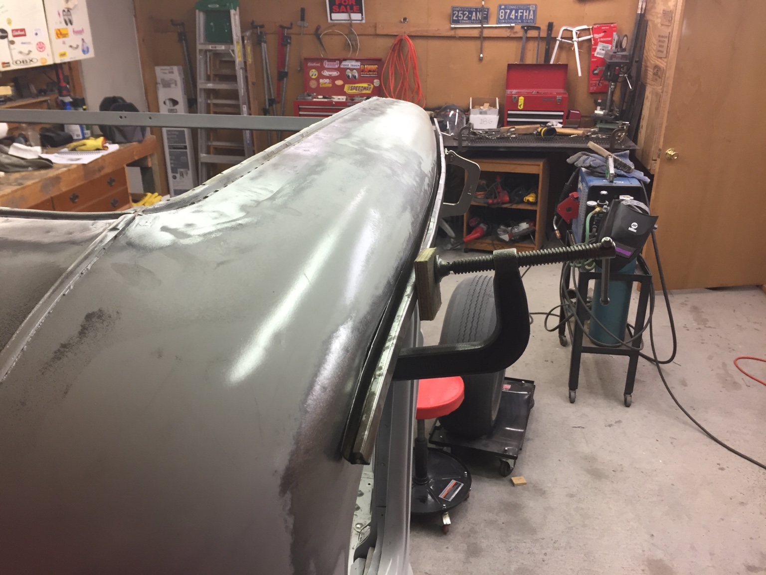

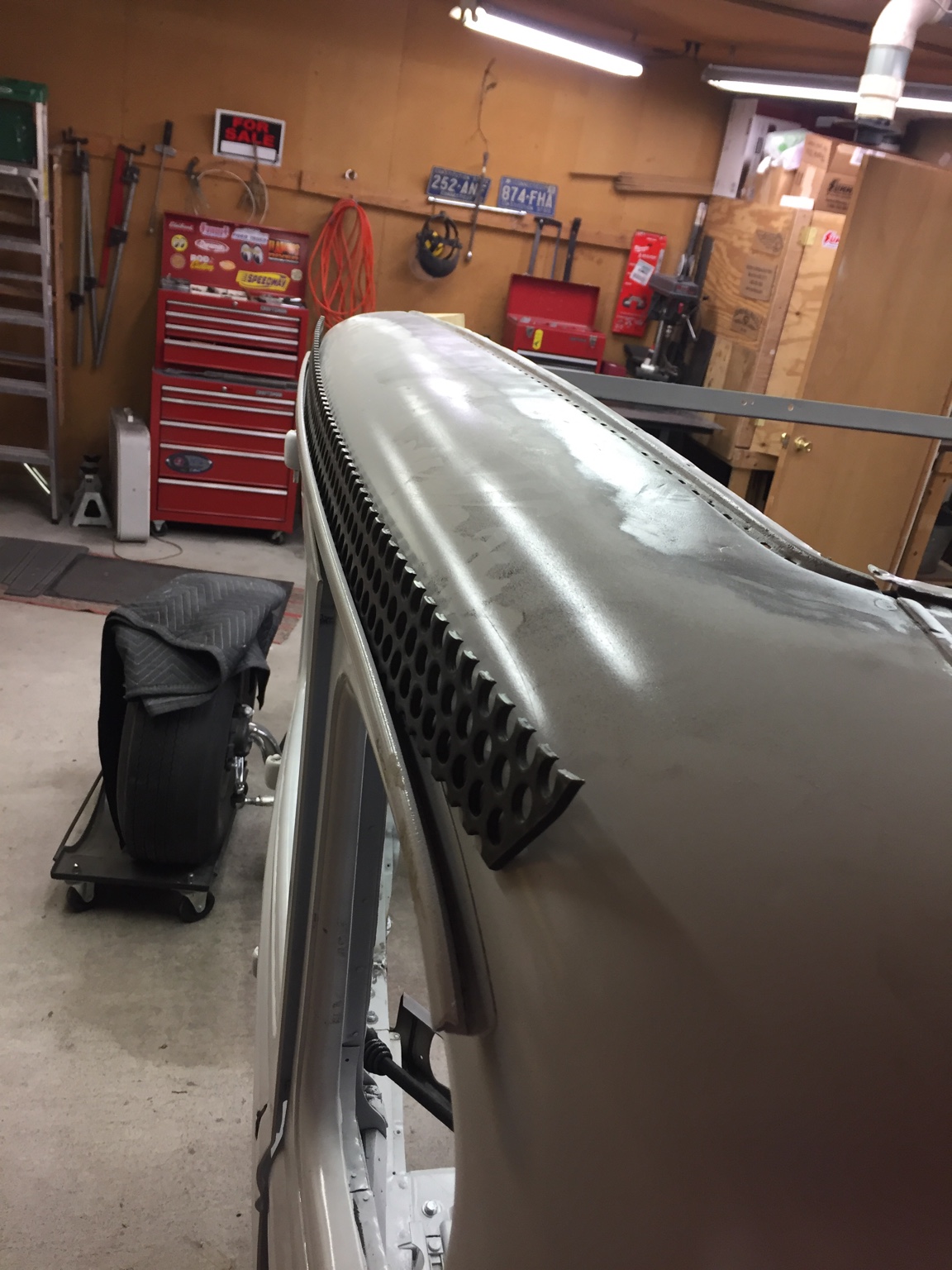

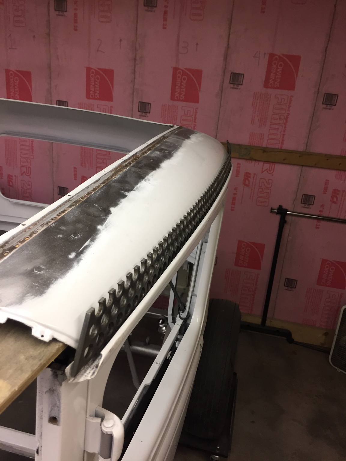

    I'm in the middle of replacing mine.
    Getting there.[​IMG][​IMG][​IMG][​IMG]

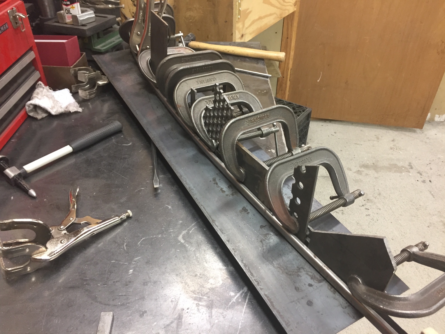

    Used this for something to clamp to.[​IMG]
