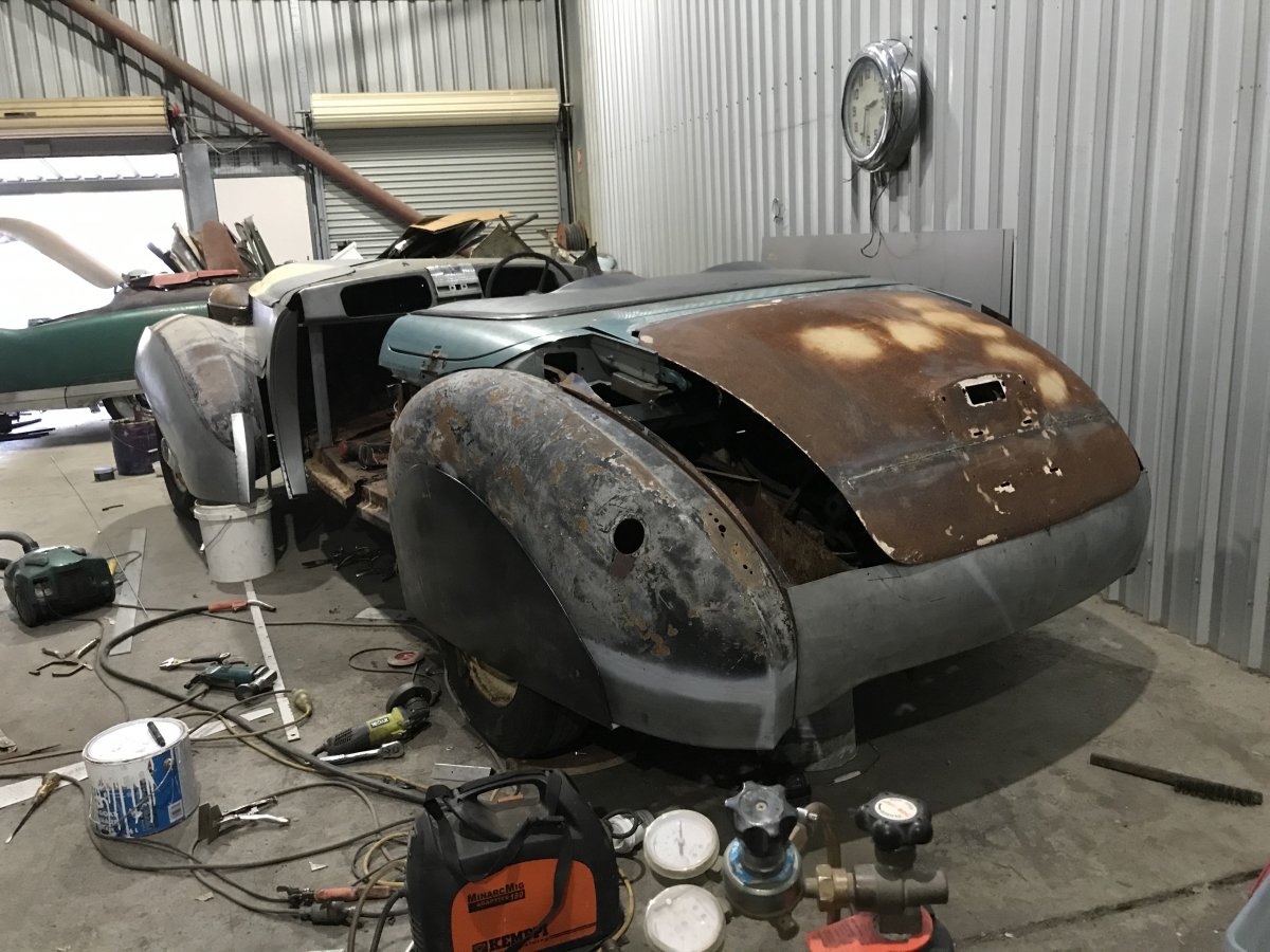

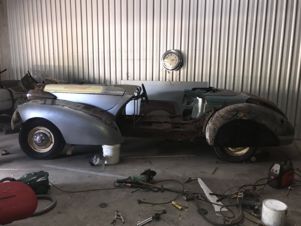

    I’m building this Packard utilising old and new parts . It won’t be a rat rod or a streetrod but I still got kicked off one site for bending the “rules” too far.
    Done well, there are no rules except “ keep a good eye.” 5E0892A0-911F-4E51-84ED-D74204218D06.jpeg 38677E8B-A30A-495B-A891-E3E772FED754.jpeg
