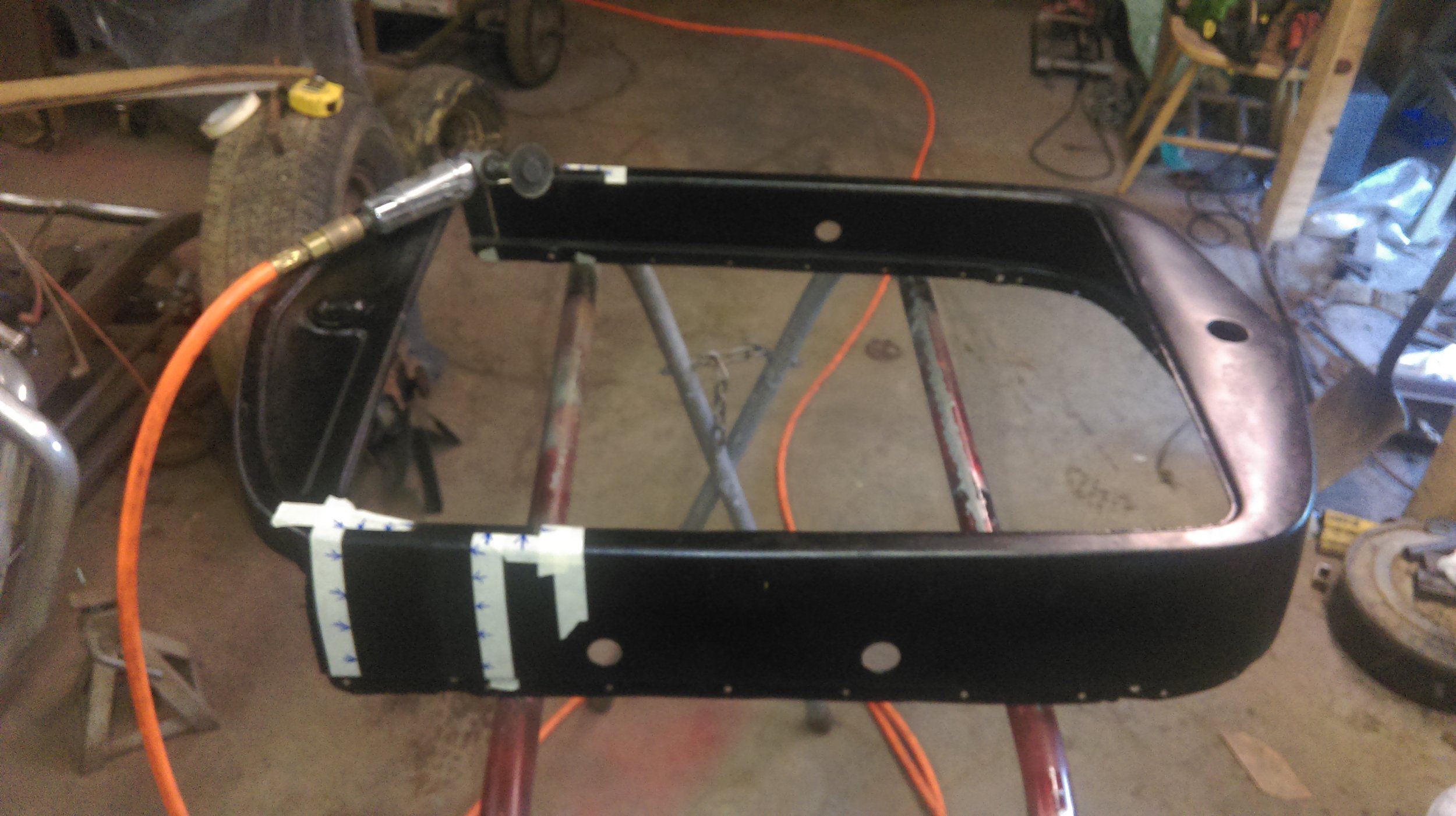

  3. lostone
    Joined: Oct 13, 2013
    Posts: 3,537
    lostone
    from kansas
    Section, I did that to my 31' shell. I like keeping the original lines.
    Although a 31' shell you can see how I did it in the pics.
