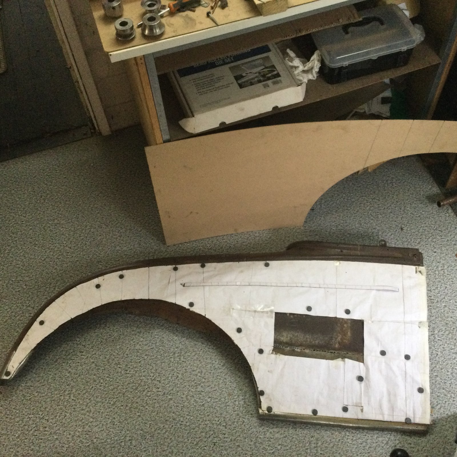

    There is a simple solution and you just mentioned in your opening thread. If you have the front half of the roadster quarter panels and rough coupe quarter panels you should graft one to the other. This is actually quite easy with the right paper patterns. You will need two. One for the roadster quarter and one for the coupe quarter. You use magnets to hold the patterns down and cut out the centre to allow for the crown in the panels, the patterns are reversible so can be used on both sides. When cutting the patterns this should be done between the swages so that the patterns will lock into the quarter panels and not around it.
    anthony myrick likes this.
  4. chev34ute
    Joined: Nov 13, 2011
    Posts: 1,532
    chev34ute
    The next step is to take the take the roadster quarter panels and measure out from the b pillars to make identical cuts on both sides. Once these have been made, place the roadster pattern over the top, secure it with magnets, especially over the cut edge.
    Then get a nail and run it along the edge back and forth until you get an imprint of the cutting line. Then re cut the paper pattern along the imprint.
    This paper pattern is then placed over the coupe paper pattern and slid into place until both are perfectly aligned. The the cut line of the roadster pattern is traced over the coupe paper pattern and the coupe paper pattern is cut accordingly.
    The newly cut coupe patterns are then placed over the coupe quarter panels and marked out for cutting accordingly. Basically you are wanting to **** weld the panels together. I did something similar for the 29 Roadster quarter panel I got last year when I had to make a patch panel up for it. 27102039-3899-458B-85DF-6C033925C66A.png 5A01AFD4-621D-498F-B564-0C5FCE423561.jpeg 5A01AFD4-621D-498F-B564-0C5FCE423561.jpeg

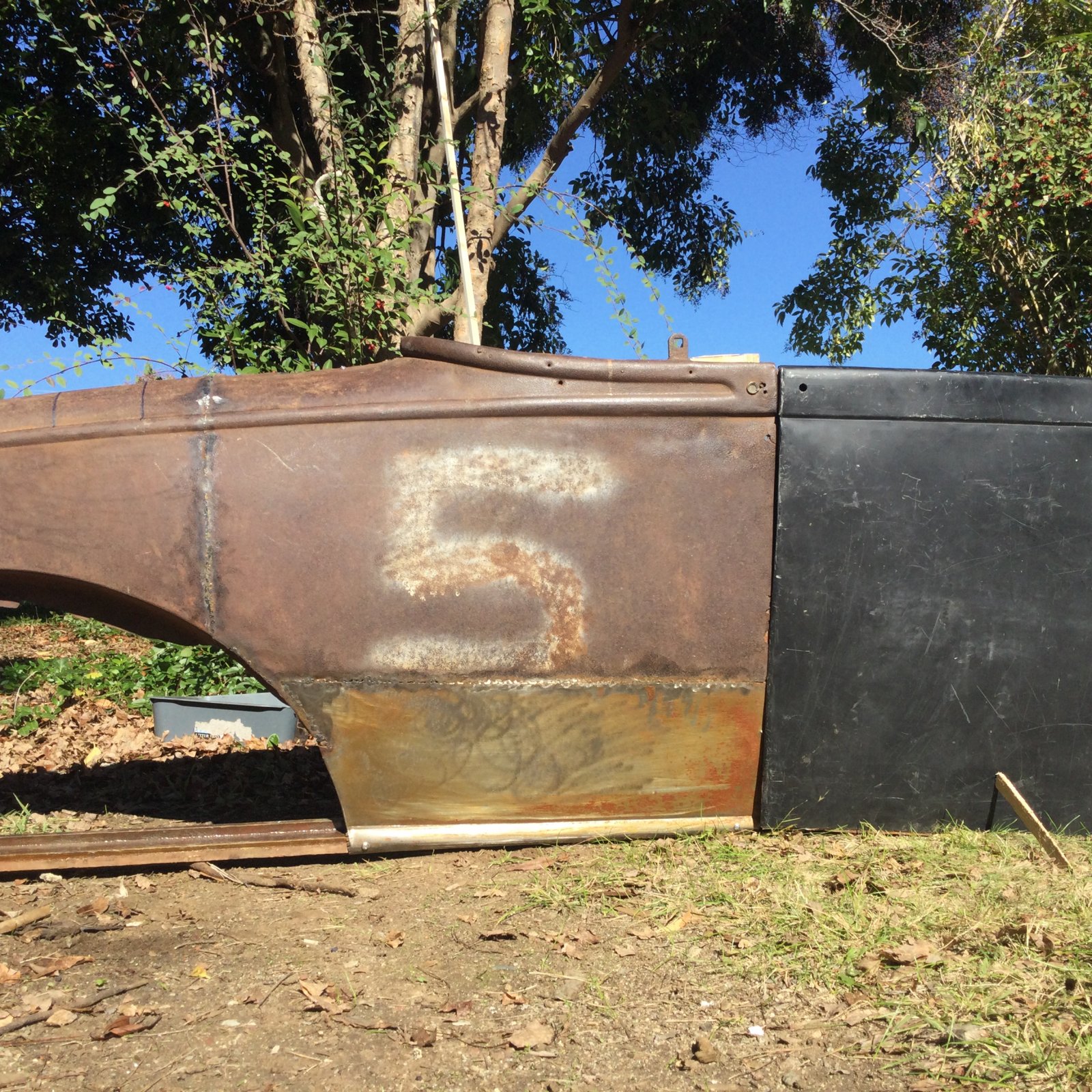

    Here is a shot of my left side. Bob
