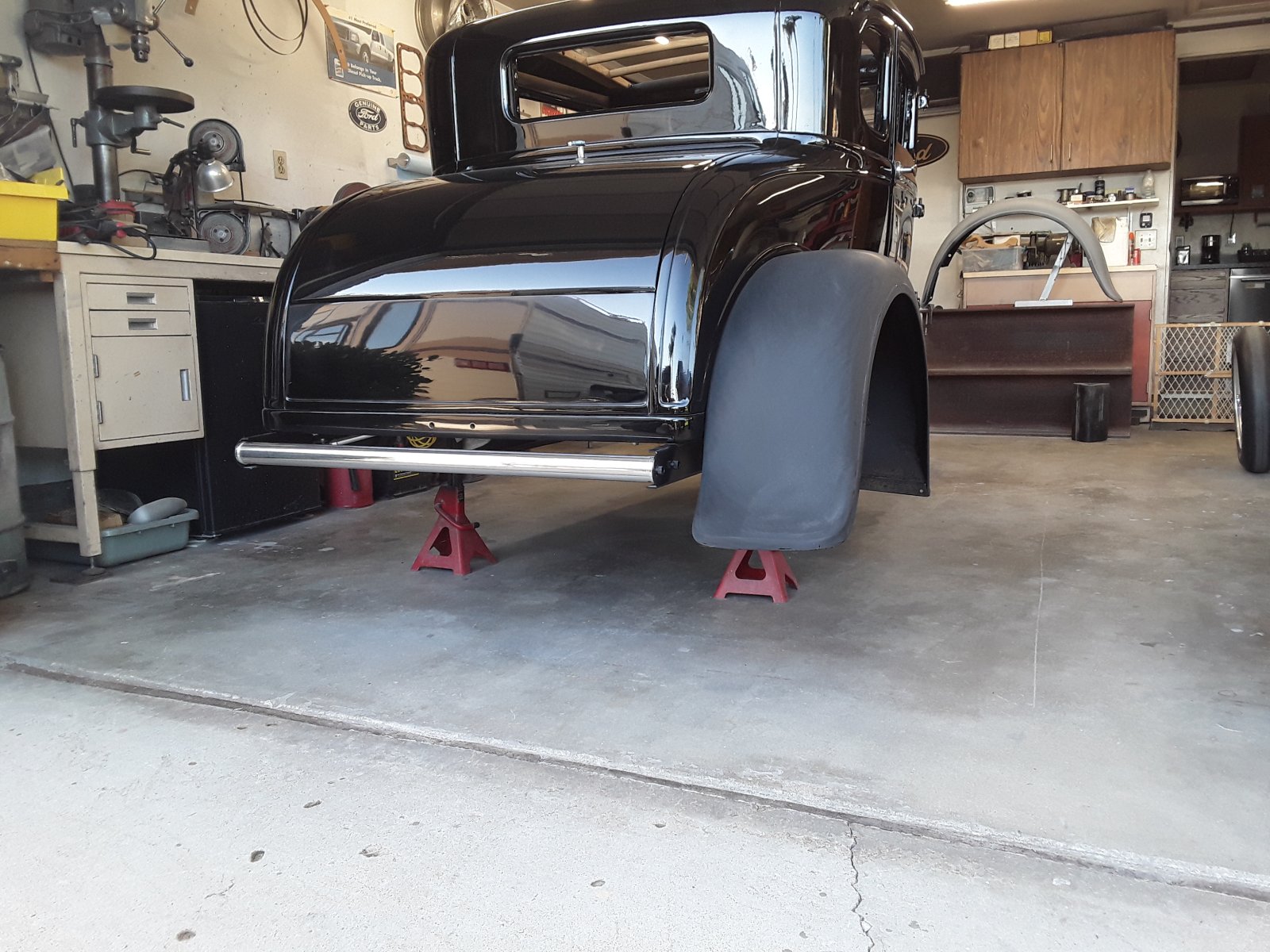

    how far below the rear of the body of the 30/31 does the factory fender go? looks like 7" from pictures?? thanks
  8. A 2 B
    Joined: Dec 2, 2015
    Posts: 576
    A 2 B
    from SW Ontario
    I could only guess but I have a good pic that may help. I have two sets of original stock fenders, unfortunately not mounted on a car and a set of modified fenders on my 30 coupe that mount differently, are tubbed and raised. A 6.jpg
    You are contemplating bobbing the rear fenders. There are numerous example pics on the HAMB to compare.
  9. hurlbird
    Joined: Oct 4, 2016
    Posts: 98
    hurlbird
    wow those look very long . thank you for posting.. ideally id want them a few inches after the body but of course want the factory edge. Hmmm
  10. A 2 B
    Joined: Dec 2, 2015
    Posts: 576
    A 2 B
    from SW Ontario
    That is the original factory built look with the spare tire mount removed. The car sits on 19 inch wires and being raised up on wheel dollies, it accents the length somewhat. I still have that set of fenders and could determine how low they go by measuring from the duo-lite mounting holes.
    Once you have a set in hand you will easily determine where to cut them based on the look you are after.
    hurlbird likes this.
