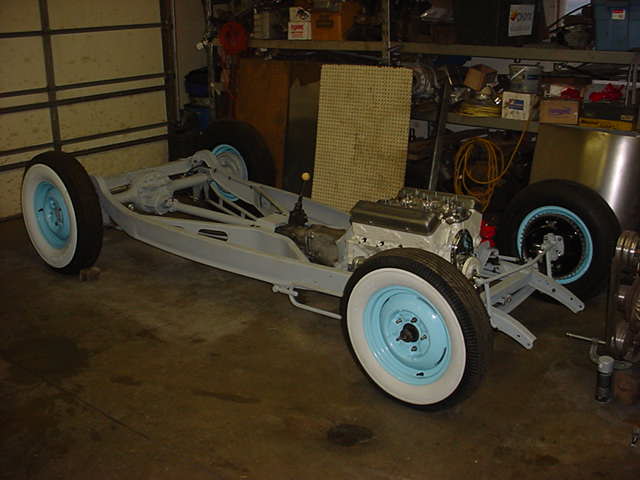

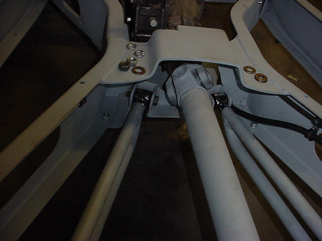

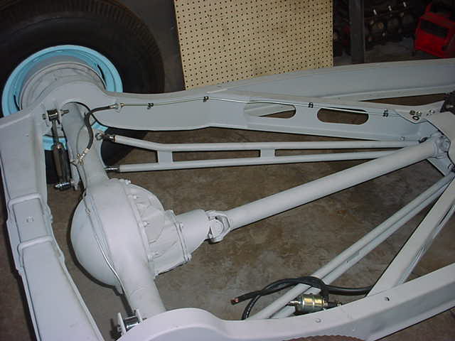

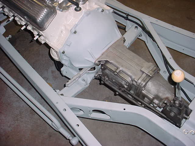

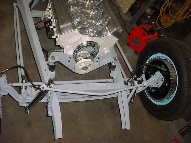

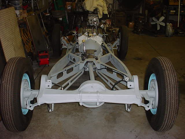

    ill probably get in trouble from Stacie but here are some more pics of the chassis, its just getting put in grey primer till this winter when she is gonna tackle all the paint and body work, so it will come all back apart for that, so that makes the assembly process go a bit faster.
    JEFF

    Did you guys build the driveshaft or have a local shop make it?

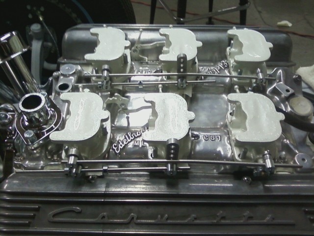

    I cut it to length, ive done about 30 of em so far and counting!
    Got lots more bits done here and there, started working out the carb linkage, started going thru the 6 stromberg 97's that will rest attop the motor, well just be running 2 for a bit till we have more time to sort out and tune the other 4.

  14. nifty
    Joined: Jan 7, 2007
    Posts: 477
    nifty
    from UK
    oofff that rolling chassis looks fantastic, very tidy indeed. As for the motor....damn that's centerfold material

    How did you get away with out notching the Hurst mount? I decided to run an electric fuel pump on my '35 because the mechanical interfered with the mount. Love the motor, it's awesome!!!!

    It clears by a very small amount, but its the aluminum vette type fuel pump and we are using the old jeep style motor mount pads also which has more room for the pump, i thought we were gonna run an electric too but at the last minute i decided to try a good old reliable mechanical.
    jeff

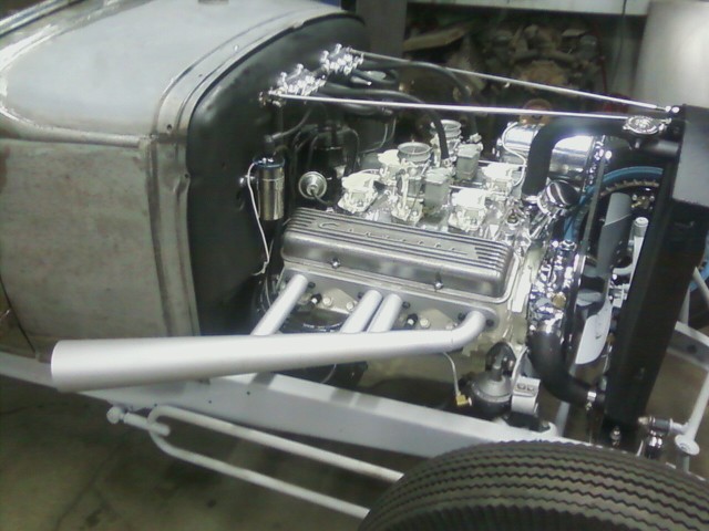

    Gonna try and fire it up today, working on mounting the battery, gas tank and some final bits and pieces and finish rebuilding the 97's.
    JEFF

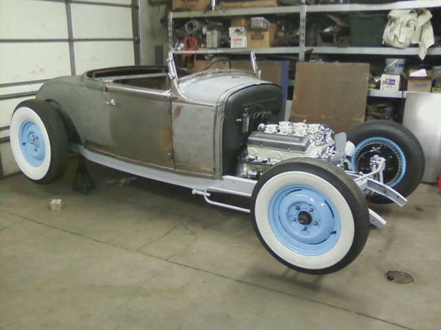

    Is there a slight channel to the body? The rails look visually slimmed and everything looks perfect!!! You definitely do awesome work Jeff. Oh and thanks for the info on the pump clearance. I am using the flathead biscuit type mounts along with the HURST mount, spacers., u shaped spacers and AD-75 anti chatter brackets.

    a bit more progress, got it fired up, we have to break in the motor still, so we basically fired it up, set the timing and the dwell for the few seconds we had it running, then well try and break here in tomorrow, it got a bit late to be running it.
    Got it wired enought to run and charge, have to wire the lights etc etc, bolt in the seat, bolt on the steering wheel, mock up the 4 dummy carbs (yeah yeah yeah) get a new master cause the new one is bad, and some other little bits here and there.
    JEFF

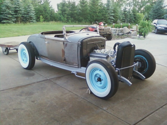

    Just reread this thread after I noticed the chassis. Will the tops of the rear tires be above the rear wheel wells? I like the kicked up rails, but want to center the tires in the wells on my '30. Can you post some side shots once it hits the ground? Great build so far!

    Seems like at ride height they will match the radius of the wheel wells percectly, with some tuning via leaf springs it could be a touch lower but she likes where its sitting, we will get some profice shots for ya.
