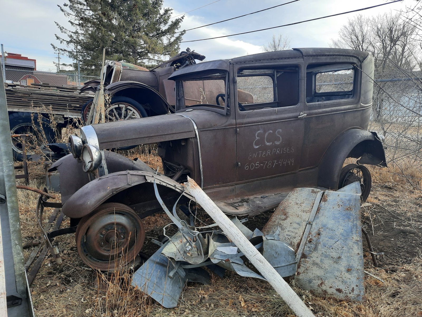

    I've been wanting another project car for awhile now that my Rambler is on the road. I've been checking online listing, talking to guy in my car club, and driving down backroads looking for something that catches my eye. The other day I was helping my Grandpop with some stuff at his shop and I asked him about the 1930 Ford Sedan he's had sitting along the fence side for years (probably sitting there for longer than I've been alive if I had to guess) He wouldn't give me a price, instead saying I could consider it mine. So I guess I have a 1930 sedan project, which has got me excited. However there won't be much progress on this project for awhile since I'm starting welding school in a few days, that with a full time job won't give me much time to work on anything. (Plus school cost me a good chunk of $$$)
    Still won't stop me from planning!
    1. Need a ***le
    2. The fenders on this sedan are toast, so I'm on the lookout for better fenders, I did consider going fenderless but I think sedans look weird without em. Want to run a full closed hood as well I think.
    3. I'm aware of a few sbc engines sitting around on a local property and I've talked to the guy who owns em about taking a closer look and possibly getting one of em, not sure. There's also a gmc 371 my dad has, maybe I can save up some $$$ and get that. Not sure
    4. I'm going to want to put in a 9" ford rear end this time. My Rambler has an 8" and getting gear sets for that has proven to be rather annoying.
    5. Definitely want to chop it a bit. Edit: no i dont. I kind of want it to stay looking as it does now, just freshened up a bit.

  2. If you was closer I'd give you a set of 29 sedan fenders! Love the project, I used to be a model A nut :D

    Thanks for the kind words! I didn't know 29s would fit, this is my first real experience with this old stuff, despite growing up around it. Is there any other years besides 29 and 30 thatd fit?

  7. '28/'29 aren't a direct bolt on.... there is a difference in splash aprons that has to be worked around, but IMHO the '28/'29 are a better looking fender and worth the effort.
    OFT, Just Gary, X-cpe and 3 others like this.
  8. I like your plans! DEFINITELY get the ***le paperwork going... since you're getting it from your Grandpop he can be a big help to you with do***entation. That will be enough of a project while you are going to welding school (glad to hear you are doing that and good luck to you).Fenders are a must IMHO!

    I've started working towards getting a ***le, just need to grab the vin off the frame. Definitely want fenders on a sedan.
