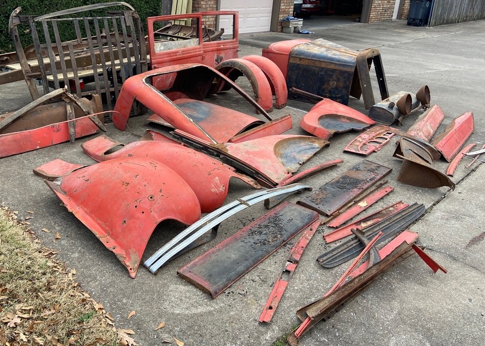

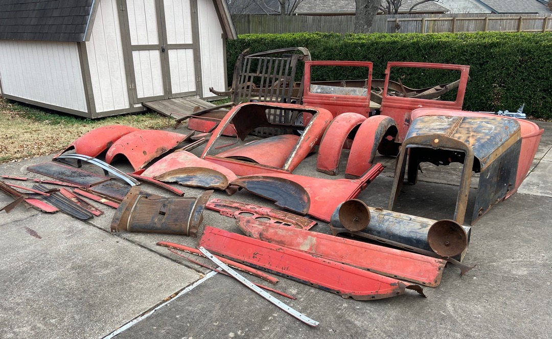

    Just picked up a trailer full of parts alleged to be a 1930 3-window Chevy coupe. Has a good Oklahoma ***le to that effect, at least. Lots of rotten wood but some surprisingly good metal. I'm not sure how it's going to end up, but I would like to keep it fairly original on the outside while modern underneath.
    I haven't settled on anything yet. I'm really fond of turbo 4-cylinders but I know LS v8's are the current hot trend. It came with a straight six originally, and the late-model Chevy straight sixes look interesting.
    I work slow and figure this should keep me occupied for a couple of years. It's a huge puzzle and will take a while to figure out which piece goes where and what pieces are missing...

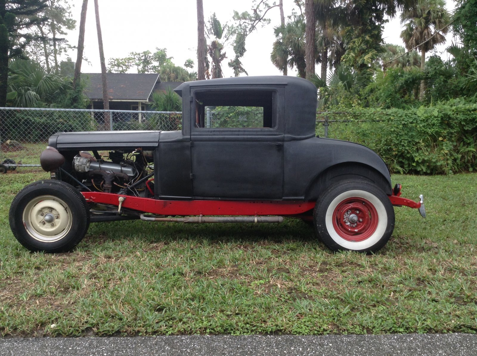

    At least its got shape . When I received my 30 chevy 3 window, it was all rolled up andin 50 gal drums . No piece , except doors , were any larger than what could be rolled up and shoved in the oil drum . This is it on a 34 ford frame . Ive been driving it for almost 20 yrs . ED9F9AE9-1D19-472A-AB46-C045DFD882D9.jpeg DEA34E7B-1E92-4AAD-A263-75B7DA52C246.jpeg

    Metal , no wood . Its one of the most solid riding 30 era cars I have . I was going to install on a custom ( home made ) until the running 1934 ford frame rolled into the shop .
    I can see now where some rusted pieces I had should have gone . I had to use the English wheel and bead roller to fill in the empty pieces of my puzzle . I didnt have a computer then and the only pics I had were in the library . Come to think of it , it was closer to 30 yrs ago .
    One of these days I want to install the body on the frame I made and get a 34 fibergl*** body on the ford frame . But ....too many projects

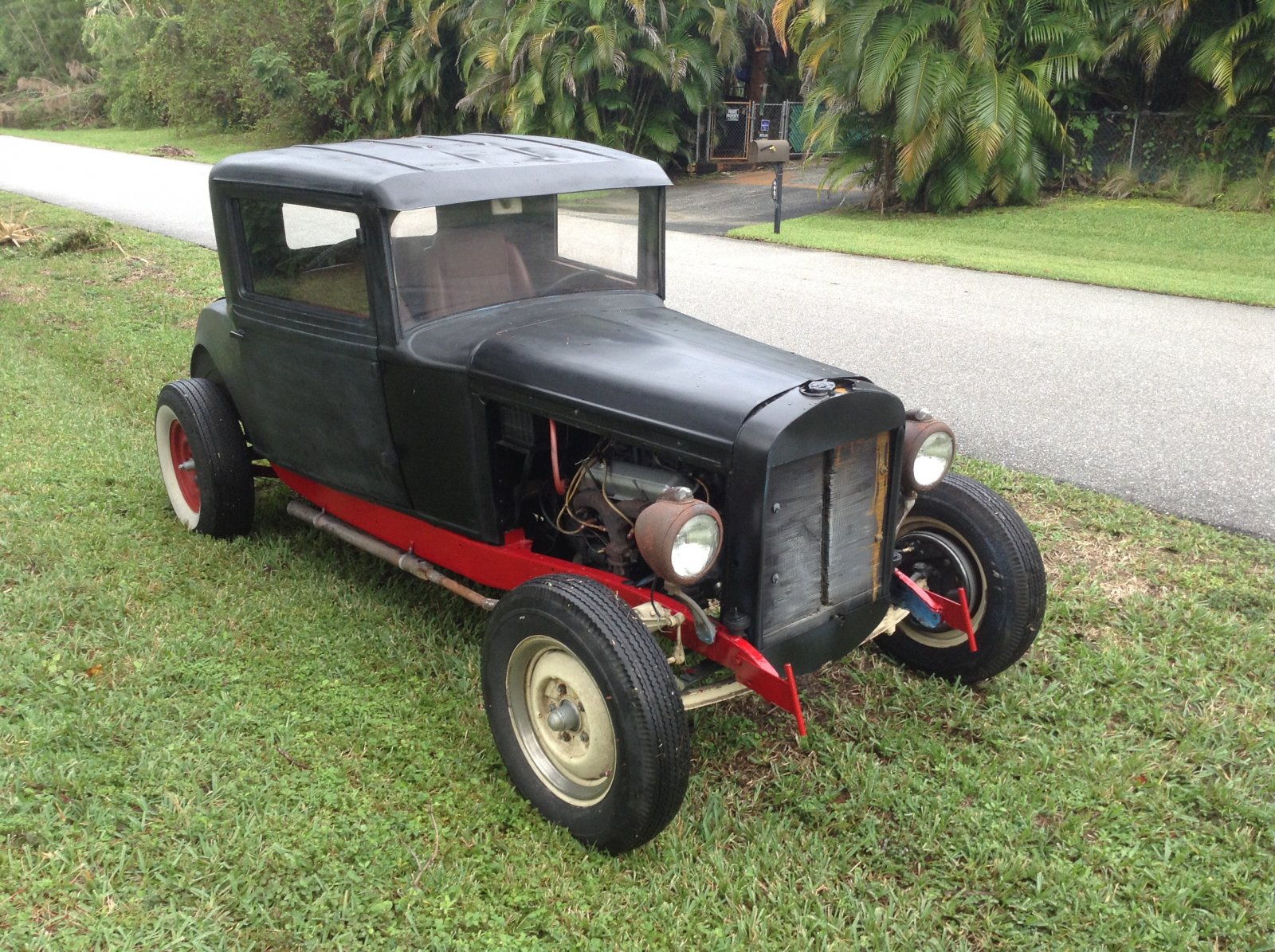

    I’m kind of partial to the Chevys of the 30’s
    I bought mine in the same condition as yours.
    Strange that these don’t really rot like tge fords,,,rather the wood rots and falls out

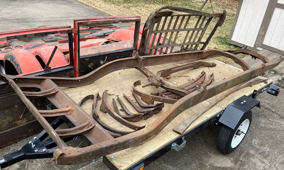

    Started cleaning up the frame. Sadly quite a bit of pitting along the top of the frame on both sides. Otherwise very solid. My first thought is to cut out the worst sections and weld in new material, then add some reinforcement elsewhere. I'm not planning a high horsepower car, but certainly more than the original.

    Just box it . It’ll be much stronger. Once cutting the original channel, it can get out of square easy with just the heat of welding . Make a jig to keep things square , even when boxing .
