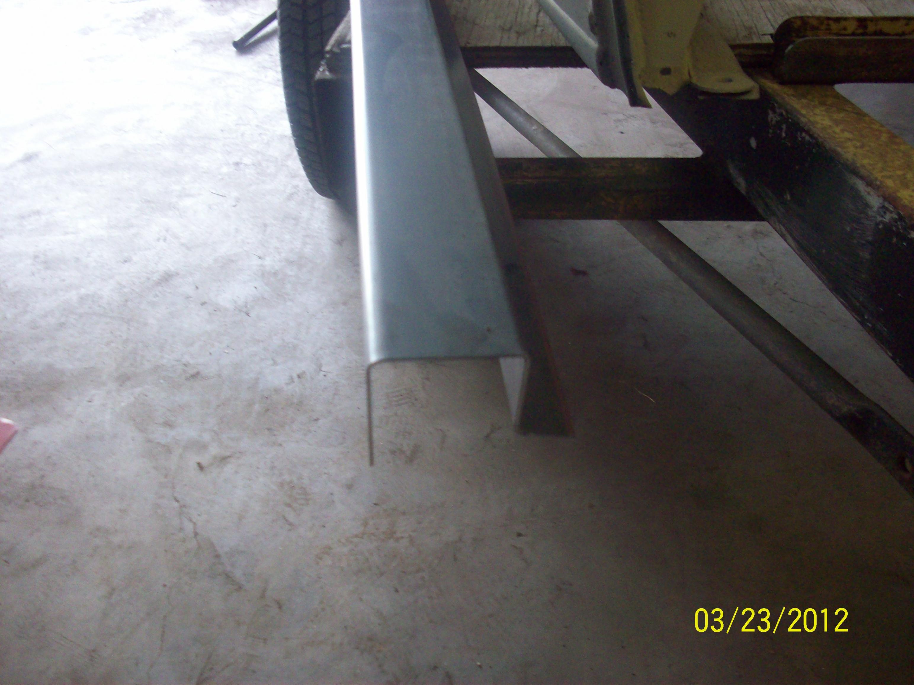

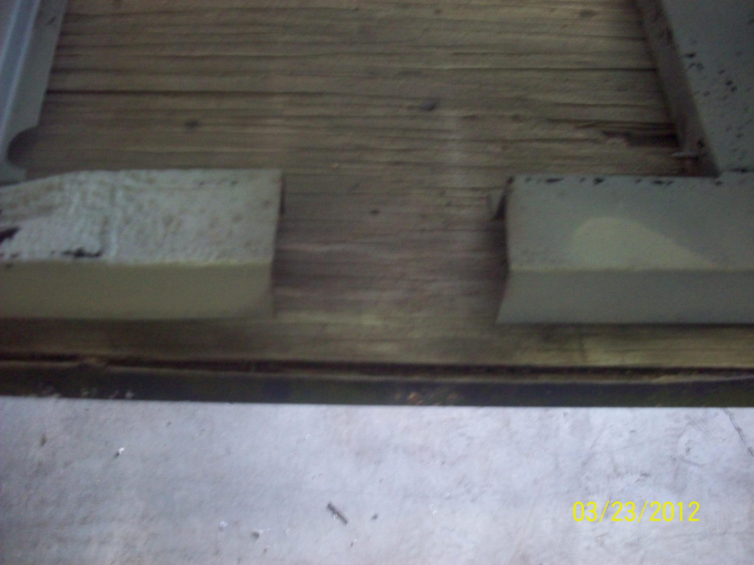

    so, rear subframe rails need some attention as you can see, I just cut out a pattern section and run it down to our local heat and air place,(Teagues) they broke 8 feet in 18ga for cheap, exact match...;)

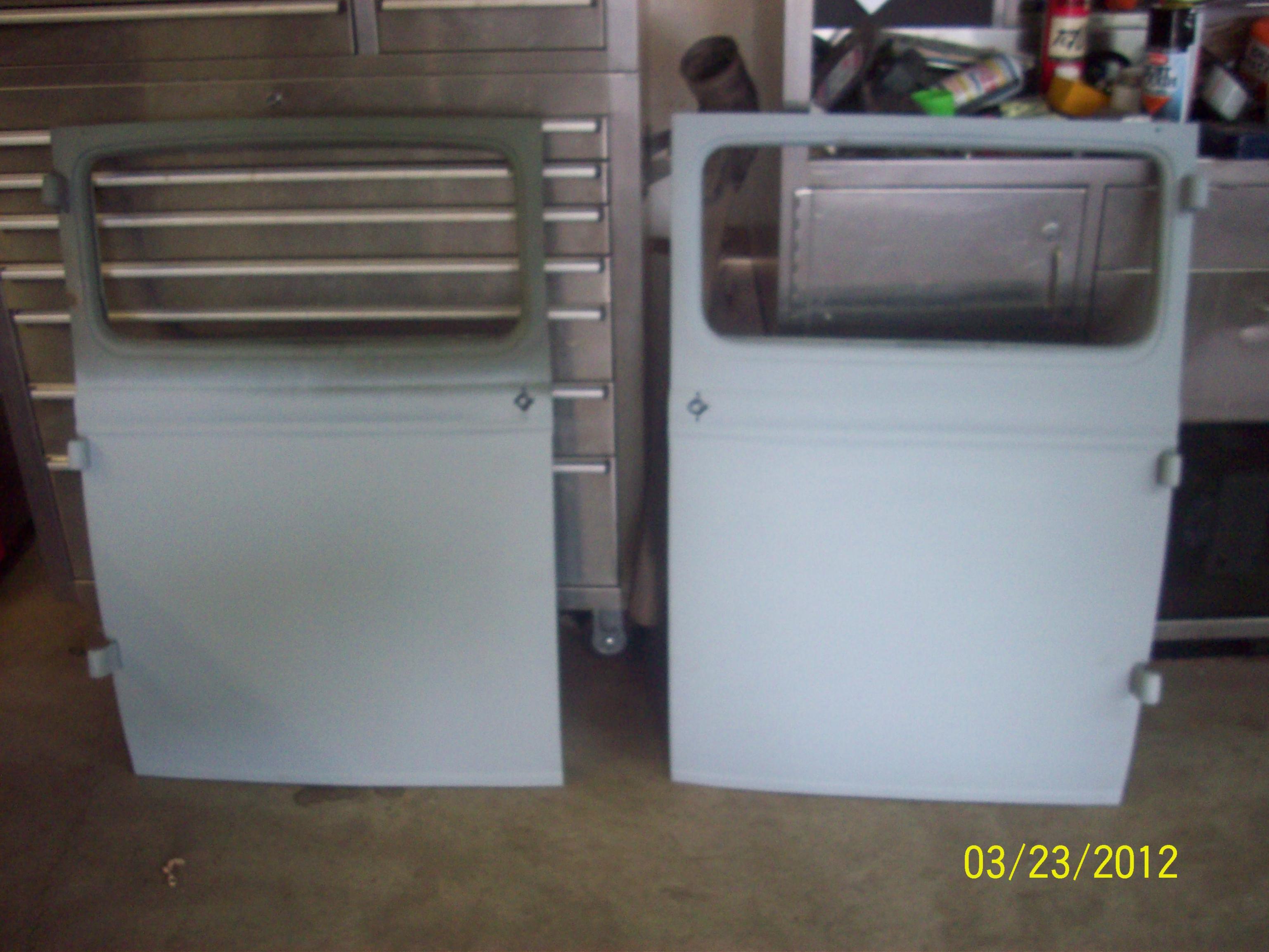

    you can see the warpage in this pic, skins cut out, inside blasted re skinned....

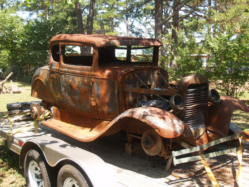

    so as we got to finding and cutting out rust the pile finally stopped growing....and this aint all of it...:D

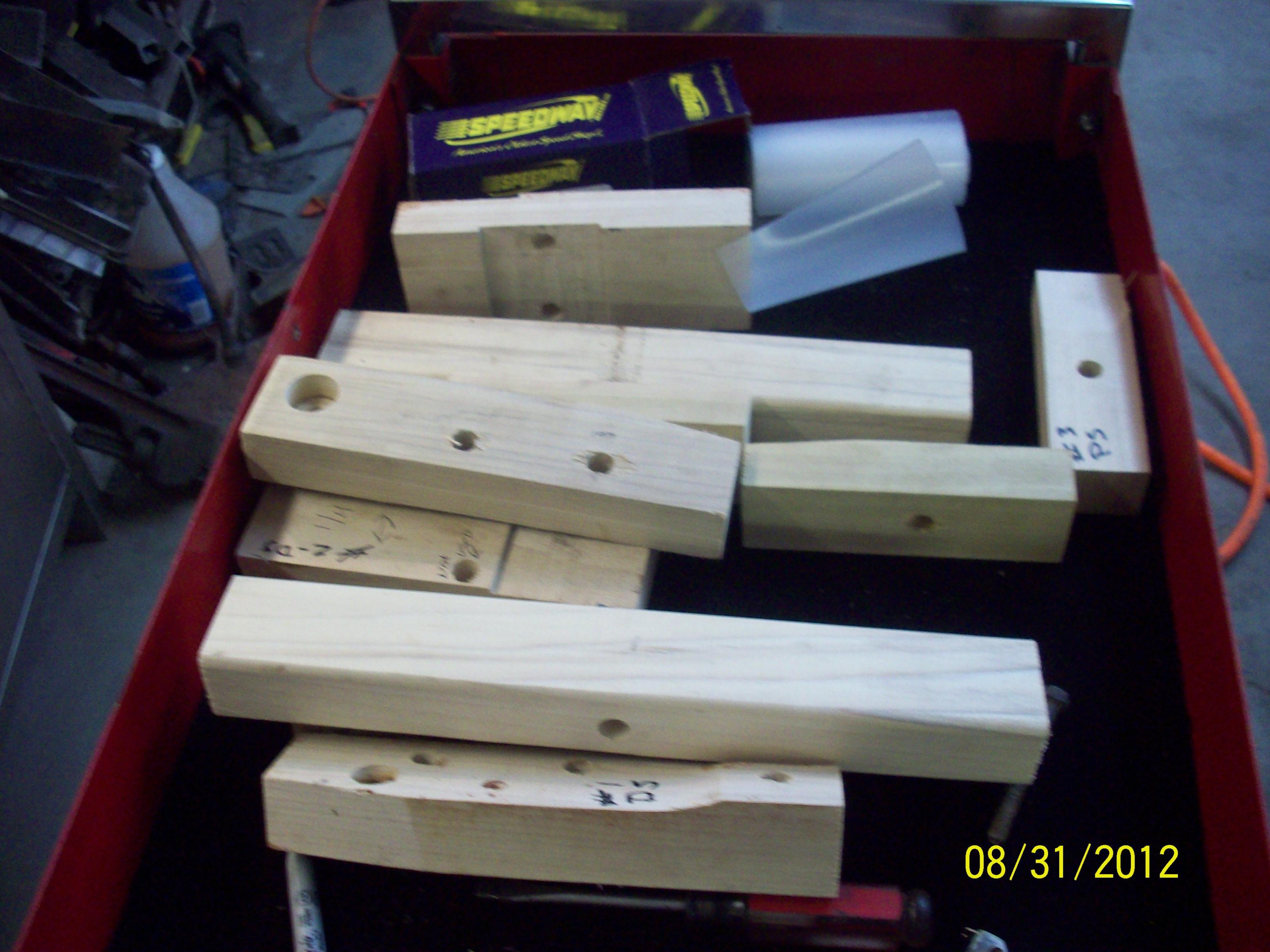

    Got the subrails under control, got the body blocks, going to use a roll of speedway spring liner to insulate the blocks from the metal, should be able to mount and square up the body this weekend.:D

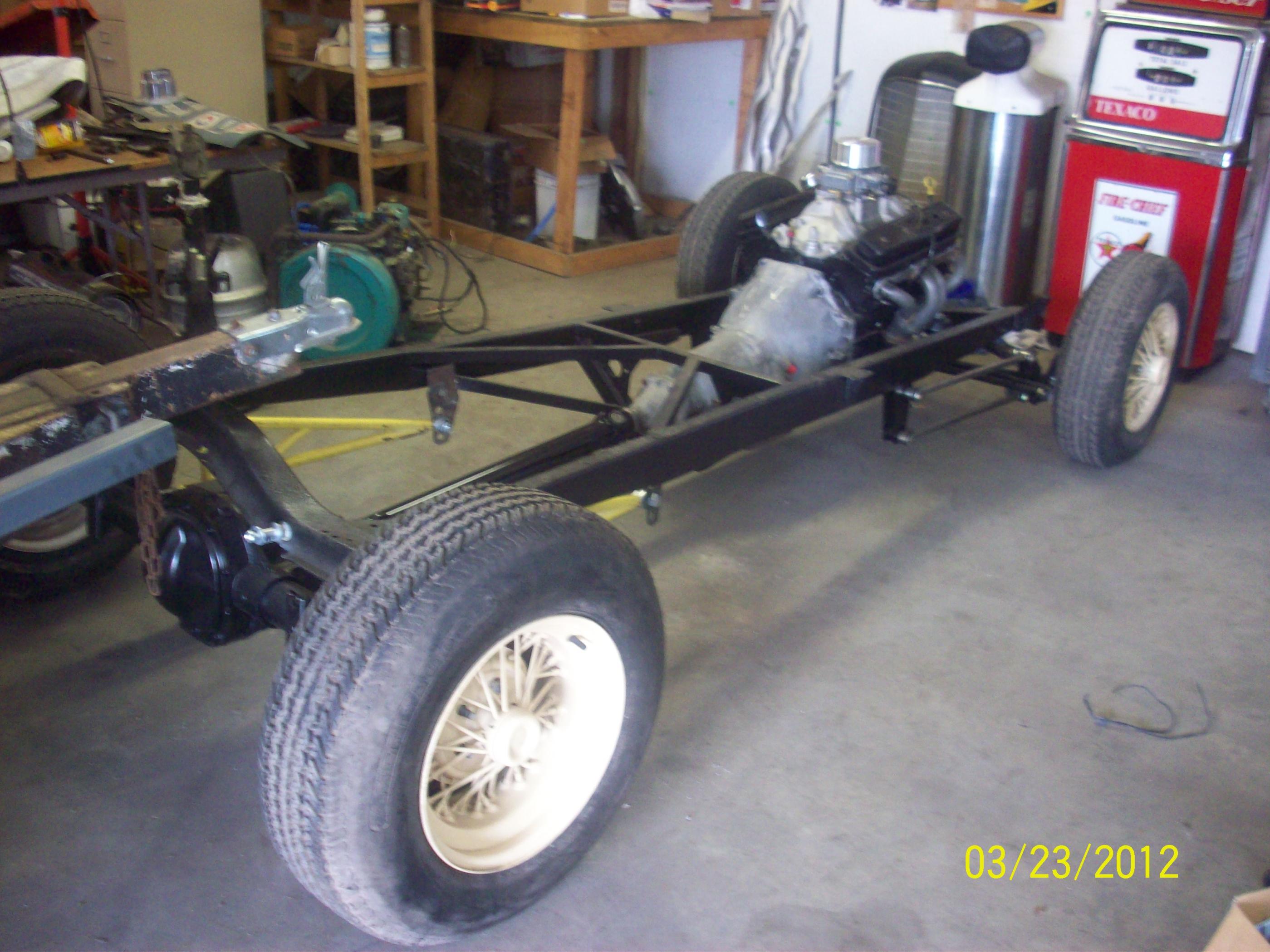

    Glad you were able to bring it back to life. Will the drive shaft offset shown in Post# 36 cause problems?

    No, that offset is pretty common. U joints will take that offset up and will actually make them "work".

    The drive shaft off set is fine, the rotating shaft dosnt care if it spins left right or up and down as long as you maintain an agle sufficient enough to allow the universial joint to rotate correctly,
