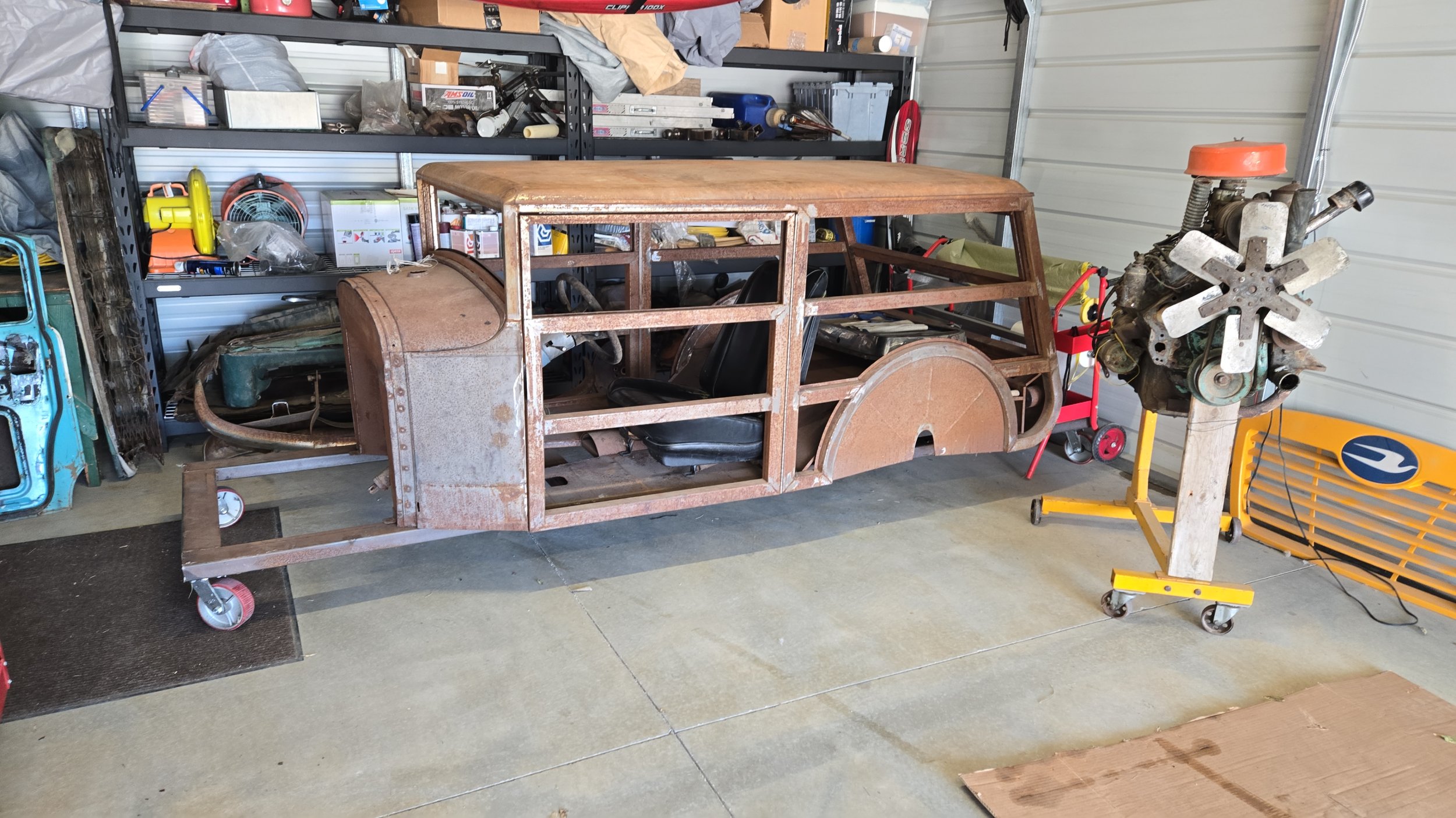

    I am new to the early ford scene but I have always been interested in it. I was fortunate enough to pick me up a 30 model a custom woodie built by a local here but unfinished. With said purchase I also scored a 8ba and an aod transmission and the adapter kit. (I am not sure how i feel about an automatic here) and all 1939 running gear. Banjo axle and spindles all around as well as split wishbones, the front axle is a good 4 inch dropped axle, king pins are already done and o have reverse eye springs all made up. And ready to go. The only problem is I have no experience with flattys (i do know this one to be a runner) and I have a 392 hemi stacked on the shelf as well that kinda begs to go in this car. Any 2 cents here? How does anyone like their flatty with an auto? Any way to get an easy read on the condition of the inside of this flatty?

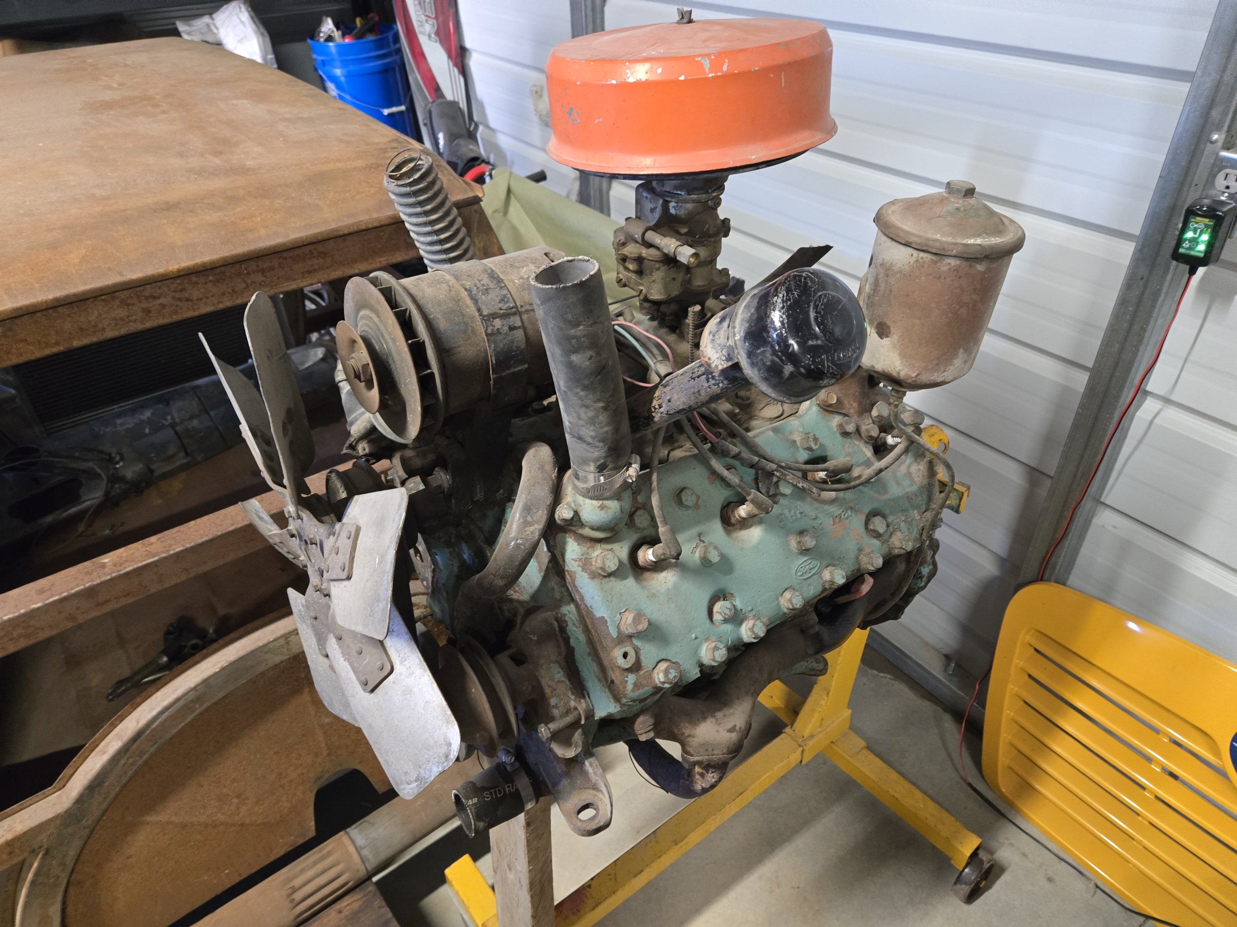

    I like the flathead, taking it apart is the only proper way to check it out, get it running and you will get a fill if it's usable as is.
    I like the hemi also but they cost a arm & leg to rebuild. HRP

    I have noticed that when looking at rebuild parts and mine unfortunately has one bore with a pretty nasty scar

    I'm not a flathead fan, so that would be a really easy discussion for me. if it runs, it should be easy to sell.
    With a 392 Hemi you want to install, the flathead drive train will not hold up well. You will likely need a different drive train if you intend to use the Hemi. I'd sell the rest of the Ford drive train to the guy that buys the motor.
    The Hemi conjures up an entirely different version of the woody then the flathead version is. Which vision do you have? Its not my car...
    I also doubt the flathead guys will agree with me, and would tell you to use the flathead.
    Looks like a pretty cool project, we expect a build thread, which ever direction you go.

    A sleeve in the one nasty bore could solve that problem, but even a run of the mill freshening up is expensive with the Hemi. Its easy to spend other people's money. The whole project looks like an expensive project to me.

    Thats the thing, the body is decidedly more 60s hot rod than 50s all curvy and styled. And that opens me up to more era stuff like 9 inch ford rear ends and such that would be a much better choice behind that hemi. Plus the fun of the hemi power. But its just a stock model a frame. Not even boxed. I would at least want to do that. Probably not something I want to run the buggy style springs with either

    The elephant in the room for me is that woodie body. I kind of feel like I’m kicking somebody’s puppy but let’s step back a bit.
    I think it’s overbuilt but not in a good way. How much is that joker going to weigh skinned and gl***ed? How are you going to skin and gl*** it?
    (I mean glaze or put windows in)
    It seems overbuilt but it may not have near the structure and strength you think it would have. In other words, I question the engineering.
    That body looks like a nightmare to me.
    If you decide to use the “woodie” body, forget the flathead. You’ll need an OHV.
  21. CJ95
    Joined: Oct 12, 2025
    Posts: 59
    CJ95
    Well I guess I bought it for looks. It is braced well but luckily the tubing isn't super heavy. Its structured well though

    Its not as heavy as it looks and its smartly braced but definitely outweighs a traditional hot rod. With some reading I have found i am definitely not building a traditional hot rod here. But more of a 60s custom.
  23. CJ95
    Posts: 59
    CJ95
    Shouldn't weigh much more than a tudor body. The "cage
    Really shouldn't weigh but 50 or 60 pounds more than a tudor body. The "cage" is just 18 guage tube. Amd has no more glads than a tudor. It shouldn't be bad i dont think. But your right more custom than traditional. I am new to the hamb forum. Wasn't sure where to place this post
