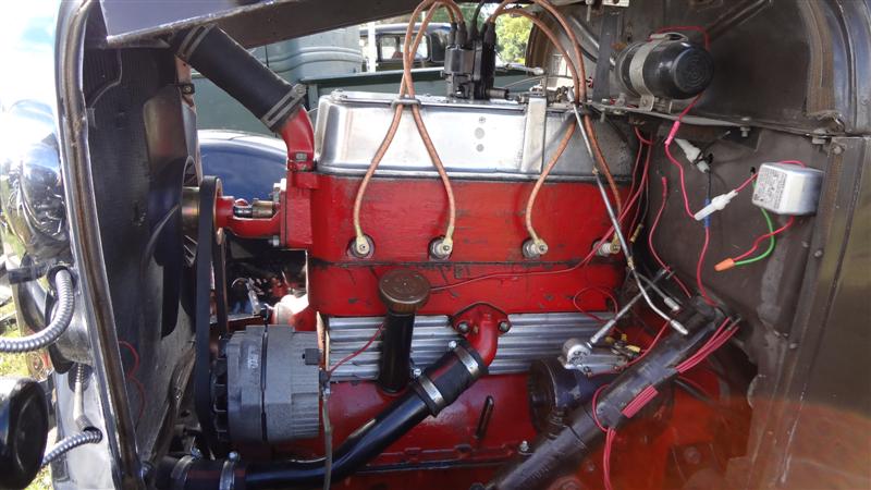

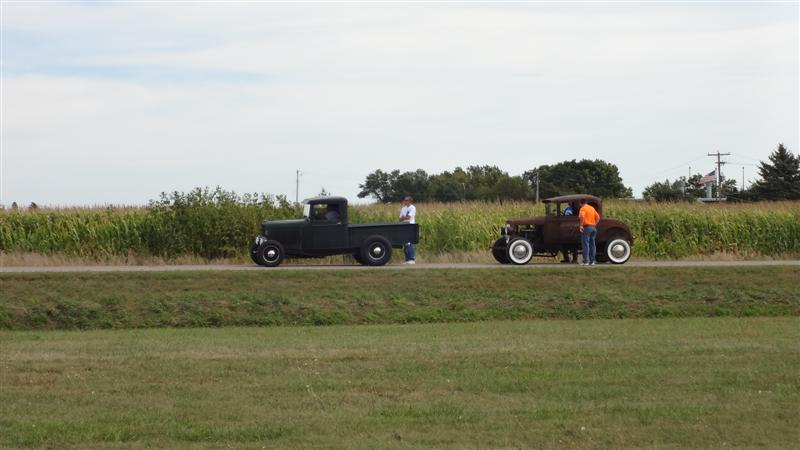

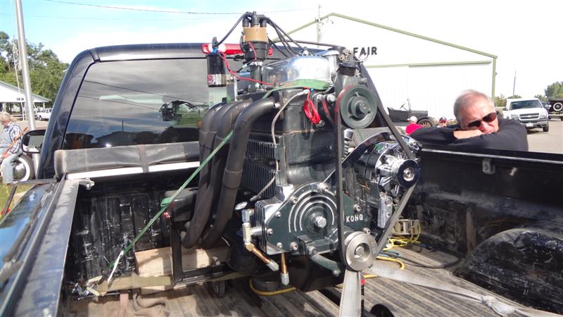

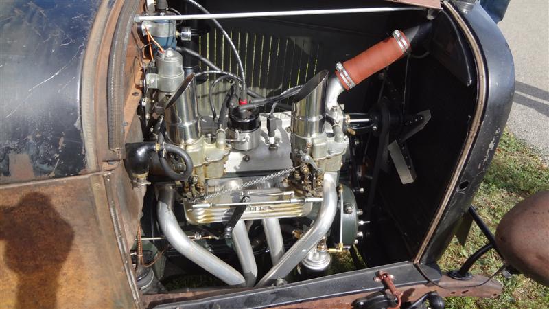

    Northwood 2013 008 (Medium).jpg Some random pictures from the F.A.S.T. Flat Hill Climb, Northwood Iowa 14 Sept 2013. Gary in MN.

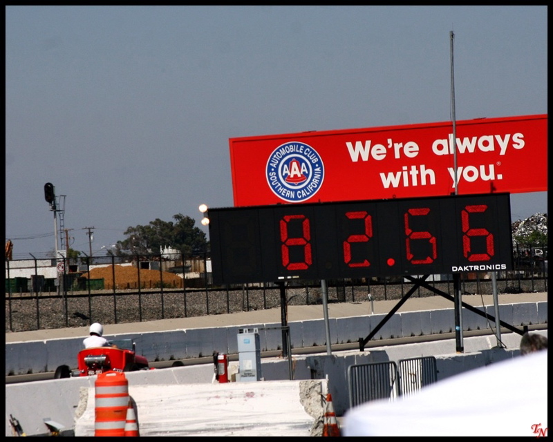

  14. This works for me. Second photo shows how well it worked

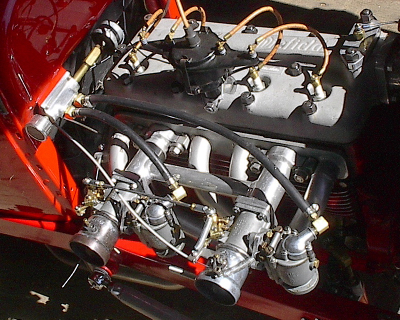

    Bill, have you posted anything about your intake manifold? I did some searching and found that you modified downdrafts to side drafts but didn't find anything about the manifold.

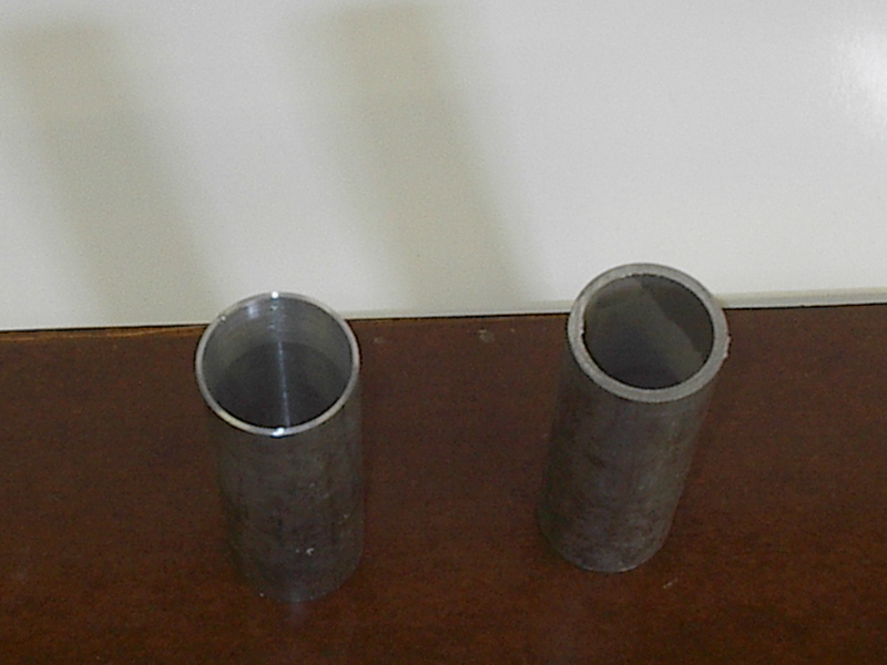

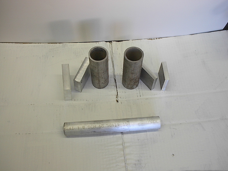

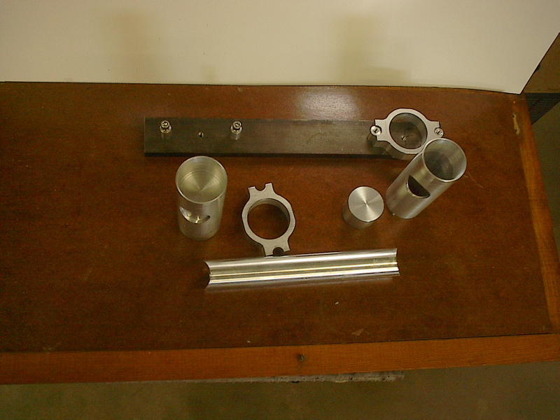

  16. All i could find ! The first is s**** from around the shop, second is a finished tube, third is pieces going to welder, finished product is in earlier post. The balance tube is radiused on ends and I put a short piece of material in tubes before they were welded to hold location. surfaces were trued after welding.

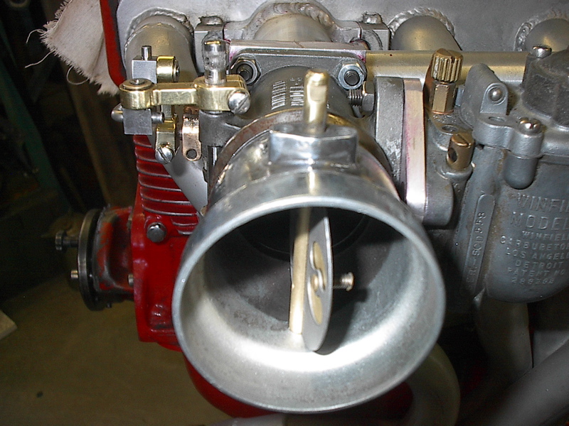

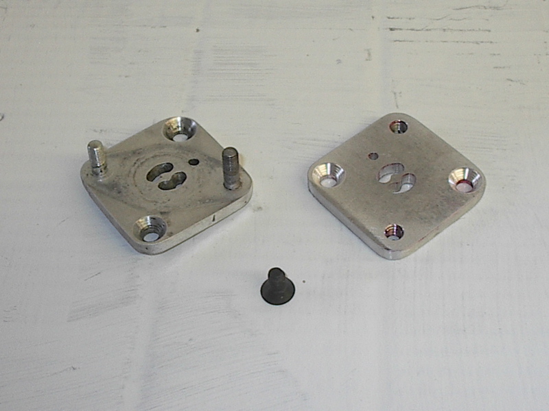

  17. More side draft stuff, First is the adapters, one on left was first attempt, cut with Dremel and better part of 6 pack of Coors light, one on right was cut on rotary table on my Bridgeport. Gasket die to cut gaskets as those currently available are a bit lacy. Third photo shows adapter in place.

    Thanks Bill! Can you educate me on why a balance tube versus a plenum? Also, how did you pick the diameter of the balance tube - using the That Looks About Right or did you use a formula?
  19. Cheers Juggler! 77.7mph on sand it seems. First run at 71, third run at 73.
  20. I just used what I had available. I don't think diameter is too critical to the average hot rodder but it probably is to those who don't do but just think and criticize. Not sure but first example that was referenced was Roof in US and he found it smoothed operation on race car engines. This I read in S O S S. Notice how large the dual downdraft manifold balance tubes are. I once made some balance tube fittings for use on Susuki MC's that were only maybe for 3/8" tube these were used on quad (4) carb settups.
