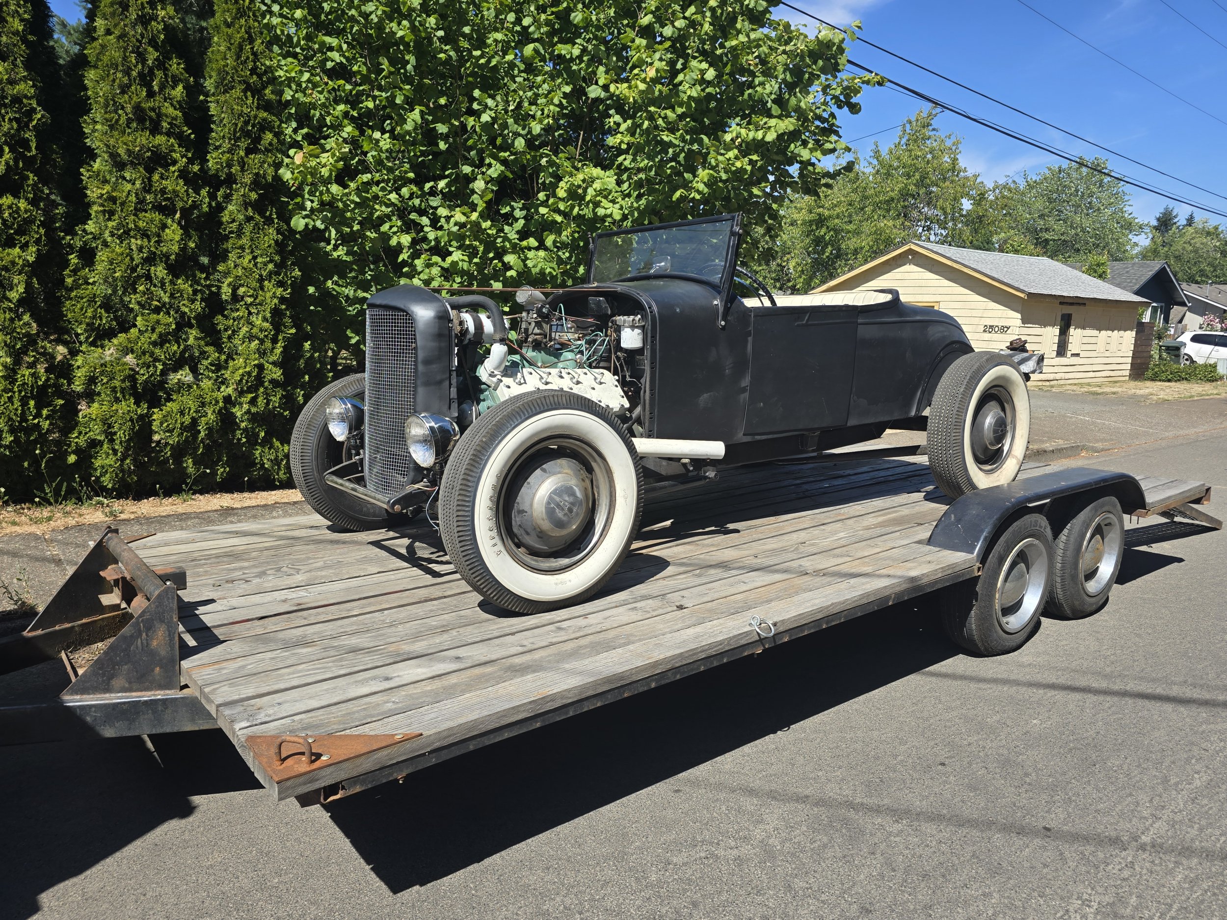

    Ive been building something like this the last few yrs and got it on the road this year. I have less than 2k into it. 20250718_154401.jpg 20250718_134451.jpg
    I am by no means an expert on anything but I will give you a cpl cents of free advice from where I'm sittin. First, tack or screw as much as you can together while frequently measuring to make the body look good. I had to remove my drivers rear quarter and reset it 3 times before it was right and I wished I had taken more time earlier on to do allll the figuring. Next, for running gear, keep it simple! Just stick with some ford stuff, its cheap and easy to find, easy to rebuild, easy to align and wont tank your budget. I check marketplace all day everyday and when I find the right part, if I dont like the price I ask em if theyre open to trades! Be patient.... the right parts will fall into your lap and you have PLENTY of work to do til they come. The last thing I'll tell you is before you start making inner structure and all of that, wire wheel everything inside and spray bomb some primer on it, you will thank me later, I just mean on the inside in the hard to reach areas. Once the body is in its final shape, set it on a sheet of plywood, trace the inside bottom in marker and cut it out, then set that plywood on your frame, use it as a template and build your floors and do a good job bracing, then set the body on and attach THEN build your inner structure and attach, doing it in this order will make it smooth and keep in mind rear axle location to rear wheel well, engine to firewall, trans hump etc. Its a cool build man! Subscribed!

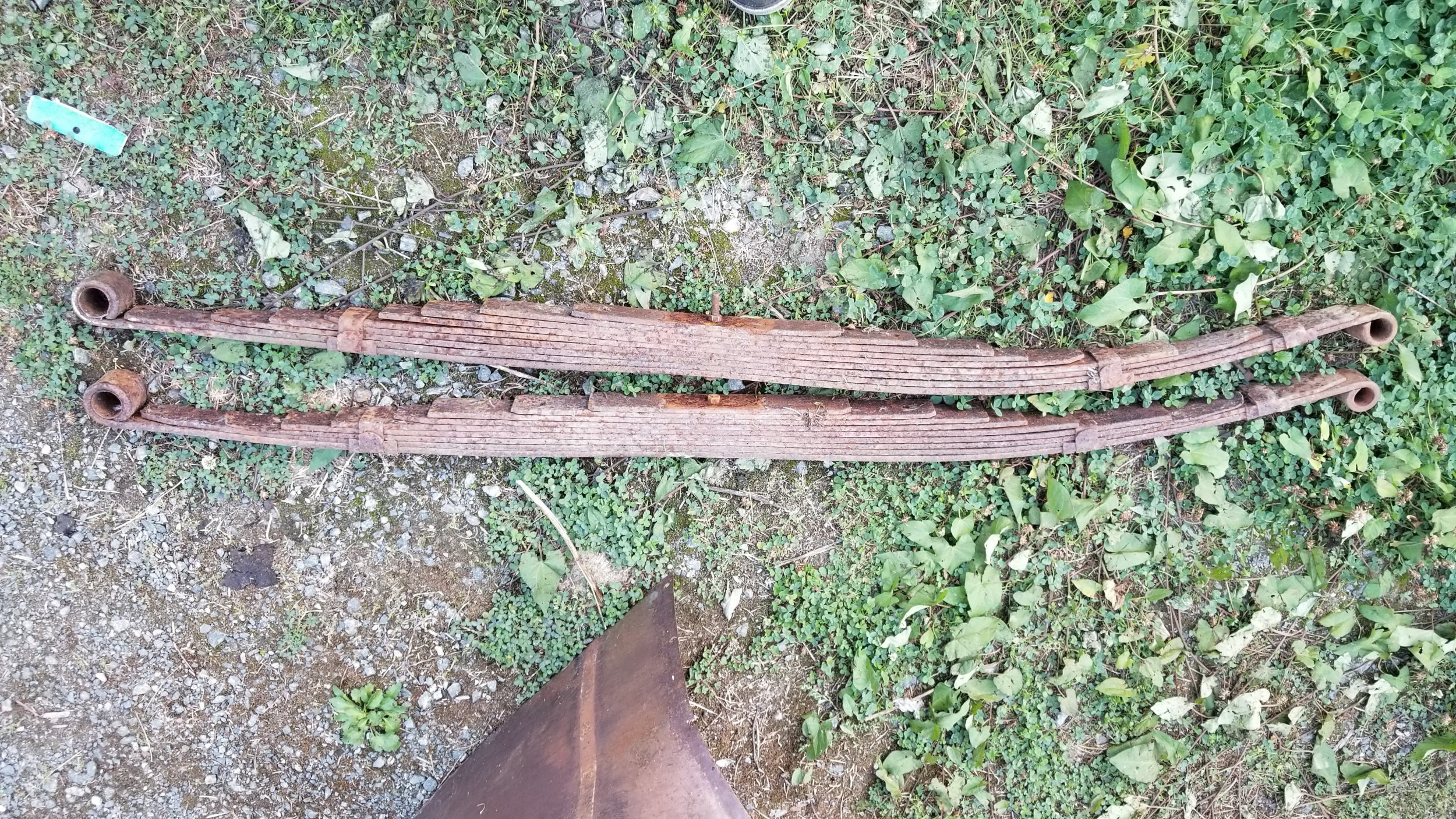

    Shiver me timbers and blow me down! lookit those springs will ya! Finding new replacement springs in this width is nearly impossible...with custom springs being the expensive option
    measuring the springs on the trailer and frame was difficult but having them out revealed as I suspected that they were almost identical in length give or take a 1/4"....buuuut the "new" springs have the centre pin right in the middle at 27" whereas the DeSoto springs have the pin further toward the front at 25"s ... the other issue is that the original springs had a reversed eye at the front @Moriarity pointed out that the mounts could be reversed...I've been looking at that a realised that if I put them in the stock position they will be hanging under the frame 3" or so and some kind of bracket will have to made to prevent flex....

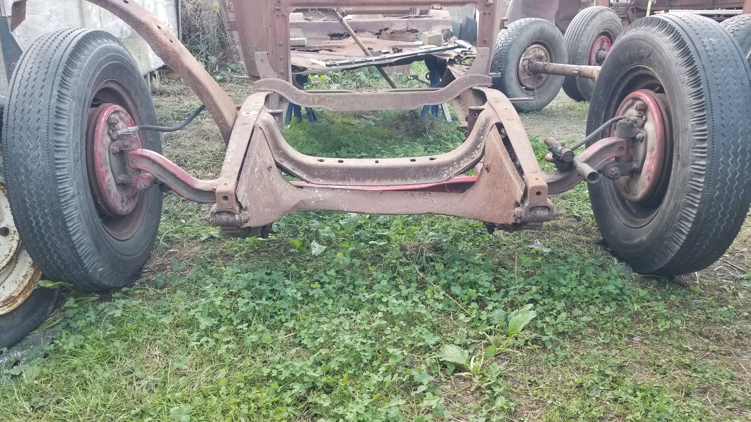

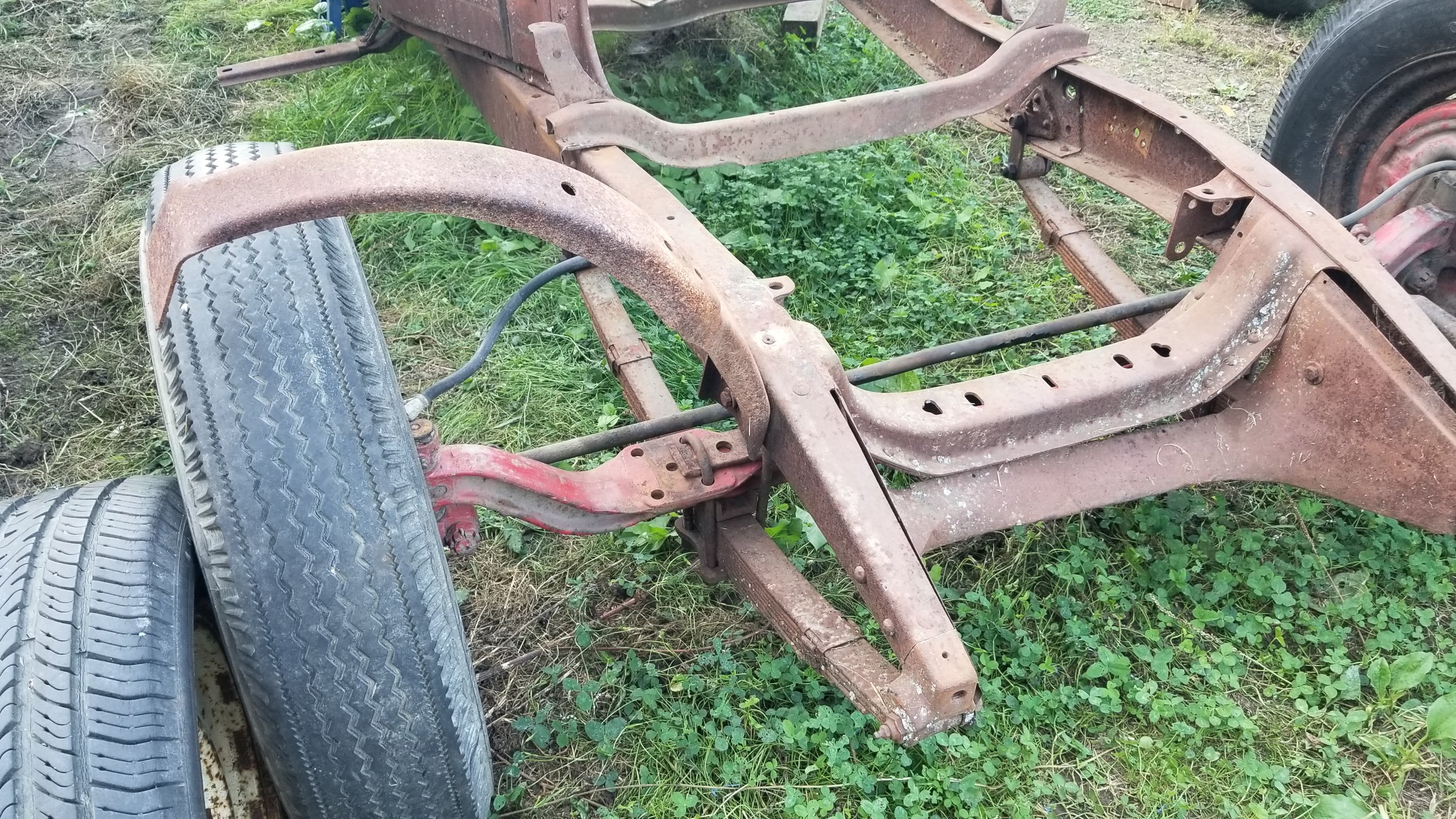

    I got the front axle under the car and decided I didn't want nose bleeds but can't afford a dropped axle...for some reason I couldn't find a lot of info about putting the axle over the springs...seems like a no brainer to me...but I'm guessing there's a reason why it's not common?
    the scrub line is pretty close but with a flat tire between the rim and ground it should be ok...the steering rod is close to the spring but that should stay static...if anyone knows a reason that it wont please let me know...I think if I reverse hone the hole for the tie rod ends I could possibly flip it to the top...

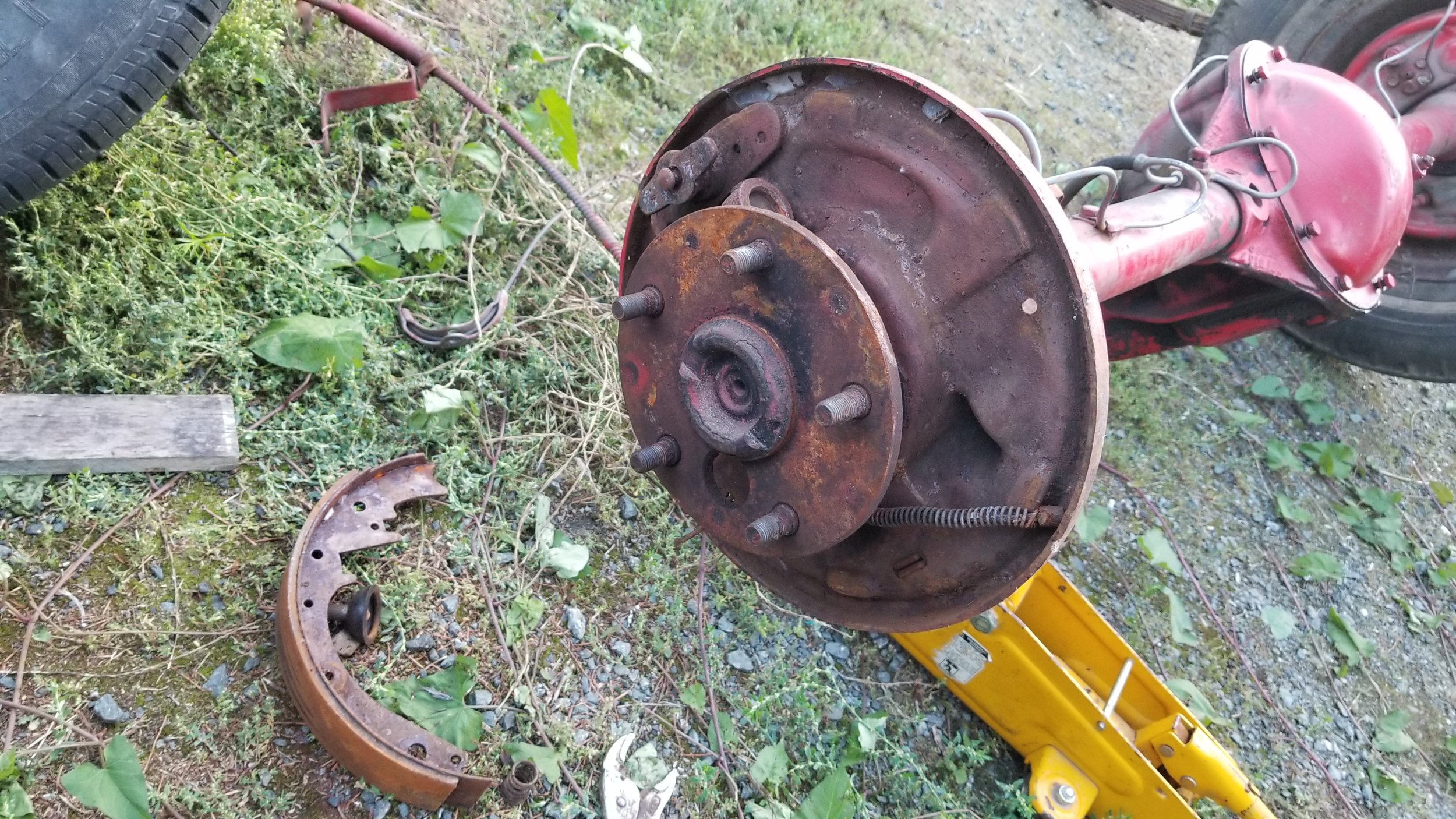

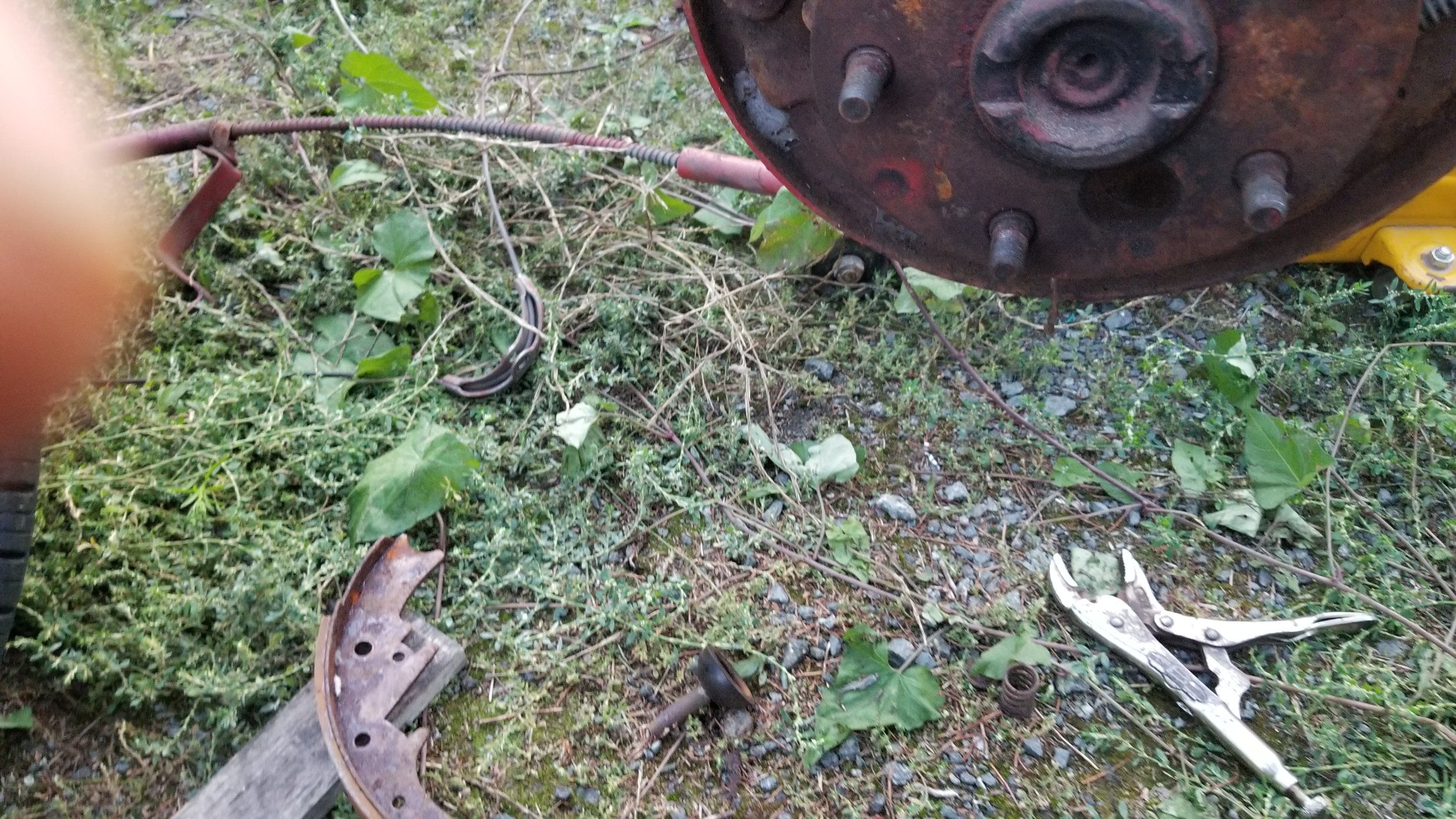

    053.jpg 054.jpg 055.jpg 056.jpg 057.jpg 058.jpg when I had the axle free I noticed that although the drums were missing there were some brake parts hanging there! driver's side too! It wasn't great the linings were all ripped off the shoes...except the very one I needed!
