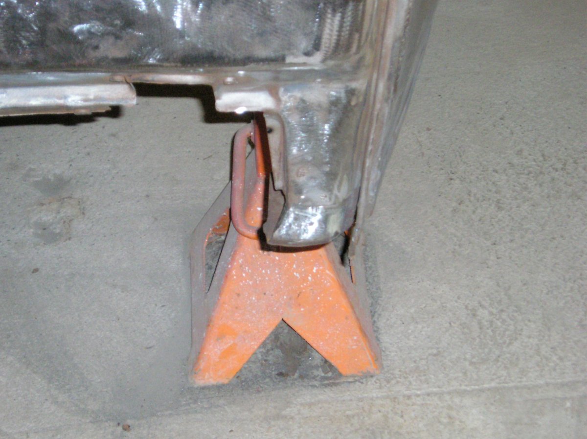

    Spent yesterday fabbing up the front body mounts. Had to extend the bottom of the firewall to make room for the frame hole. Took our time and got everything lined up and fitting nicely. Still needs some cleanup and a little more welding on the inner bracket but you get the overall picture. Enjoyed the process and loved the new welder! IMG_0787.JPG IMG_0789.JPG IMG_0791.JPG IMG_0772.JPG

    the doors are really close yes. the p***enger door needs to come up at the back a little which i am guessing will be achieved when shimming the body mounts at the cowl. if you have an opinion on that, feel free to share. we left room for adjustment when putting in place.

    Really nice car, going to be lots of fun. Just wondering were the original little brackets gone? I just raised mine up a little. Tons of A builds on here, lots of neat tricks on building an A to be found with a little searching. 68 006.JPG

    Yes they had been cut out to make some provision to move forward so i continued on with that theme. they did come with the car in one of the parts bins and i had discussed with the previous owner. I trimmed them down as they had to move outwards to lineup with the new frame holes. bolted the trimmed piece in place and then cut out the new pieces to connect it up to the firewall and around from there. Turned out not too bad if i do say so myself. Didn't want it to look out of place so i think once i finish cleaning it up a guy would have to really stare at that area and know what he was looking at to notice the change.
