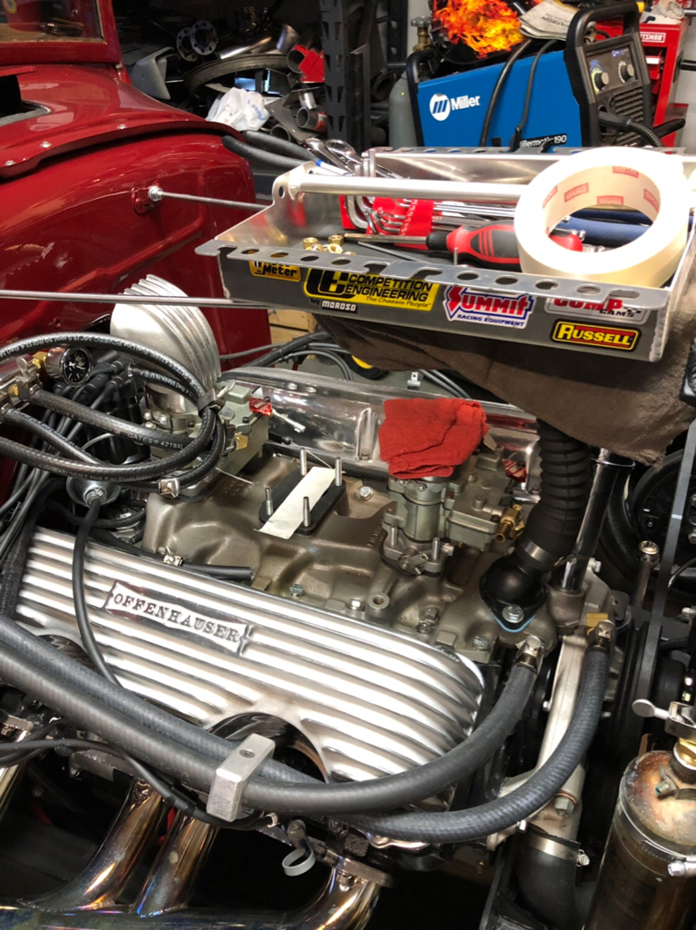

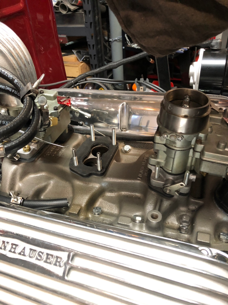

    The pursuit of a better tune continues. Pulling the carbs to install longer carb studs as I am adding phenolic spacers to help keep the carbs cool like a few guys suggested. Can’t hurt the way I look at it. Also bumping the jets up. Spent some time chatting with a few guys on the 348-409 site talking about jetting on the tri powers for them and with the few little characteristics still with the motor we’re thinking it needs just a little more fuel. With no fenders the job is made a lot easier!! I ordered the spacers and jets from quadrajetparts.com Seems like decent pricing and all the right parts in stock.
