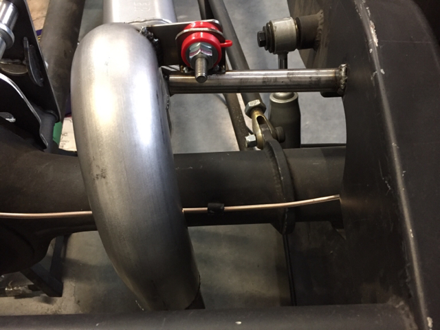

    Got one side of the exhaust done. Took my time to build it slow, thinking of matching it on the drivers side. Happy with how it turned out. The hanger grommets from jegs work slick. Will do some cleanup work on all the pipes once I get the other side done. I will be "flash dipping" the headers and tube down to the first attachment point as Matt from Geardrive gets them done. Not sure what to do for a coating on the rest. Never seen anything from a rattle can last very long. Any suggestions from anyone is more than welcome.

    I ***ume you're referring to the flex joint? Not a converter, allows flex from the motors movement without transferring into the rest of the exhaust.

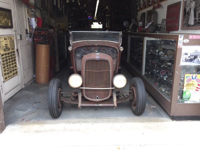

    Got to go to the early Ford store today! Picked up the cowl vent parts I needed and a some other goodies. Best part was I scored this Sun tach. Happy about that. They had pulled my order which I placed last week and had them hold for me to pick up. Funny they couldn't find where they put the order so they gave me what they could find and are shipping the rest to me no charge. And Mike scored me a t shirt for free too! Nice guys to chat with and I was literally drooling over all the original stuff not to mention the three window and roadsters! Would have stayed a bunch longer but the fam was getting ancy wanting to head off to universal. If only we had a place like this close to home!!!
