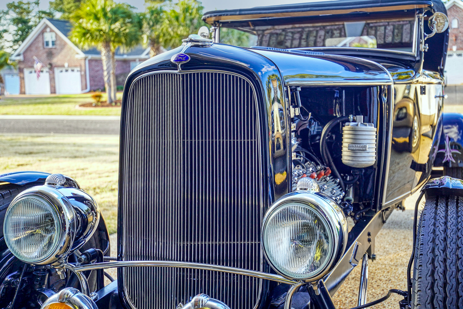

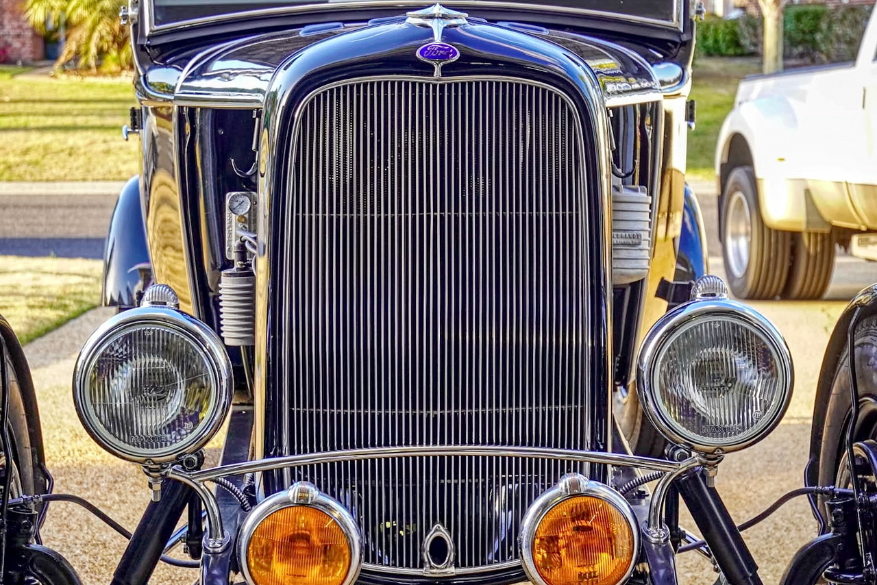

    I used a 32 one piece hood that was shortened to fit the opening on my 1931 A roadster but I suspect this could be done with an A hood as well. I raised the side accent lines to match the A body line. I then added stock model A hold downs to the lower edge and a tab coming off the radiator shell. There is a pin in the rear center of the hood which matches with a hold down on the cowl. It's been 65 mph and is pretty solid actually.

    Beautiful Any chance you can post a picture of the hold downs and tab in action! :) -John

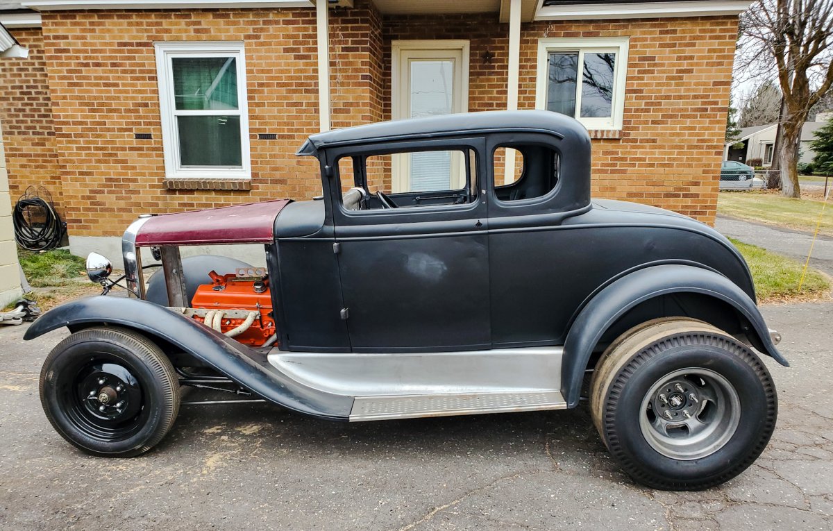

    Mine isn't mounted yet.
    1930 Model A Hood Top Chopped.jpg Chopped 30 Hood Top Bead.jpg 1930 Model A with Chopped Hood Top (1).jpg
    However, I'm going to fabricate tabs for the hood and spring rods. There's a great post here on the HAMB about it.

    Here you go hurlbird. I just happen to have it off the car at the moment.

    thank you i now seem them on the first photos.... nice
