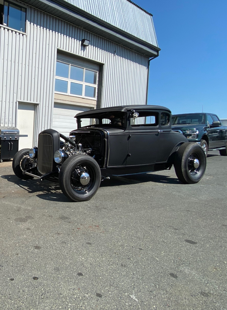

    Here's the car in question:
    Atwater Mike likes this.
  3. Atwater Mike
    Joined: May 31, 2002
    Posts: 11,618
    Atwater Mike
    Puritan in Primer! Layout is perfect, radiator and shell just right, ch***is/wheels in scale with chopped body.
    Just excellent!

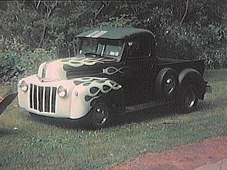

    Bought this '46 Ford pickup as a "stocker" with a fresh 59AB in it. Ran strong, great oil pressure...but had a ticking sound. An old time mechanic figured it out.
    It ended up being a minor crack between a cylinder and a head bolt...letting a tiny amount of compression to seep out of a head bolt...with a tick sound.
    It was a reasonably easy fix.
