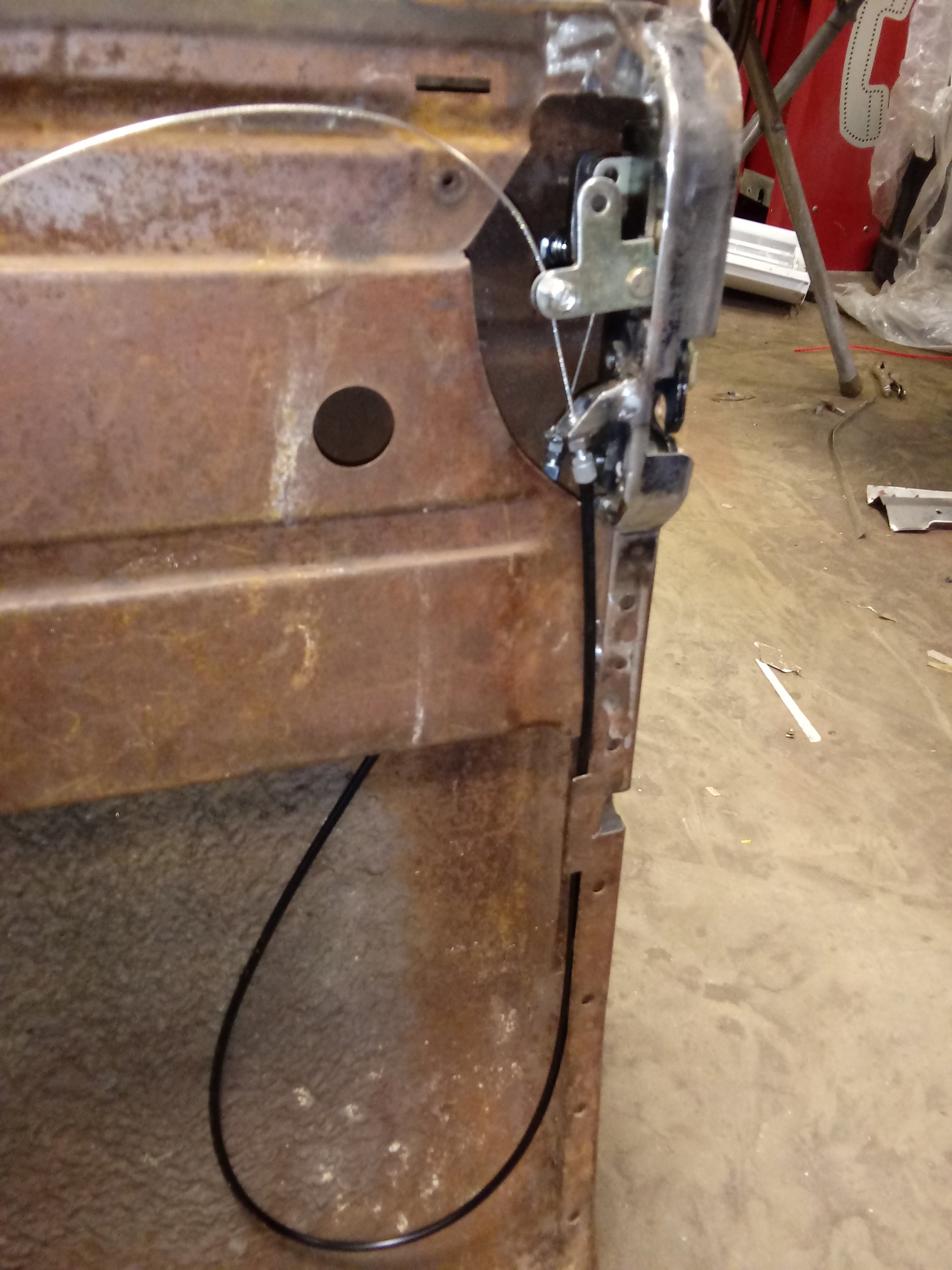

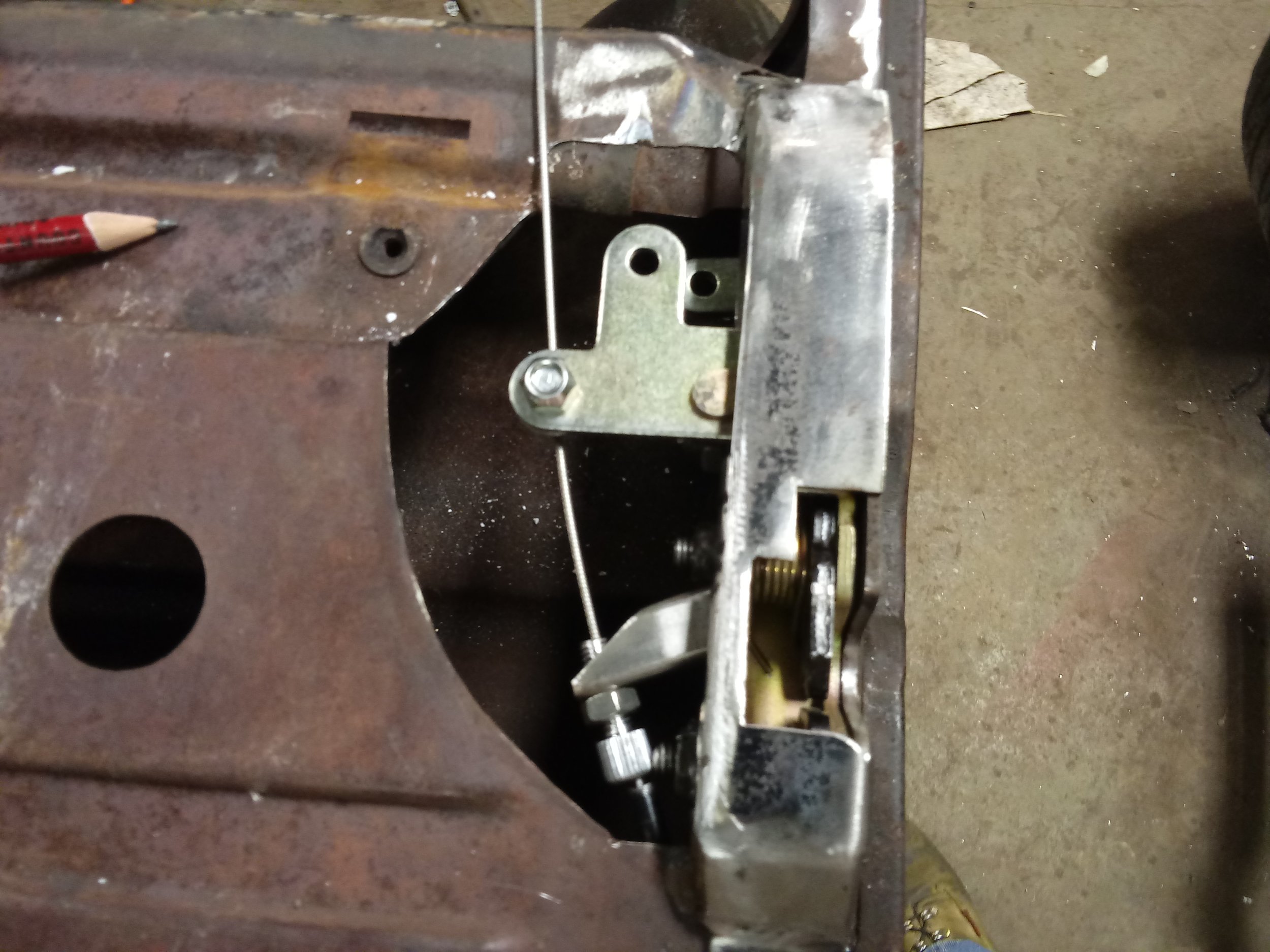

    I used new brake cables for a bicycle when I started building mine.
    Although different then yours still close enough to get ideas from

    Thanks for sending that lostone, this is definitely something I will investigate further. I'll read through that link in detail tomorrow morning.

    Posts: 3,949
    Kiwi 4d
