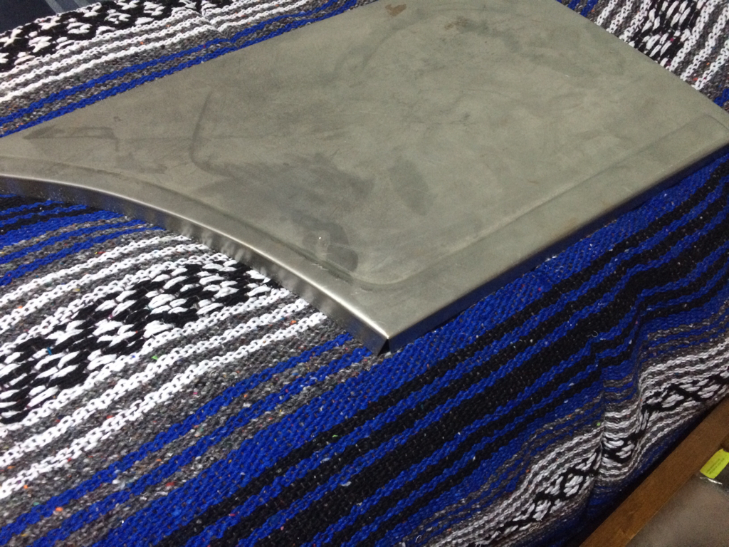

    Here is a Howells panel. It seems nice, but definitely will require a little work. It has no real depth, as seen in the final pic, and they don't connect the corners.

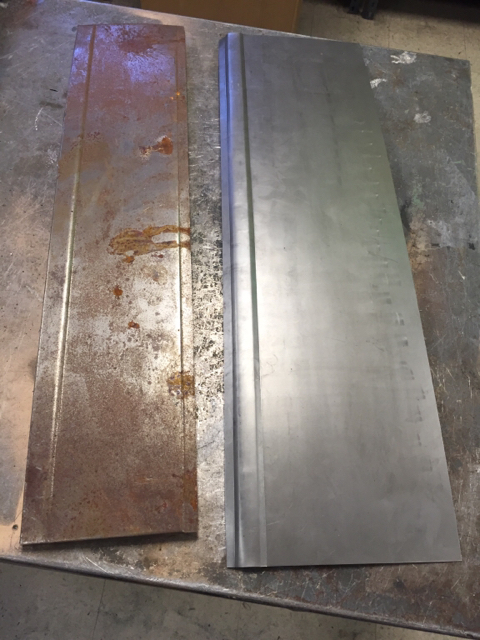

    That looks nice but I don't think we're talking about the same panel Ben. This is what I'm talking about.
    These are the ones from Snyders. They're pretty bad. I don't know if it's even worth trying to fix these. They feel like 20ga maybe.

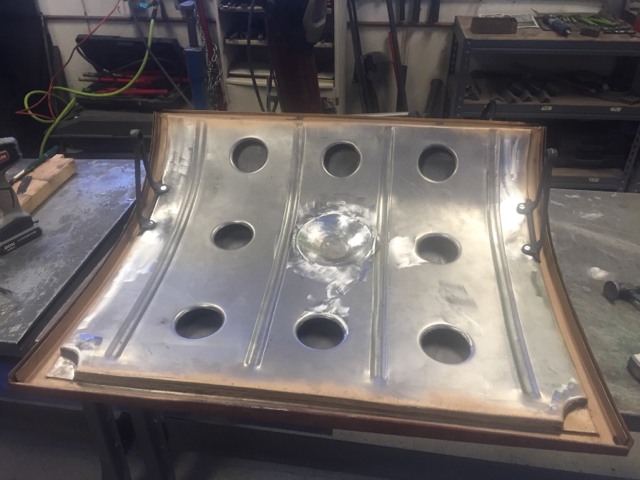

    Trunk lid is finally done.

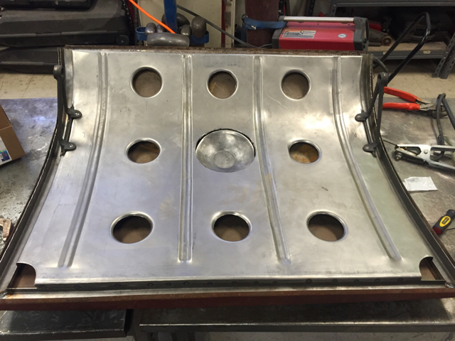

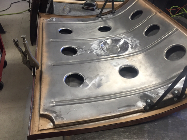

    The panel on the right is home made. The one on the left is a junk one from some distributor. Who lap welds stuff?
    Almost done. Just needs a little more sanding.

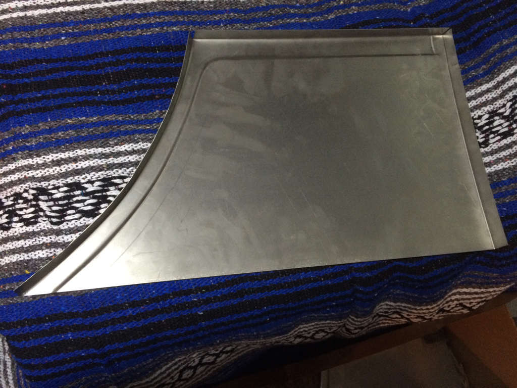

    I made the floor panel that goes under the seat riser and ordered the rest from Snyders. I also ordered the curved inner panel for the very back but apparently they think the one for a trunk should be on the rumble parts page, so I ordered the wrong one. So now I have to send that back and get the right one. I said screw Snyders and decided to give Howells a chance. I'm also sending back the garbage lower corners they sold me. I ordered the 9 inch tall ones and curved inner panel from Howells. Hopefully I have better luck with their stuff. The or floor parts from Snyders fit with just a little bit of persuasion.

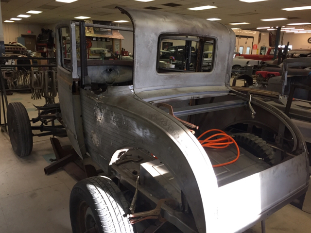

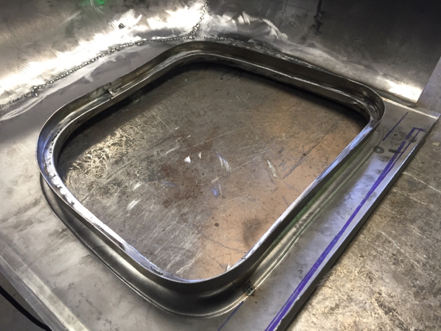

    First thing I did today was make the channel for the quarter window to sit in.
    Next I cut the window part off the quarter.
    I cut off the part where it bolts to the back window section and welded it to the new quarter window section.
    Then I put the back window section back on the car.
    And finally test fit the new quarter window.
    I believe we have a lecture tomorrow so I will have to wait until Thursday to continue working the panel that goes over the door.

    New quarter window and panel above door in tacked on. I was going to get a roof off another car but I think I'm just gunna make my own. That's what the flat sheet on top is.

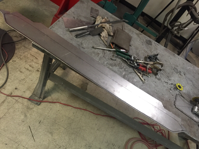

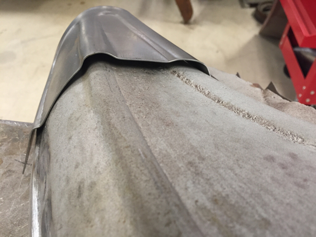

    My visor was pretty rough so I decided to make a new one. I started by making a pattern and cutting it out of 18ga.
    Next I started to tip the front edge down.
    I tipped it as far as I could and used a thin s**** and hammer to bend it over until it was almost closed. Then I inserted a piece of tip wire and hammered it all the way over.
    Then I rolled the other beads into it.
    ImageUploadedByH.A.M.B.1457137136.750466.jpg ImageUploadedByH.A.M.B.1457137146.860455.jpg
    It took a little bit of shrinking and I wheeled the top part a little to smooth it out. I still need to shrink the metal on rah end to get it to curve a little more, but it's just about done. I also got my roof filler tacked in but forgot to take pictures.

    I've never made a visor, but I've considered it so take my comments with a grain of salt. Shouldn't that leading edge that you are rolling over be covered in weld through primer before you start? Just thinking that could be a potential source of rust to mess up the final paint when you're done. There's no way you'll spray anything in there once it's squeezed... maybe you could still pour some primer in there ?
