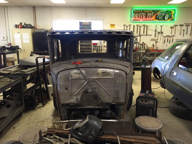

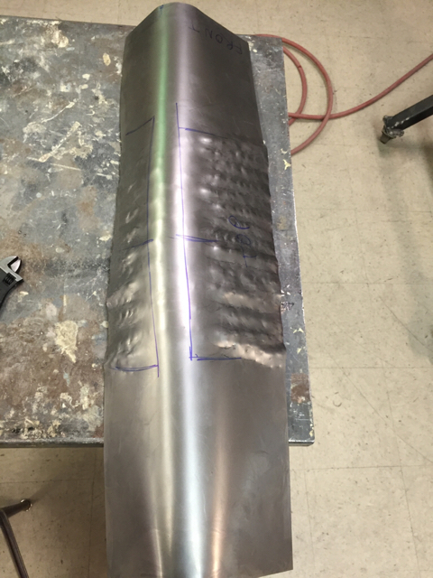

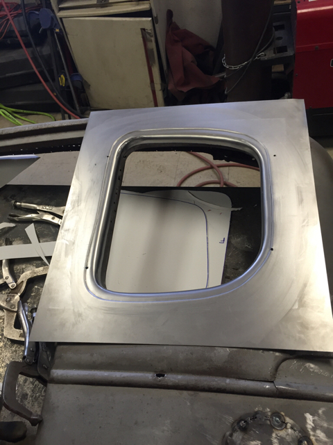

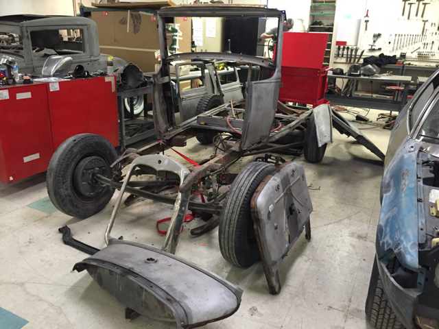

    It should be coated with something. I sprayed some rustoleum on it after I got it bent half way. The bottom isn't shown in the pics with the exception of before I sprayed it. I have weld through primer but it wasn't really necessary since that area won't be welded.

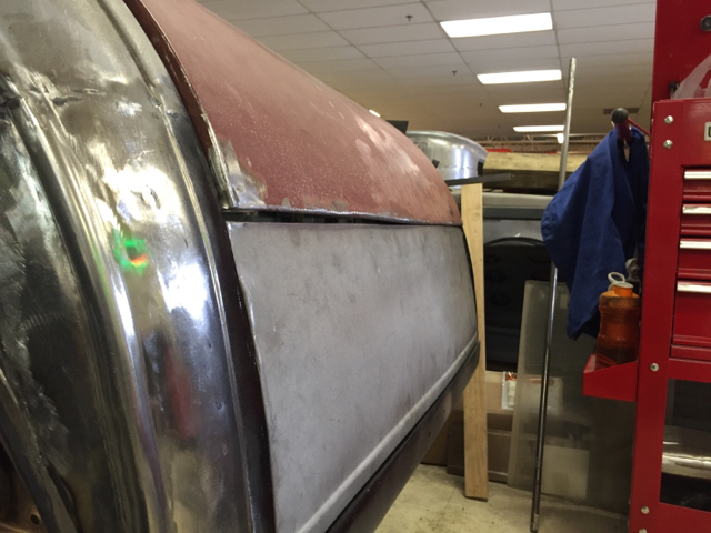

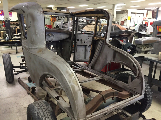

    Do you think it would be possible to make a single complete roof panel from the hole forward. Basically I'm thinking one panel from drip rail to drip rail including the visor... or is the visor itself too complex? Might be more work than grinding the welds for 4 separate pieces. My 5 window in waiting is identical to yours, but much rougher, so I'll have to replace the side panels as well as making the roof panel.
  4. 28av8
    Joined: Jun 18, 2005
    Posts: 172
    28av8
    Sounds like it would be a lot more work then making it in multiple pieces. I dunno how you would ever maneuver the whole roof in a bead roller to do the visor. I find myself other trying to make too complicated of a piece and just end up cutting it apart to finish it

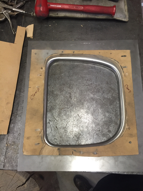

    Got the visor finished up this morning. I punched some holes in it with a dimple die. Now it's sure to go fast haha.

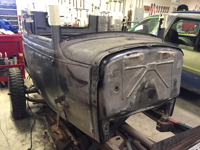

    It's amazing what removing 5 inches of metal will do.

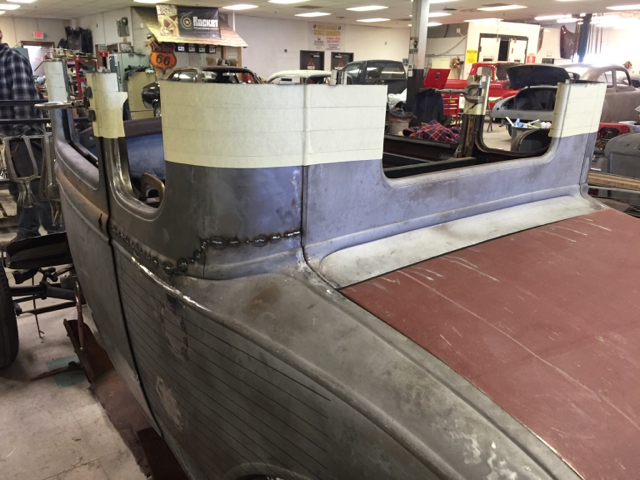

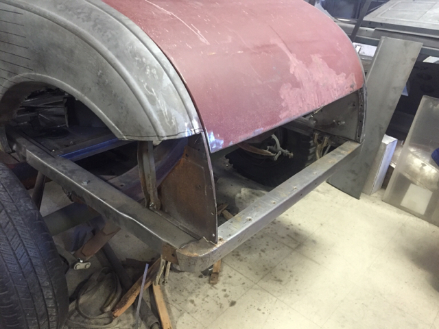

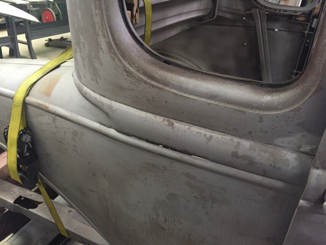

    I made some relief cuts in the back and started tacking everything together.

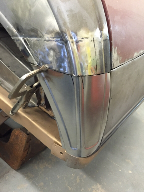

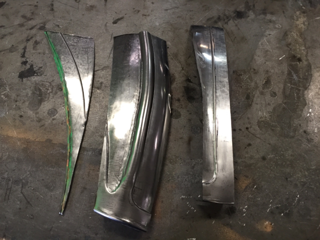

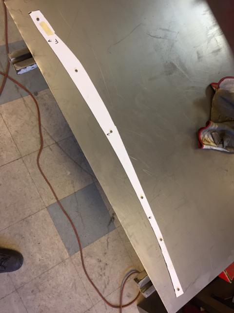

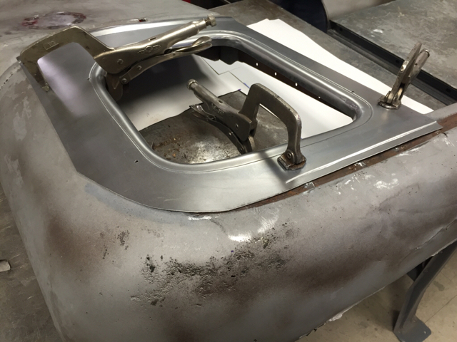

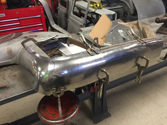

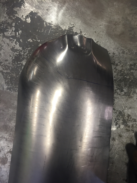

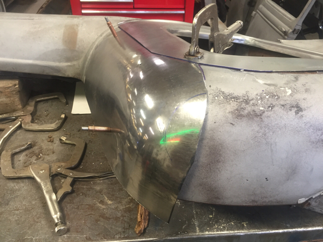

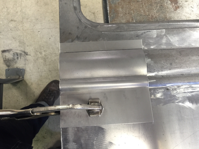

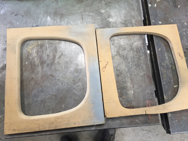

    I spent the day working on my rear lower corner piece. I started by making some patterns. I tried making it out of one piece but couldn't get it through the bead roller. I ended up cutting it into 3 pieces.
    It took a lot of shrinking on the pullmax to get the right shape. It ****ed to have to cut it but it made everything a lot easier.

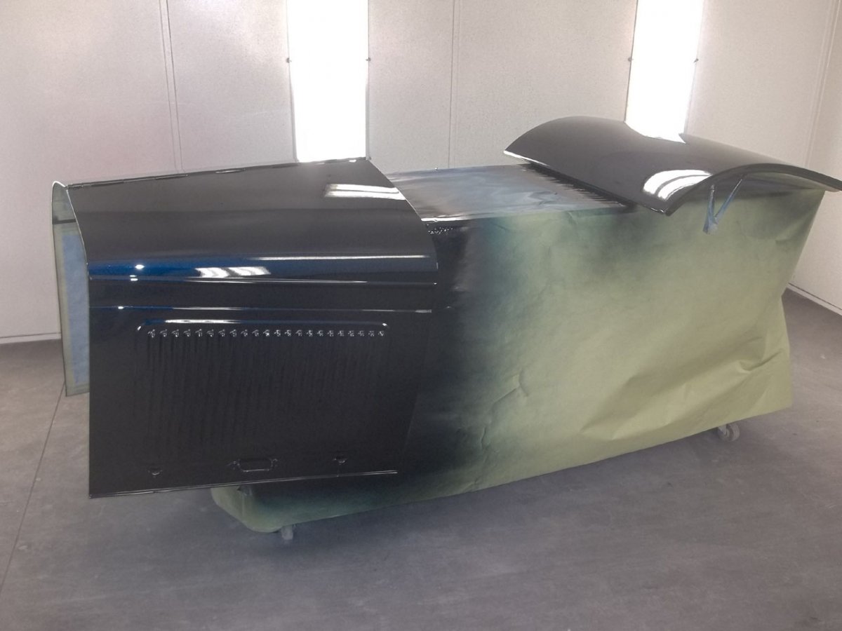

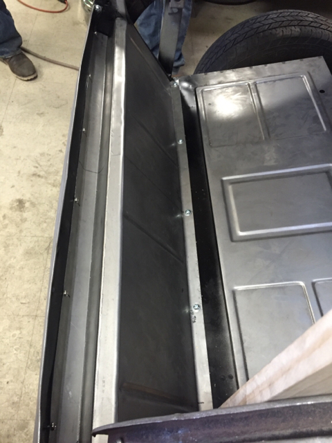

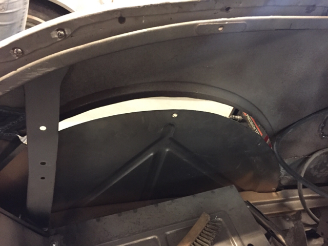

    I got around to making the rear inner trunk panel today.
    The trunk lid fit like ****. It wasn't flat on the bottom. I trimmed it and welded the seam up.
    Before.
    After.
    O yea, and now it's a trunk instead of a rumble.
    I still have a lot of little stuff to do on top of the wheel wells. Tomorrow is the last day of body fab. I start refinishing in a couple weeks. I should be able to finish everything there. The goal is to be leaving with a painted body in the next 3 months.

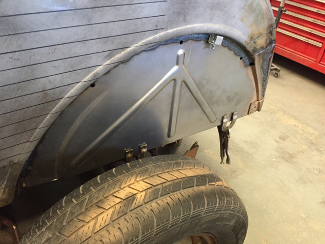

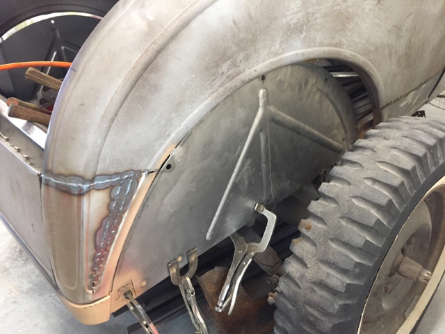

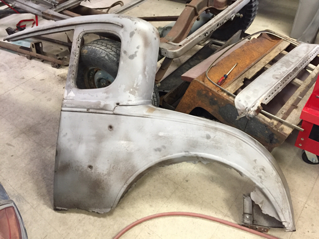

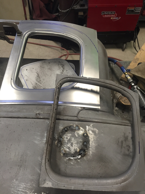

    I got right back to the grinder this week. Here's some new pics.
    They still needed a little work.

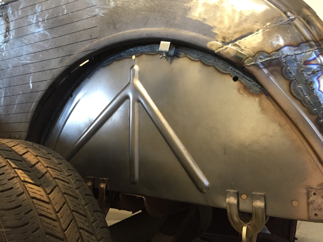

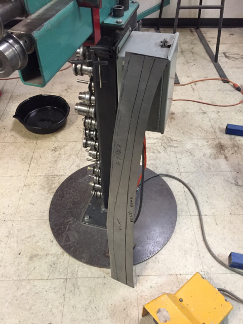

    This Lazze bead roller is pretty much the best thing ever. The inside bottom die is just a guide. I tipped the edge up around the upper die. Then I just had to shrink the curve.

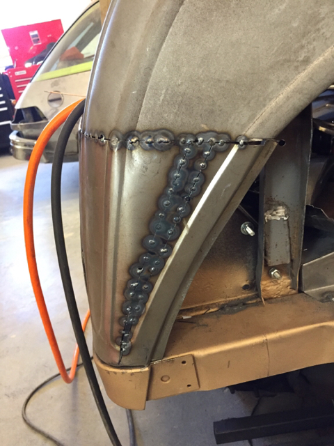

    Trim to fit and start welding. I did the wheel well to the curve on the table.

    Forgot this one. I made the drip rail for the drivers side. It's a pretty good match.
  29. Dino 64
    Joined: Jul 13, 2012
    Posts: 2,553
    Dino 64
    from Virginia
    Thanks for showing the wheel wells repair. Is the panel a reproduction, if so where did you get it. You did a great job. Unfortunately, I don't have the equipment, but at least I know how to do it. Thanks.
  30. 28av8
    Posts: 172
    28av8
    The wheel wells are from Snyders. They were much better then some of he others I've seen.
