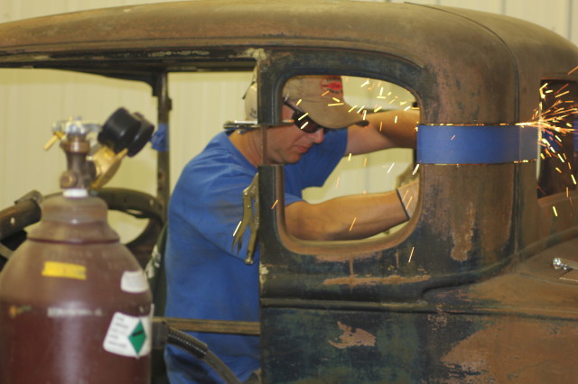

    took some time off to build my own shop. i brought the coupe home from my dad's place so i can work on it at home now. i seem to get more done that way. now i can work on it when i get home from my job. i chopped the top 3 inches one weekend. so here are some pictures of that.

    You made that chop look easy. I'm not convinced to chop mine yet.
