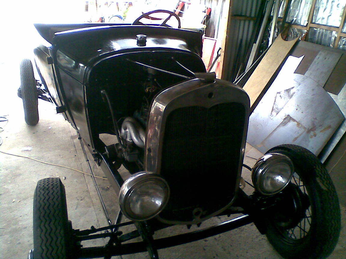

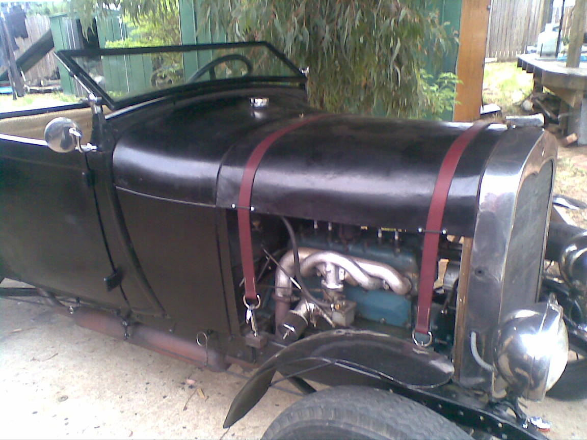

    Hi there Entlebucher. Here are some photos of mine. I didn't choose to do this, I just made my car with what happened to come to hand. When I find a shorter radiator, I'll probably put a 28 grille shell on or I will lower the 30 grille by cutting the sides away as on a 32.
    . My ch***is is a 31, by the way, and I have been told, although I don't know if it is true is that the radiator mounts are slightly more recessed than on the 28 29 ch***is. This might mean that the "uphill" hood that results from running the later grille with the early body may be more extreme when using the earlier ch***is.
    I found that the 28 hood sides sloped up too much to use so I fabricated a hood top out of s**** aluminium. The upward slope is very slight and almost invisible when running without a hood and it kind of works if you run a lot of rake (I have fitted 5x 16s on the front and 7.50x16s) but it does annoy me. I couldn't bring myself to move the radiator forward to lower it. It just looks too long in the nose to my taste.
    Anyway. My car is just a rough jalopy and, historically, I have seen similar rough, nose-high cars made out of bits and pieces, just as mine is, so I'm in good company, traditionally. Cheers -Ed

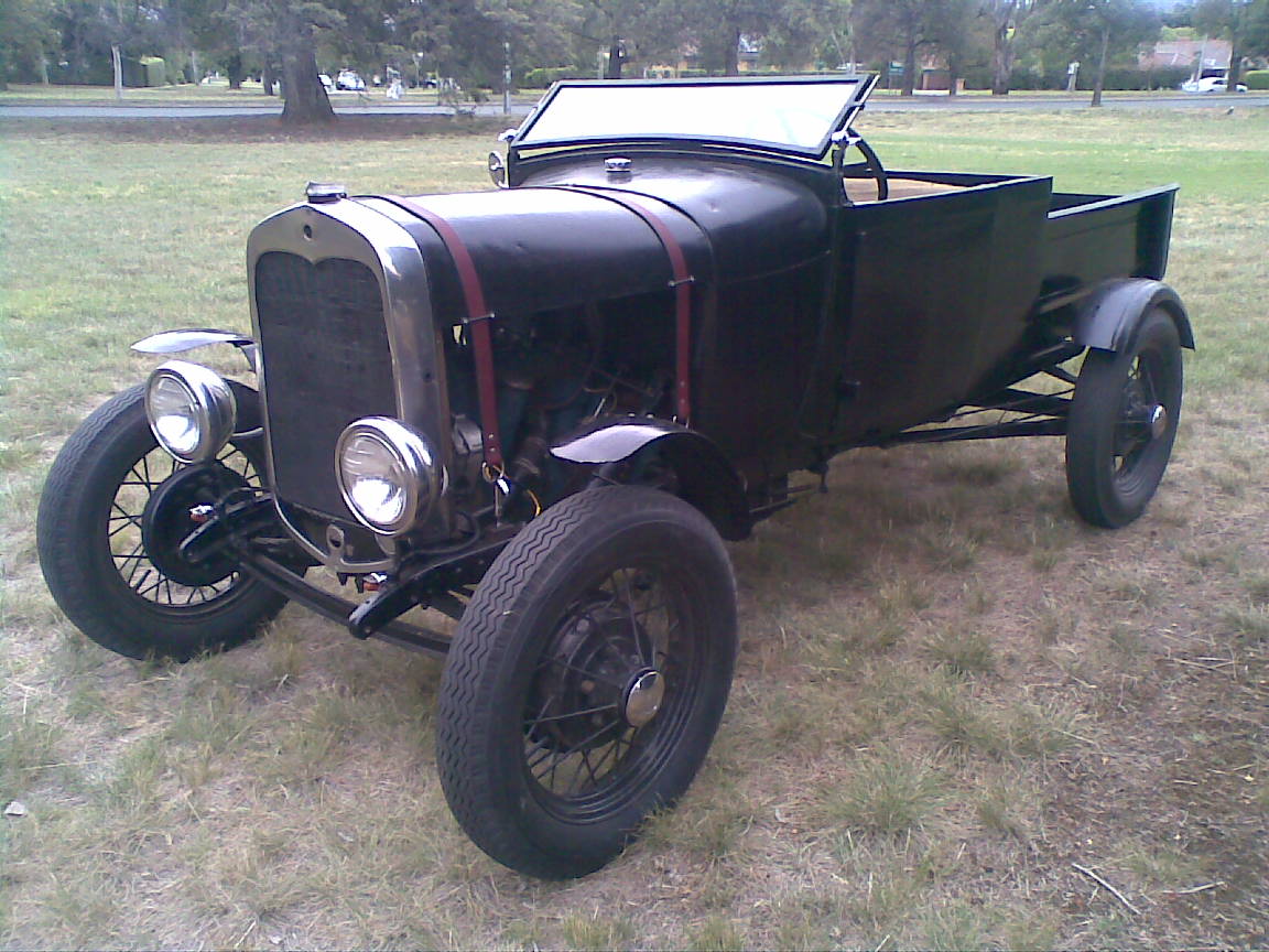

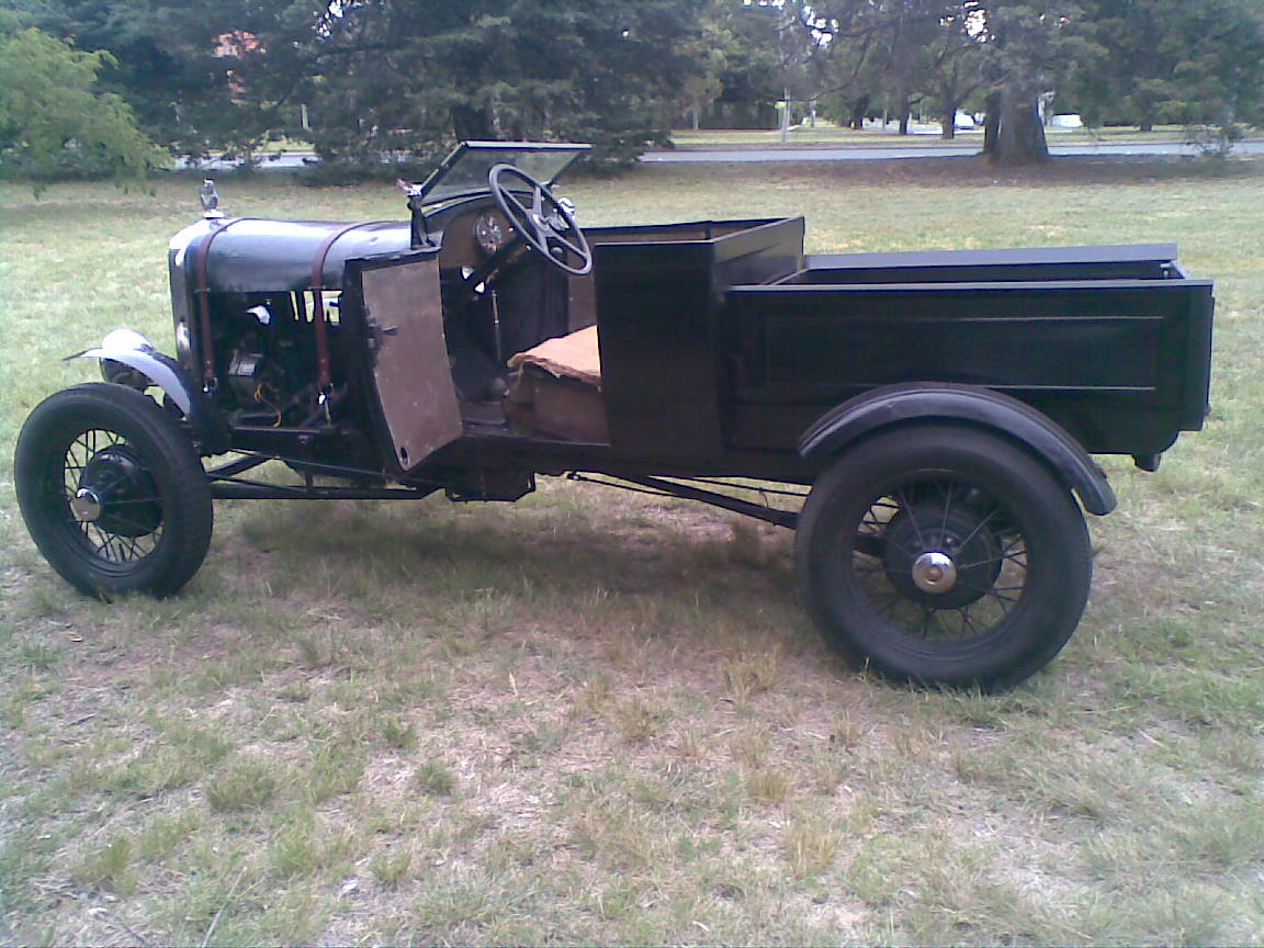

    This is the shell that (need louvers) is talking about cut down a '30 commercial I think its a model AA <TABLE id=post7455894 cl***=tborder border=0 cellSpacing=0 cellPadding=6 width="100%" align=center><TBODY><TR><TD style="BORDER-BOTTOM: #e5e5e5 1px solid; BORDER-LEFT: #e5e5e5 1px solid; BORDER-TOP: #e5e5e5 1px solid; FONT-WEIGHT: normal; BORDER-RIGHT: #e5e5e5 0px solid" cl***=thead><!-- status icon and date --><!-- / status icon and date --></TD><TD style="BORDER-BOTTOM: #e5e5e5 1px solid; BORDER-LEFT: #e5e5e5 0px solid; BORDER-TOP: #e5e5e5 1px solid; FONT-WEIGHT: normal; BORDER-RIGHT: #e5e5e5 1px solid" cl***=thead align=right></TD></TR><TR vAlign=top><TD style="BORDER-BOTTOM: #e5e5e5 0px solid; BORDER-LEFT: #e5e5e5 1px solid; BORDER-TOP: #e5e5e5 0px solid; BORDER-RIGHT: #e5e5e5 1px solid" cl***=alt2 width=175><SCRIPT type=text/javascript> vbmenu_register("postmenu_7455894", true); </SCRIPT>

  17. need louvers ?
    Joined: Nov 20, 2008
    Posts: 12,901
    need louvers ?
    That's the ticket! God I miss that little car!!!

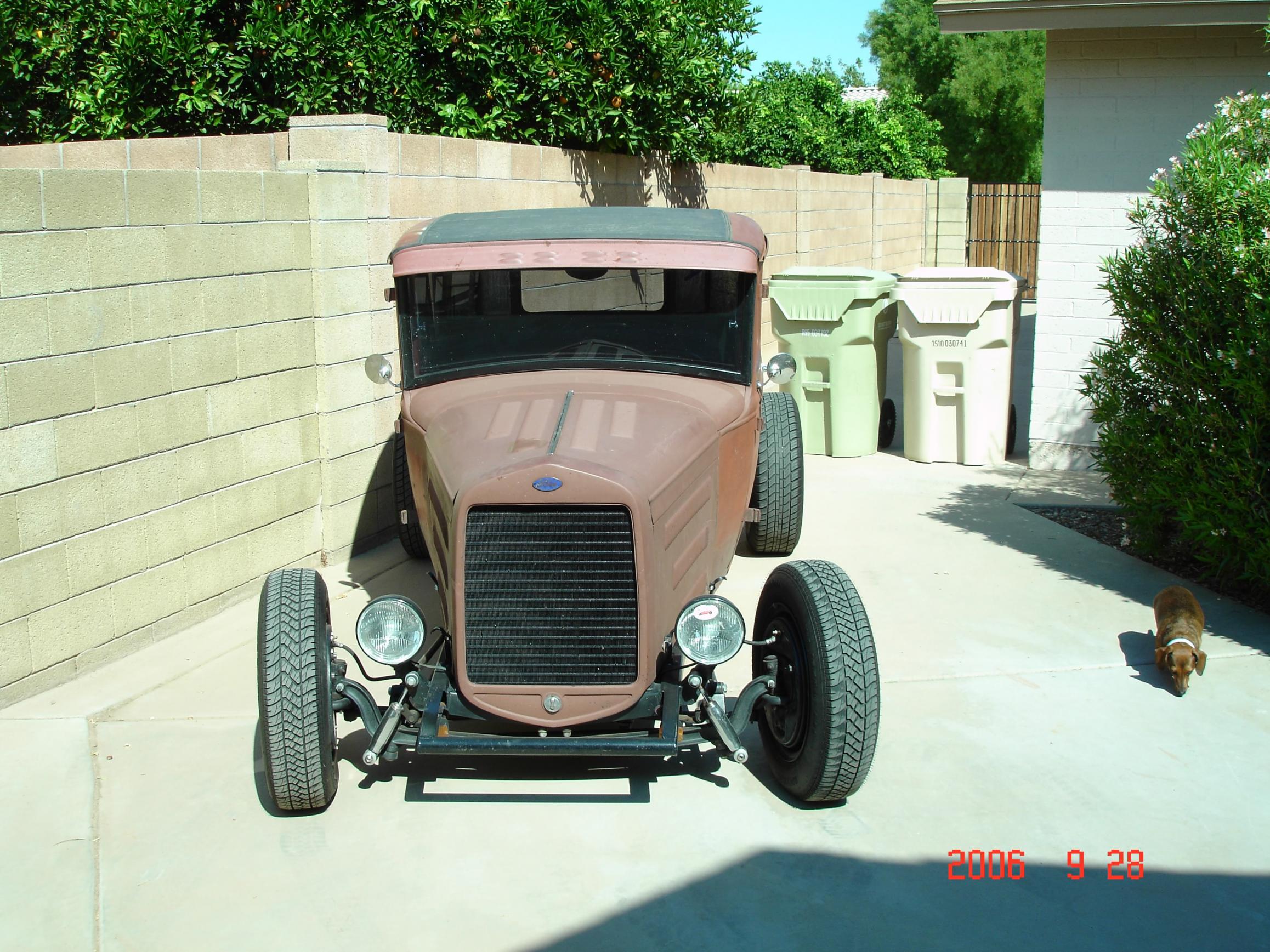

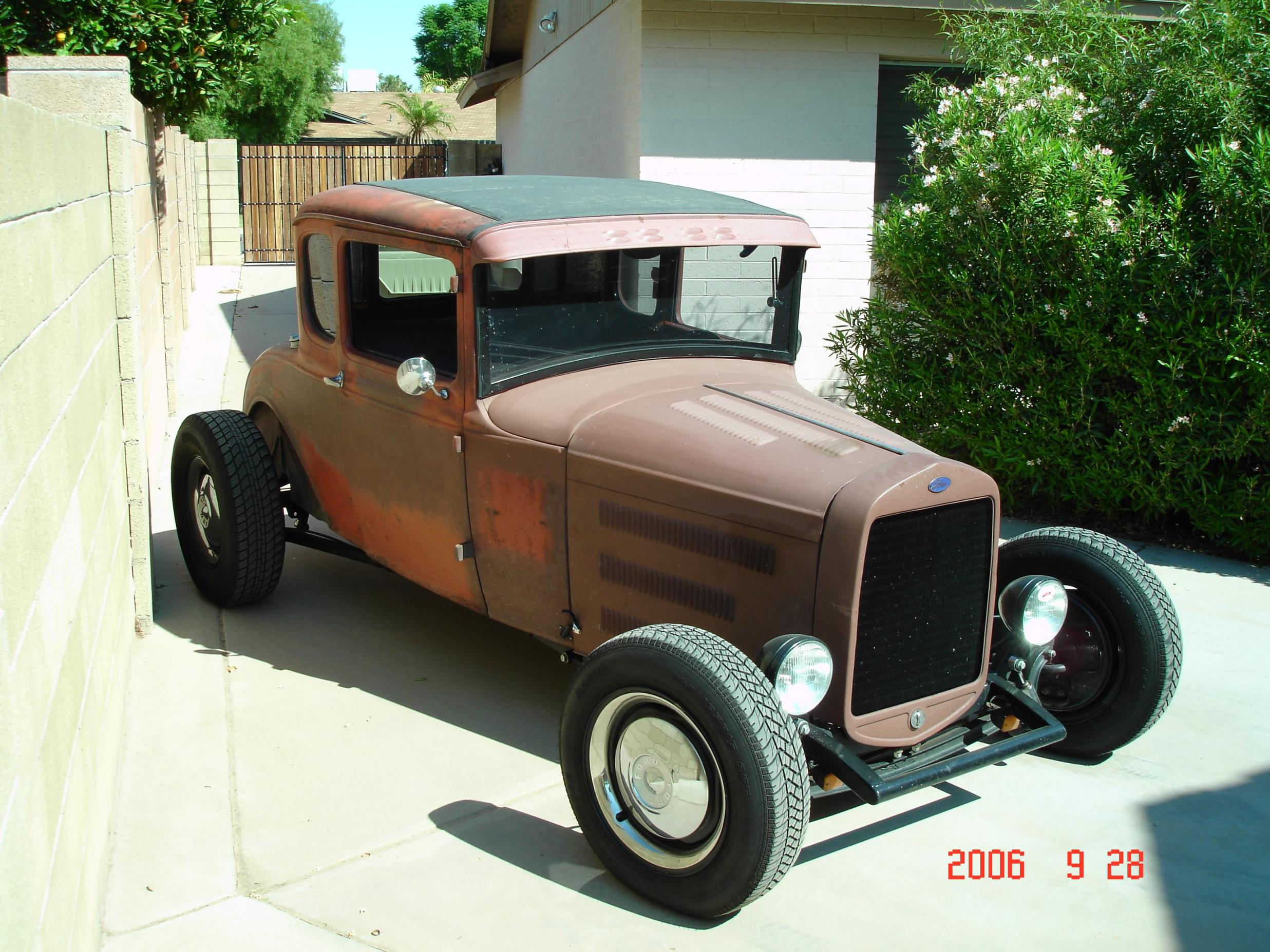

    When I was mocking up the tub, I started out with the original '29 shell on it. I hated it. I could see the front spring clamp and a small amount of the crossmember from standing in front of the car. All that stuff is hidden by the splash apron on a stocker,but mine is a hiboy now.
    I felt the need to cover the ugly with something. I grabbed a '30-'31 commercial shell that I had hanging on the wall and propped it up on there with the top of the shell at the correct height. It worked out great I think. It's about three inches taller than the earlier shell, which was just enough to cover the ugly.
    So I went ahead and built the car with the taller shell. Made a custom aluminum radiator and fan shroud. I don't take a lot of pictures...this one is a couple of years old. Since then I've chopped and leaned the windshield and a bunch of other stuff.The disc brakes have been replaced with chrome '40 drum brakes. She's just a few days away from being fired up for the first time.
