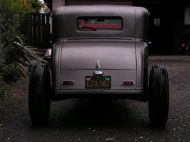

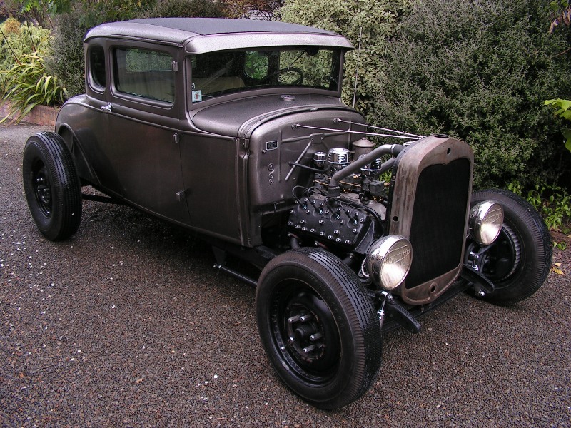

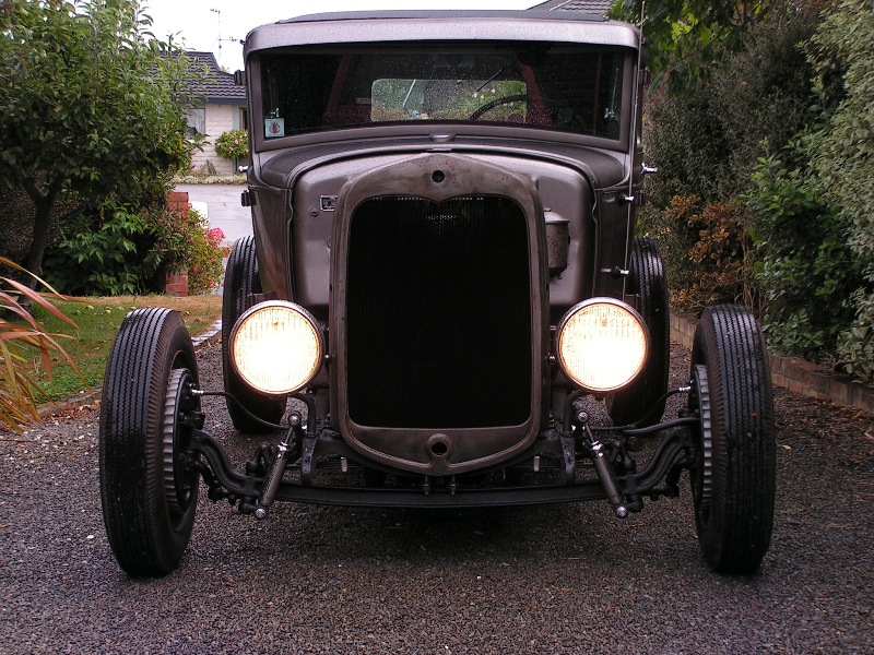

    I hadn’t run the engine since buying it and trying it out on the little stand I made. I poured some gas in the tank; fixed a weeping fitting inside under the dash [tank]; primed the fuel pump [I’ve got one of those Canadian pumps with the little primer lever on the side] and turned the key. The engine fired up with less than one turn. Excellent! :) I had to shut it down straight away as engine oil came spewing out of the filter. Bummer! :( So after fixing that small setback it was time to make this thing move under its own power – test drive time! All went well to start with but then I had a reoccurring fuel blockage issue – with the carbs then flooding! :mad: I couldn’t work out where the black snot was coming from as it was after the fuel filter. It had to be the fuel pump. Turns out the “rebuilt” fuel pump had a bead of silicone sealer put behind the mesh screen to hold it in place! That took some figuring out. After the initial frustrations and changing out the pump I managed a first drive - Yeah! A few laps around the block and back for some adjustments. I had to lean off the fuel mixture quite a bit [exhaust was a bit stinky] and put that rear spring leaf I left out back in after bottoming out a couple of times. The engine was a bit noisy alright with no mufflers – raspy more than loud really. Then this old buddy of my dad turned up...“I bet you forgot the chicken netting”. What the..? Apparently [us] “young fellas” don’t know **** about how it was done back in the day. So I pulled the centre section of pipes out and as “instructed” cut a 1 foot piece of chicken netting off the roll for each pipe, rolled it around a broom handle a slid them into the pipes. That engine straightaway sounded totally different – nice and mellow and flattie-like. Well ****** me! Yep you do learn something new every day. So with that and the fuel issues sorted I drove around and around our area pretty much all the next day. :D I even had to refill the tank! Real pleased though – engine runs sweet; brakes work good; even the speedo seems to be reading right – and yes the wiper works. It just had to rain! This is my first hotrod and is definitely totally different to drive than anything else I’ve ever owned. The seat and steering position is surprisingly comfortable although I don’t know for how far. I’ll still have to look into the power valves as it is a bit rich when the gas pedal is stomped on. The best thing of all is that big radiator works real well. The engine never even got close to getting too hot. Even sitting running in the driveway while messing around with stuff it only got up to about 195F after 20mins or so. When driving around the suburbs it only got to about 160F – right on the thermostat. It looks like no fan required so far.
    So all in all I’m really chuffed with the first outing. :D Time now to put it away again and finish off a few things and get that tuck ‘n roll upholstery done for the seat and doors.
    The attached pics are of the car in the driveway after cruising around [and getting rained on] the second day……
