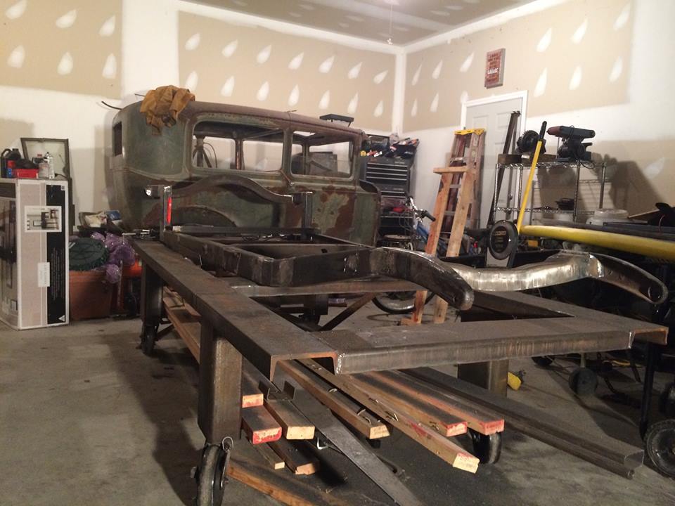

    well got some more done to the sedan. after getting the frame table from a bud . I started on lengthening the frame to fit the 351w without having to recess the firewall. where the old engine mounts where seems little to iffy for me so I removed that section as well. As we used our friends idea on how to lengthen our friends frame I followed with the same "good" idea. needed to add 5 in and replace the 3.5in I cut out because of corrosion. also did a 2in Z cut to make it more ridged and less stress than just straight threw cut

    Looks good, now let's square it up and Z the rear!

    well after getting the frame rails lengthened to help fit the 351w it was time to install the new front cross member since the original was shot. used the stock middle cross member for now to help keel everything inline and square. also put the rear cross member back till I was ready to do the rear kick up. after everything was tacked in place. IMG_2128.jpg IMG_7015.jpg IMG_4943.jpg IMG_6940.jpg IMG_2393.jpg
