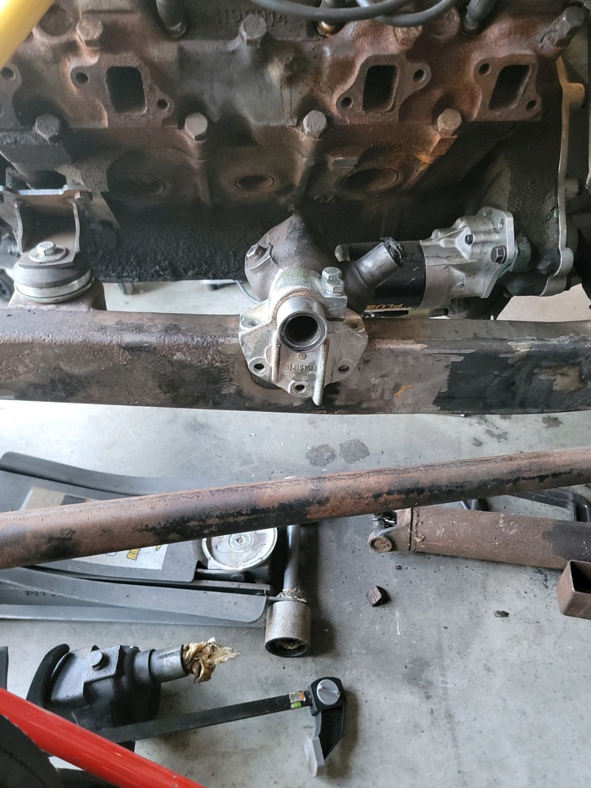

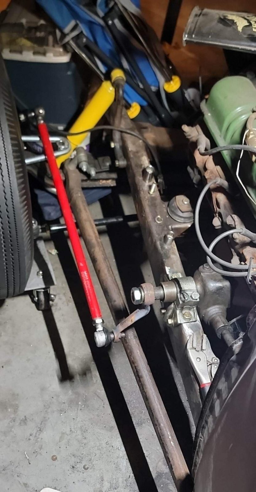

    still knocking away at it. got the steering somewhat figured out. would have like to keep the steering column and box one piece but that damn starter on the nailhead wasn't having it. so still at it haven't gave up yet almost hit 8years next month boy o boy 109794_jpeg.jpg Screenshot_20210916-212653_Message+.jpg 109822_jpeg.jpg

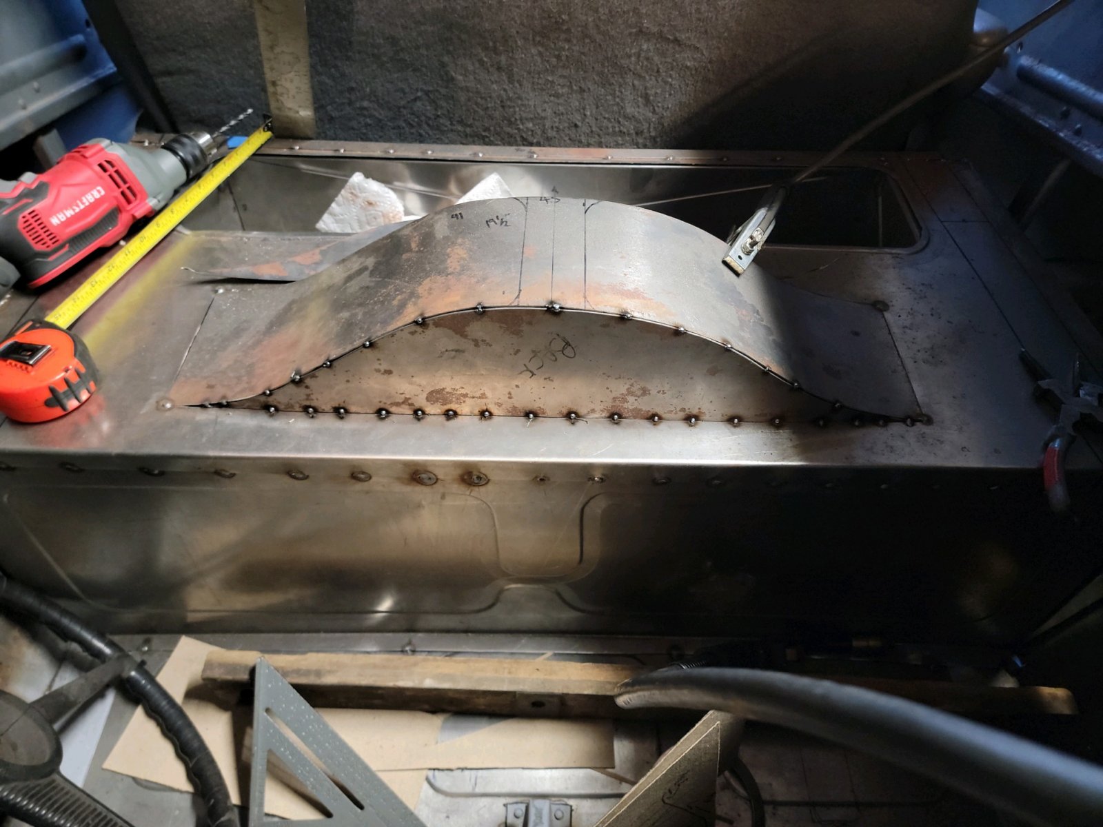

    Still plugging away at the floors one step closer. The ol lady worked on fitting the flipped firewall feet back on and couple cosmetics while i got some welding done to the rear spring hump and rear wheel wells. Also going to use a vw bus steerjng bracket to hold the f1 steering box.

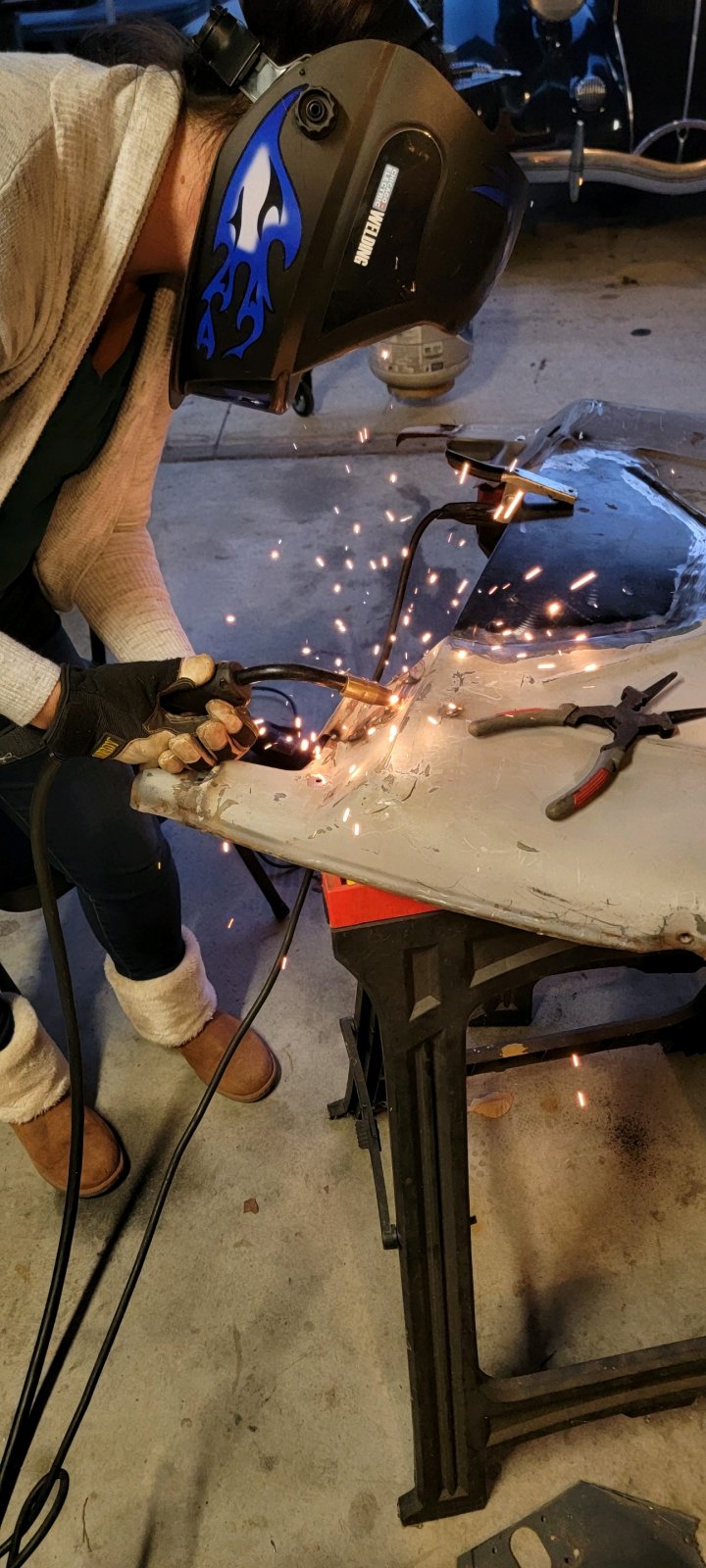

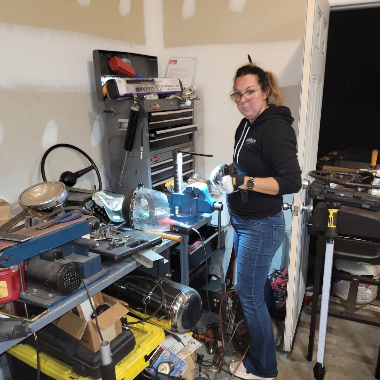

    Well haven't updated the build for a while. we have flipped the firewall and welded it back into place. got the front floor welded to the new floor. after working on the floor and fire wall we decided to change it up and knock out so other small stuff that needed to be done. So, the girlfriend made the final version of her taillight mounting brackets using fender mounting holes. i notched the front of the frame to keep the front spring from bottoming out on the frame when i jumped on it and tried to mockup where the f1 shock mounts would go. they need to be heated and bent. by no means winning a race but getting some littles

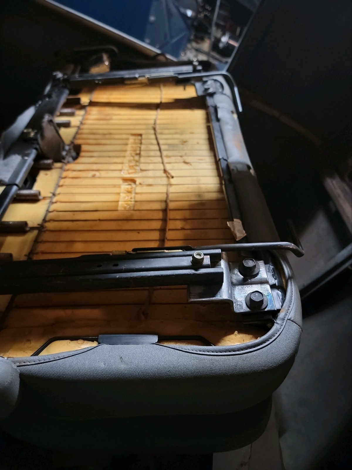

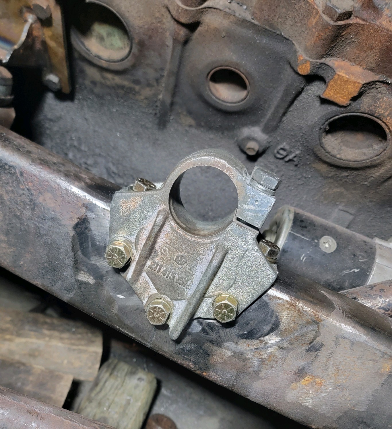

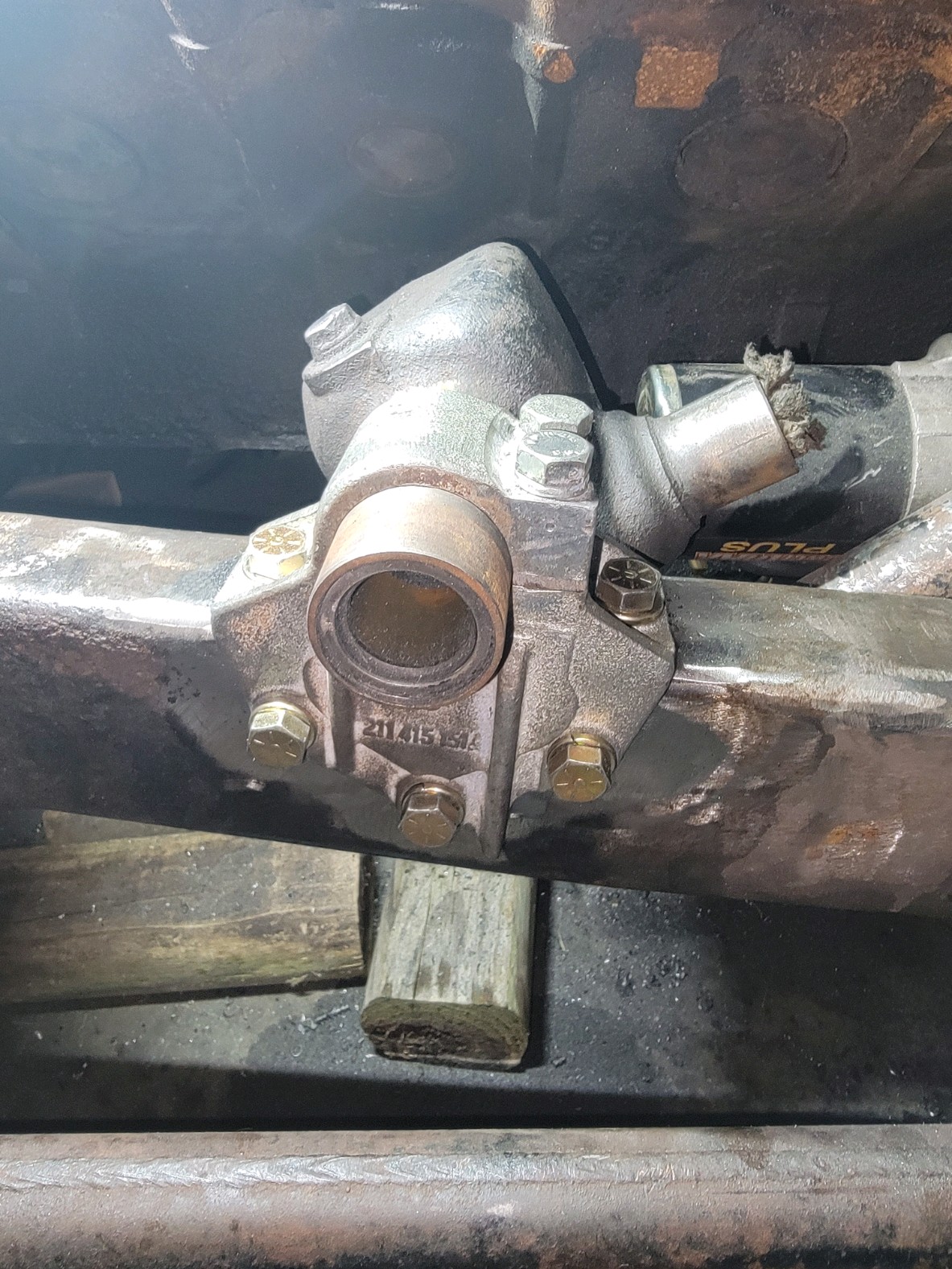

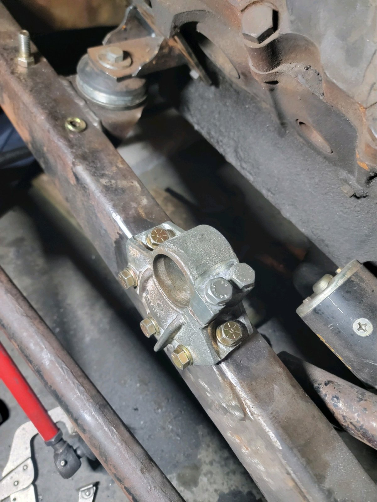

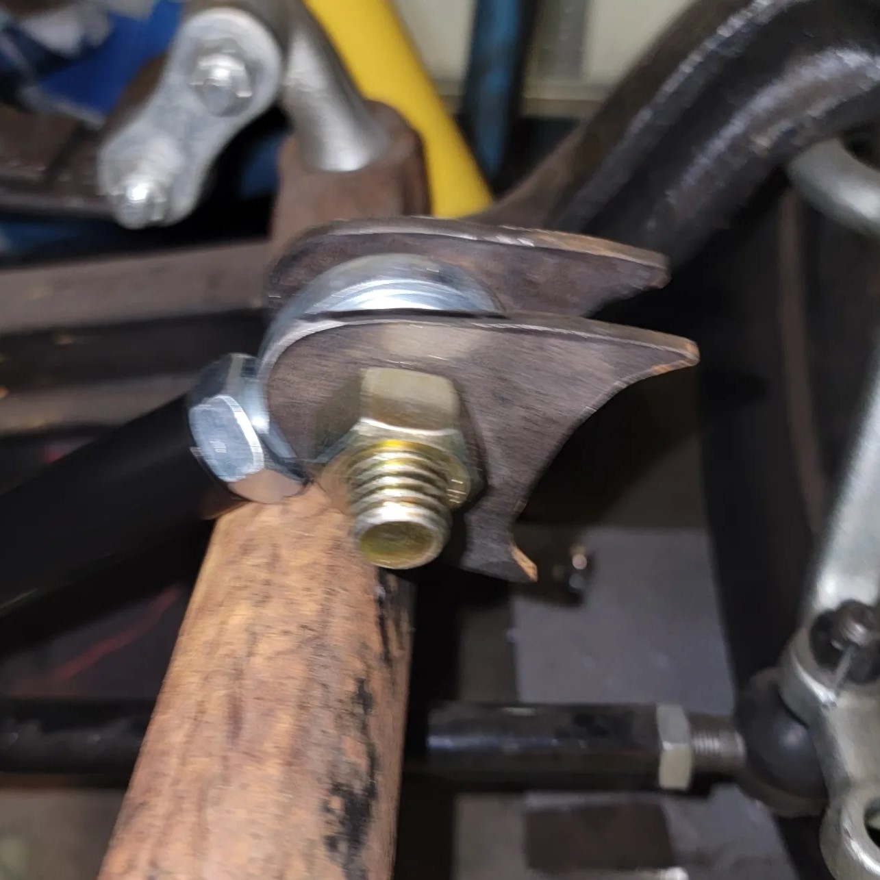

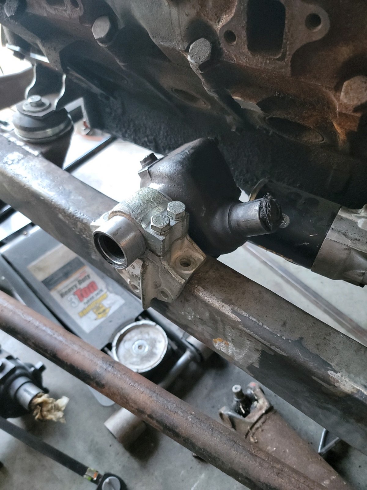

    well still knocking stuff out. Got a couple hours in the garage last night so got the f1 steering box mounted up with 60s era VW bus steering box bracket. I would've like to have it sit a little closer to the fire wall, but with the starter being on the driver side this was the best solution I could come up with. Next up we will mount the seat so I can set up final mounting spot for the column and wheel.

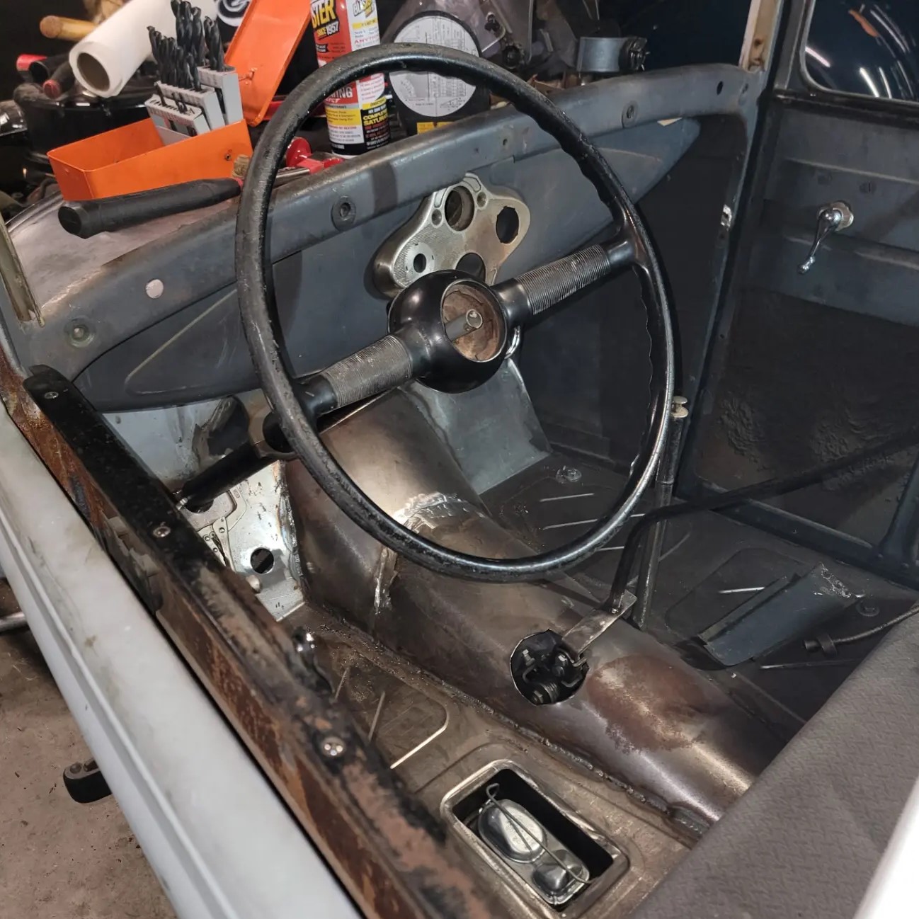

    Spent Monday making upper rear shock mounts and getting steering column cut down to size and hooked up to steering box. I need the wheel.to come down just a little more.

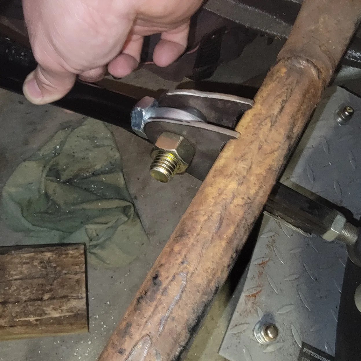

    Pitman arm is done now to cut drag link down and get that on there might have to heat and bend steering hoop but we'll see

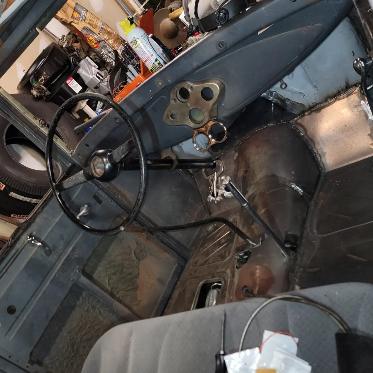

    Well got some more knocked out. tried using a stock column drop ,but was to much drop so had to fab one up for the amount I needed. Just need to shape it alittle better and it will work. Made an easy bottom column mount aswell. got the pedals heated and moved to allow room for gas pedal. Ordered new carb so will be swapping old 2 barrel out for 4 barrel. Took measurements for radiator so if anyone has a shop they know of that does custom radiators please let me know

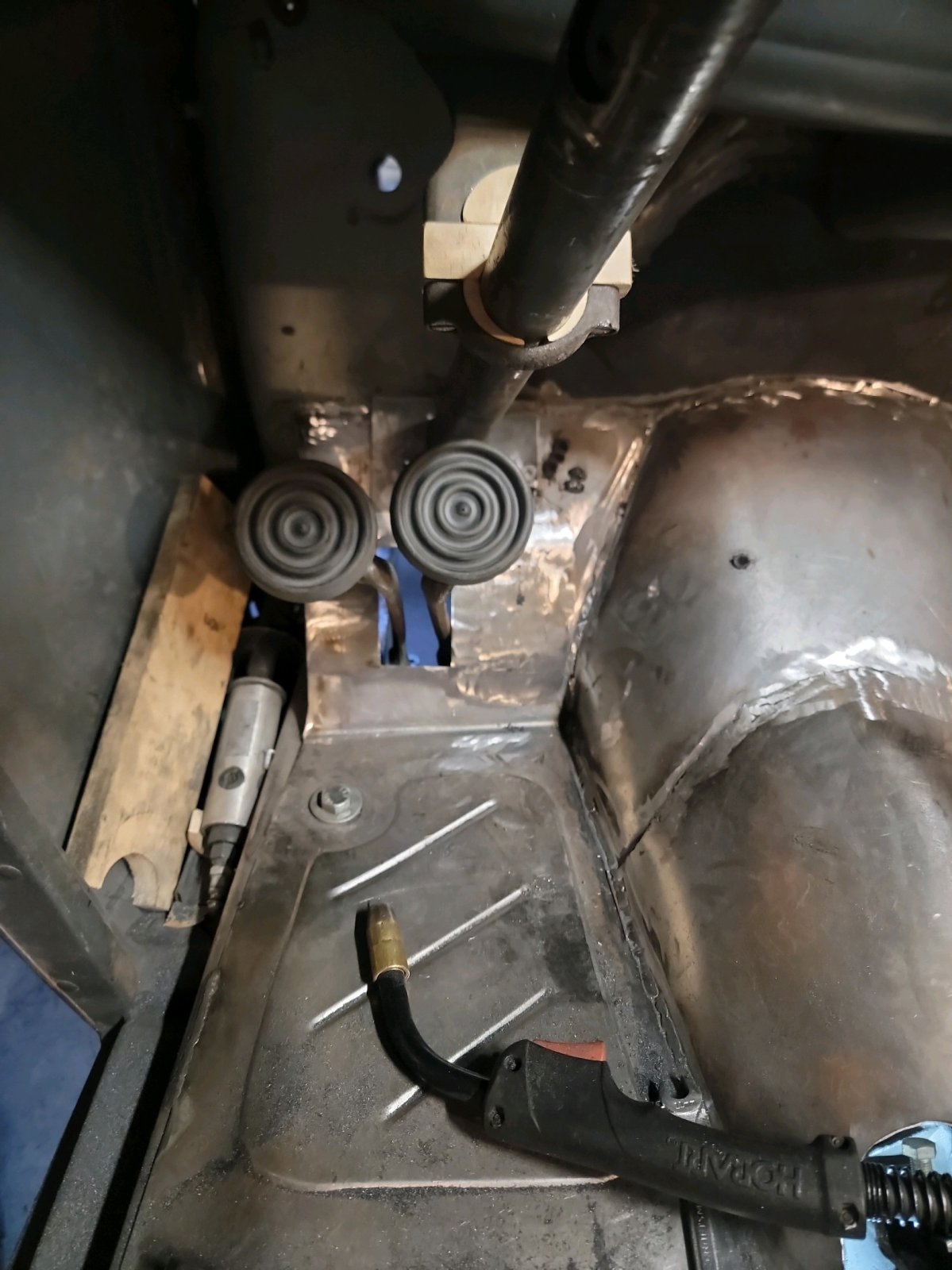

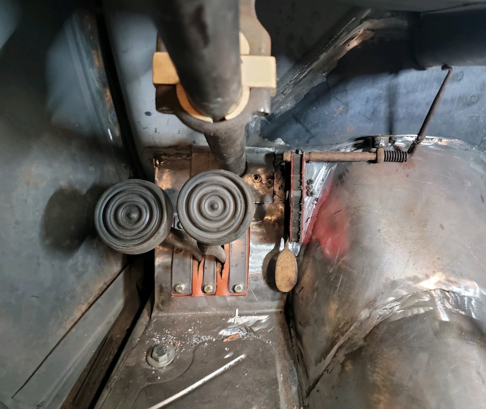

    Well I'll have plenty of room for s**** pedal. got the pedal gasket mount bolted im place. Didn't care for the shifter I made ill try again but for now I just heated and bent the hurst shifter to fit what I needed it feels nice too 196699.jpeg IMG_20230605_214743_611.jpg IMG_20230605_214743_680.jpg 20230606_093003.jpg

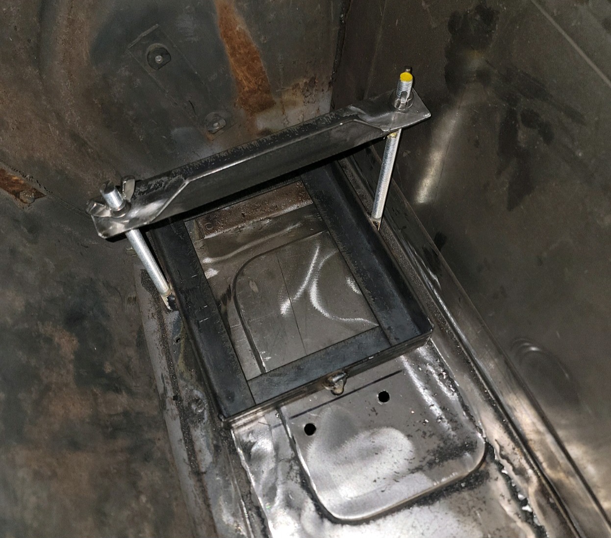

    Well battery tray is done for the 30. Just enough room for it and the rear tank. Other holes are where the tank mounts

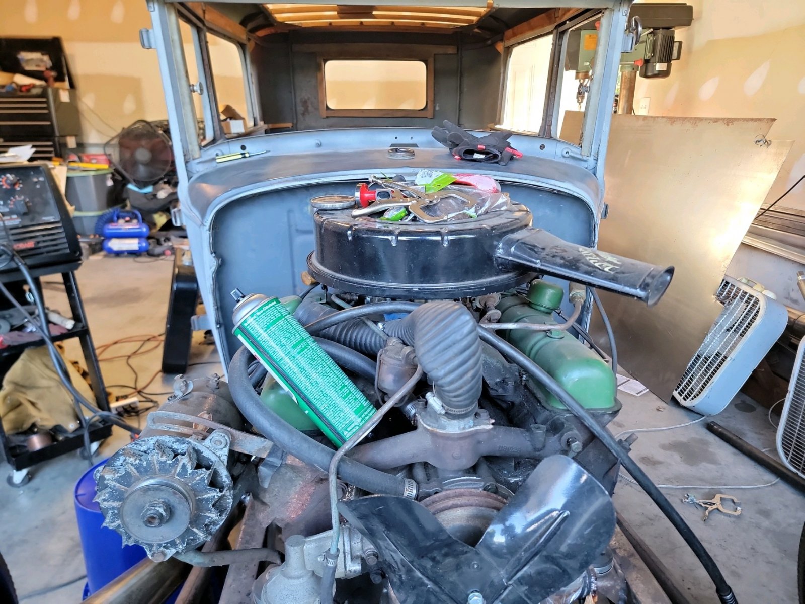

    Well we have pedal action now!!! Swapped out the two barrel intake manifold on the 364 nailhead for a four barrel with new eldabrock carb. Got pedal located and linkage set up. Im still on the search for some tudor drip rails if anyone knows of a set Screenshot_20230710_082822_Video Player.jpg

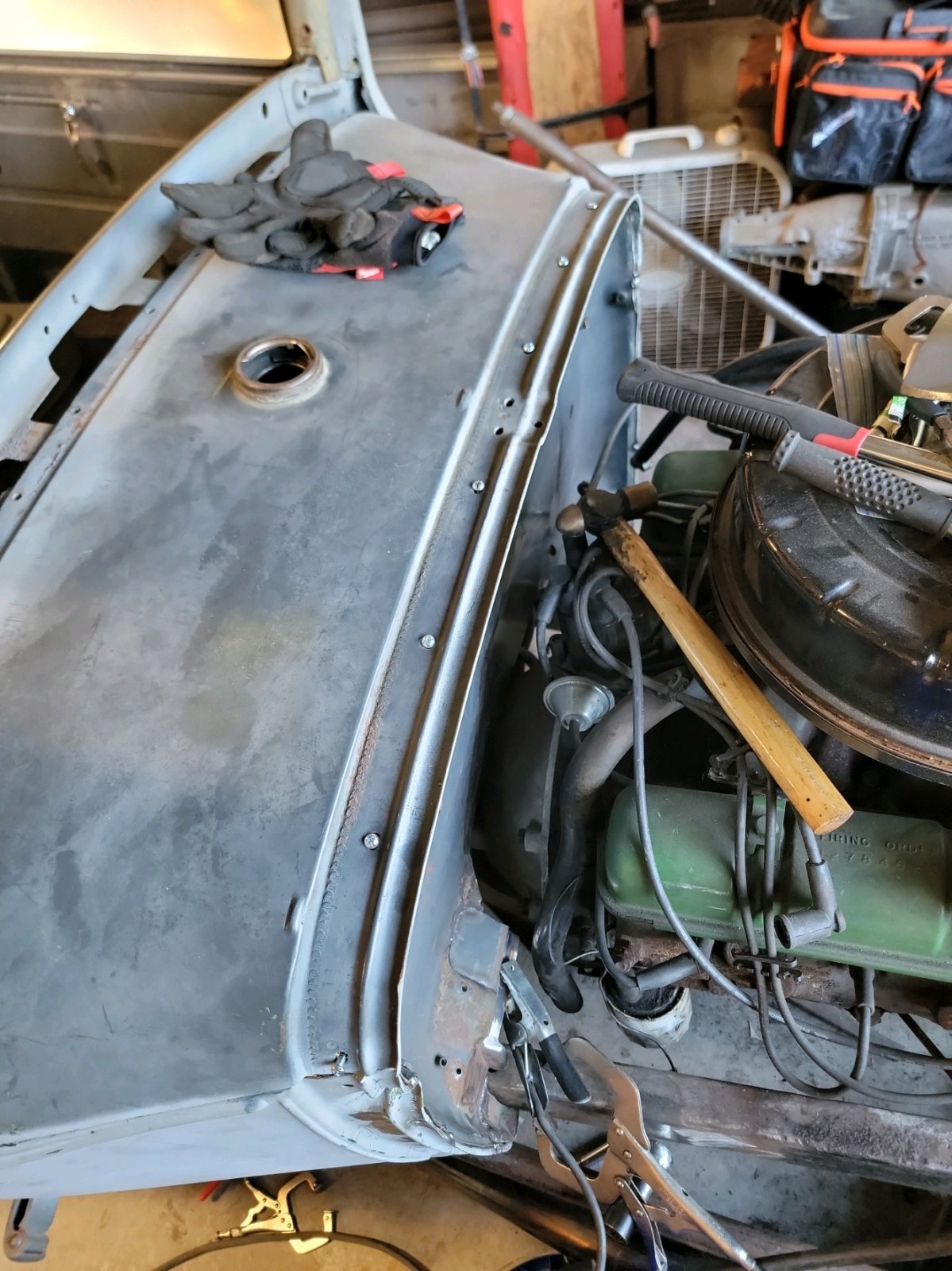

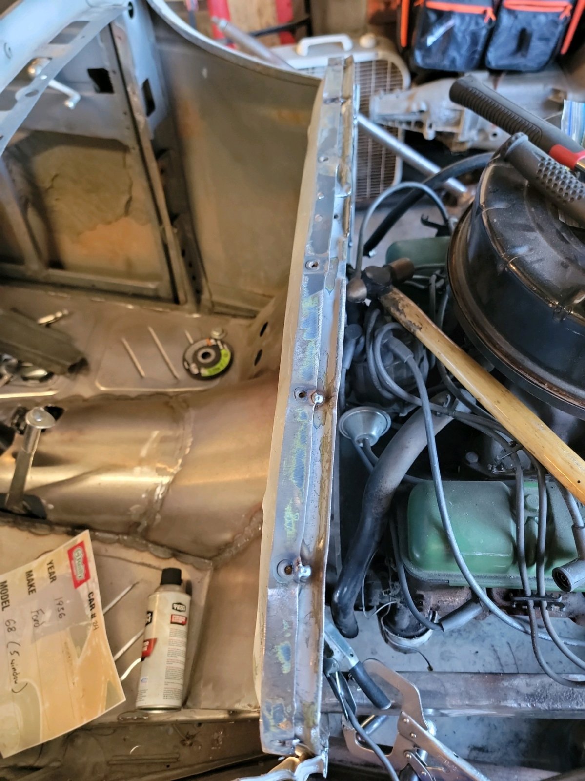

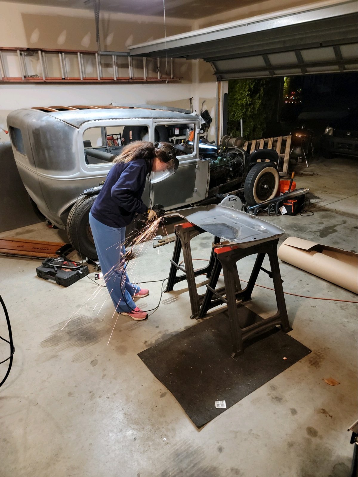

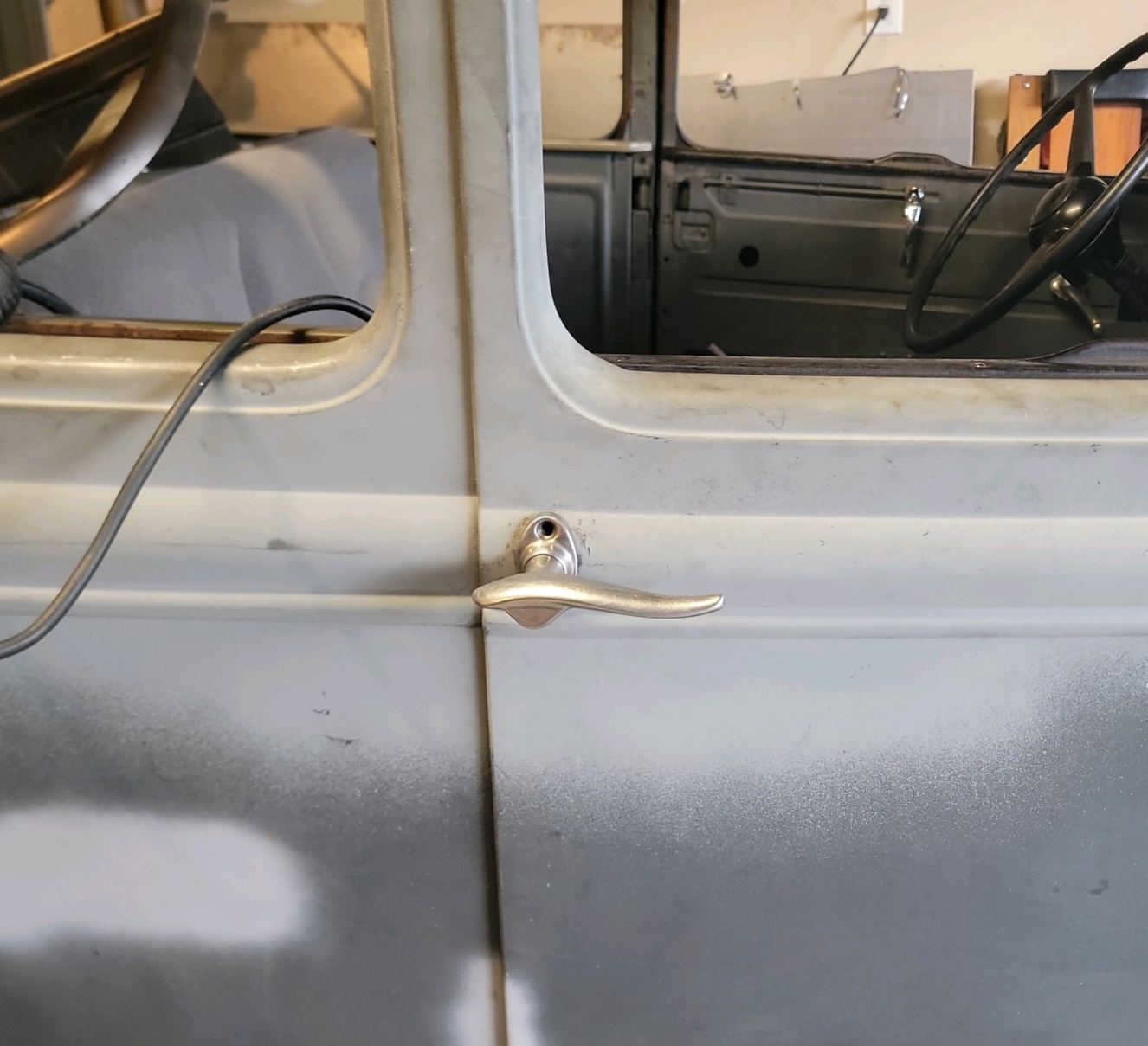

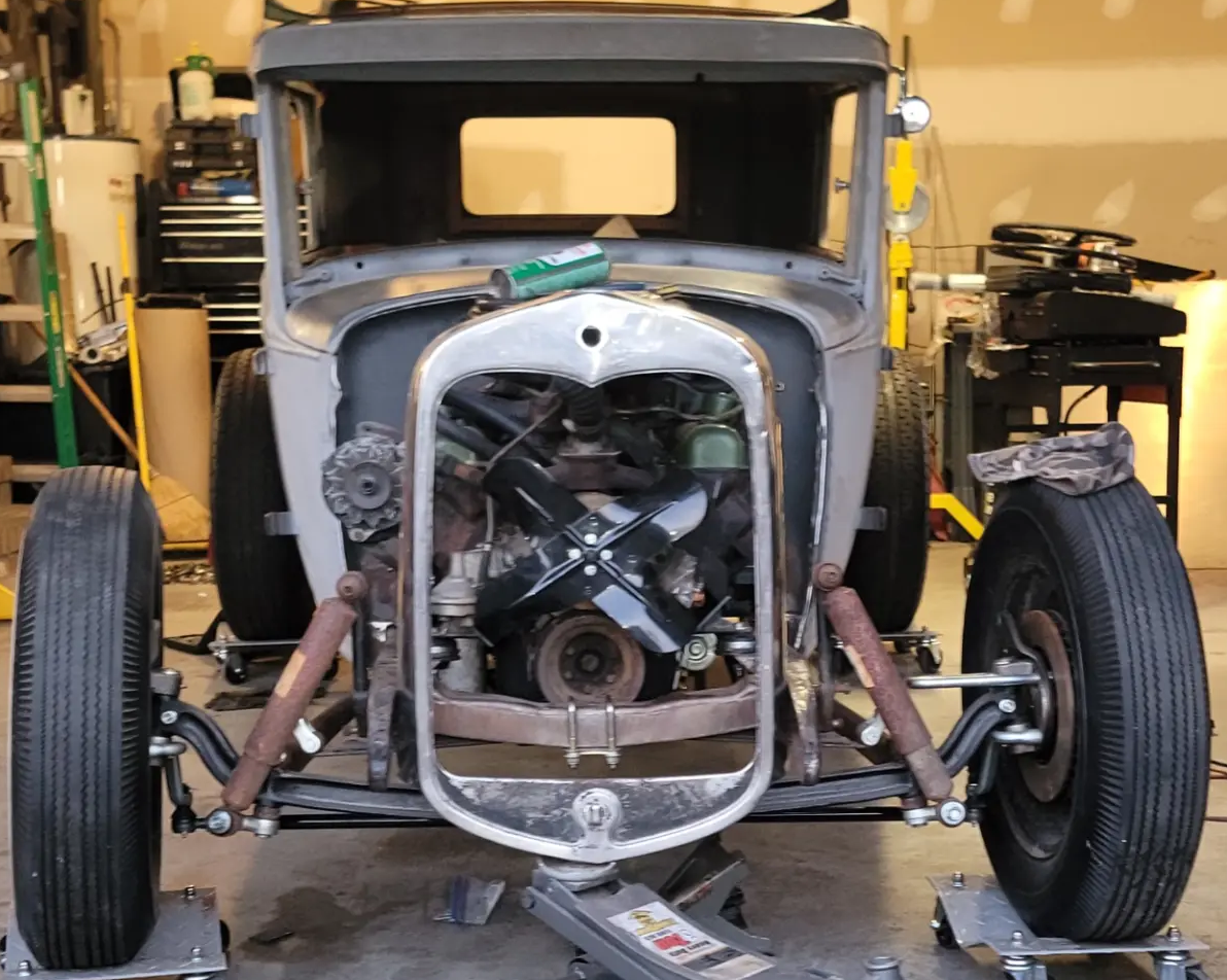

    Been bust couple seam sealer on the floor, put some body filler in some of the parts I had to work on, got the front pan hard bar welded in. Took the old ****py grill shell and cut 5in out of it to make it flow with and not sit down near axle plus never chopped one

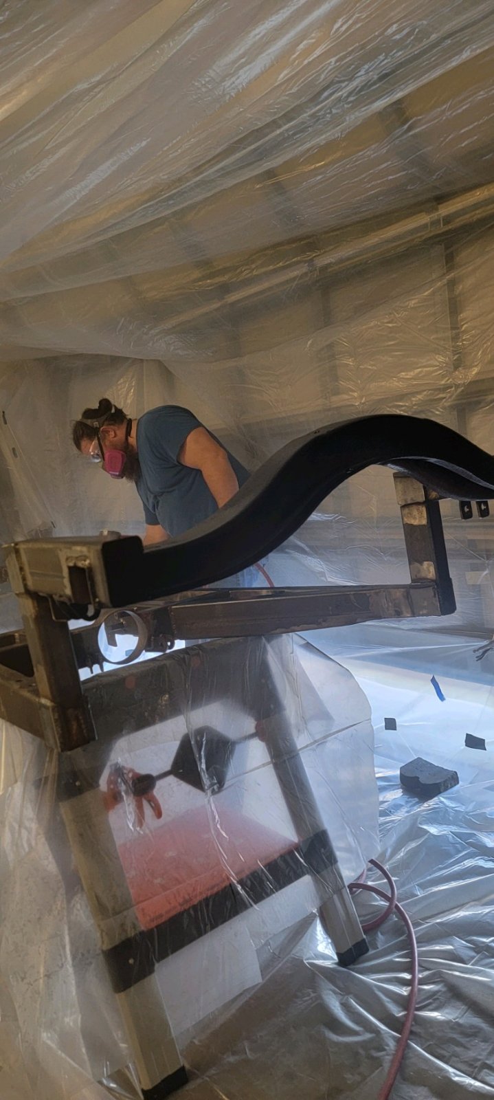

    Well been a solid push to Get this Damn thing done its only been 10 or 11 years lol but definitely worth the wealth of knowledge learned throughout it. We dis***embled and set up a make shift paint booth. Never painted a day In my life but we have paint being sprayed!!!! Im sure ive missed some pictures and steps along with dis***emble 20230923_220454.jpg IMG_20230923_221730_870.jpg IMG_20230923_221730_927.jpg 209298.jpeg 20230924_184052.jpg IMG_20230924_212255_651.jpg

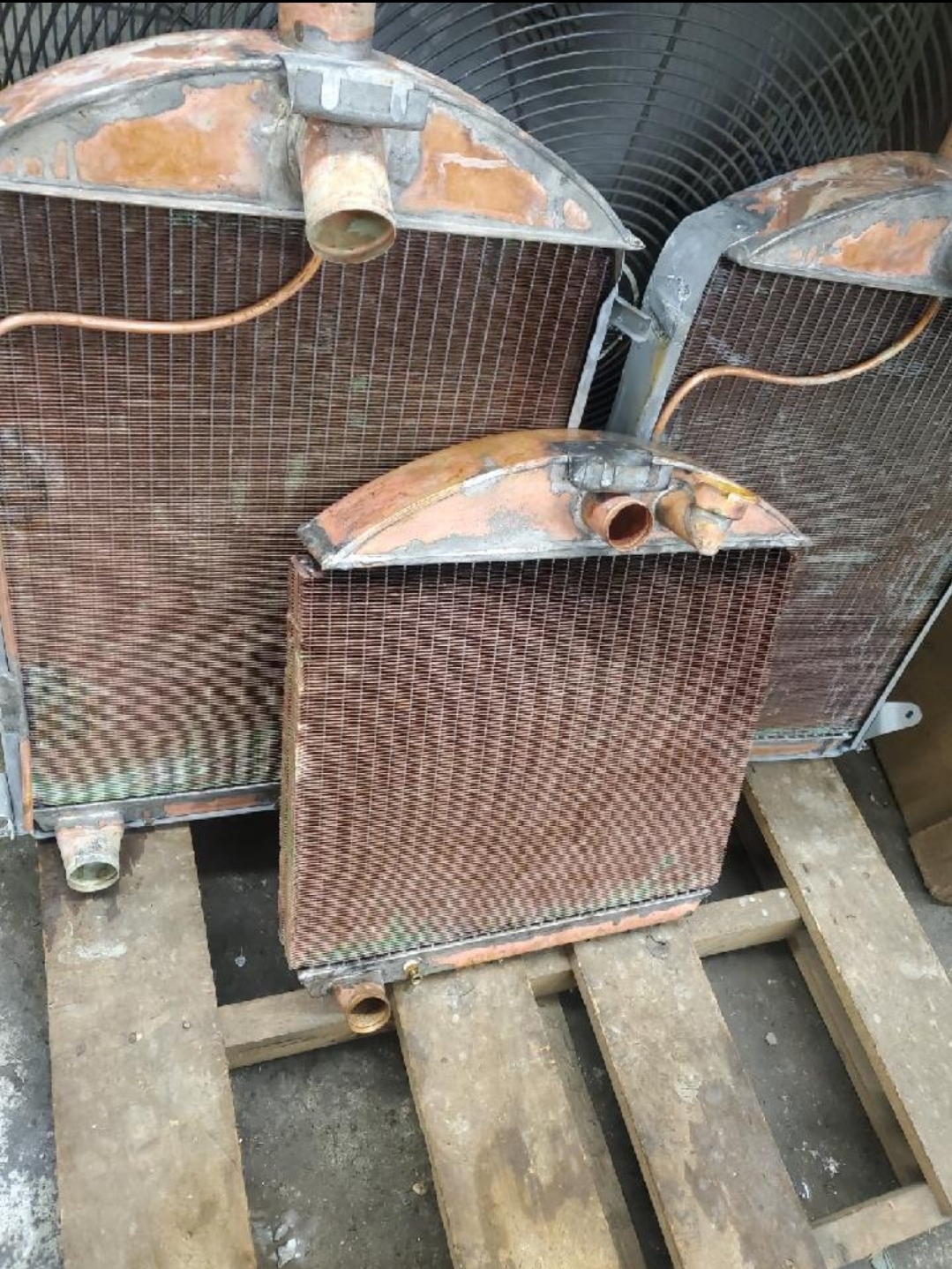

    Did you get your radiator problem solved?

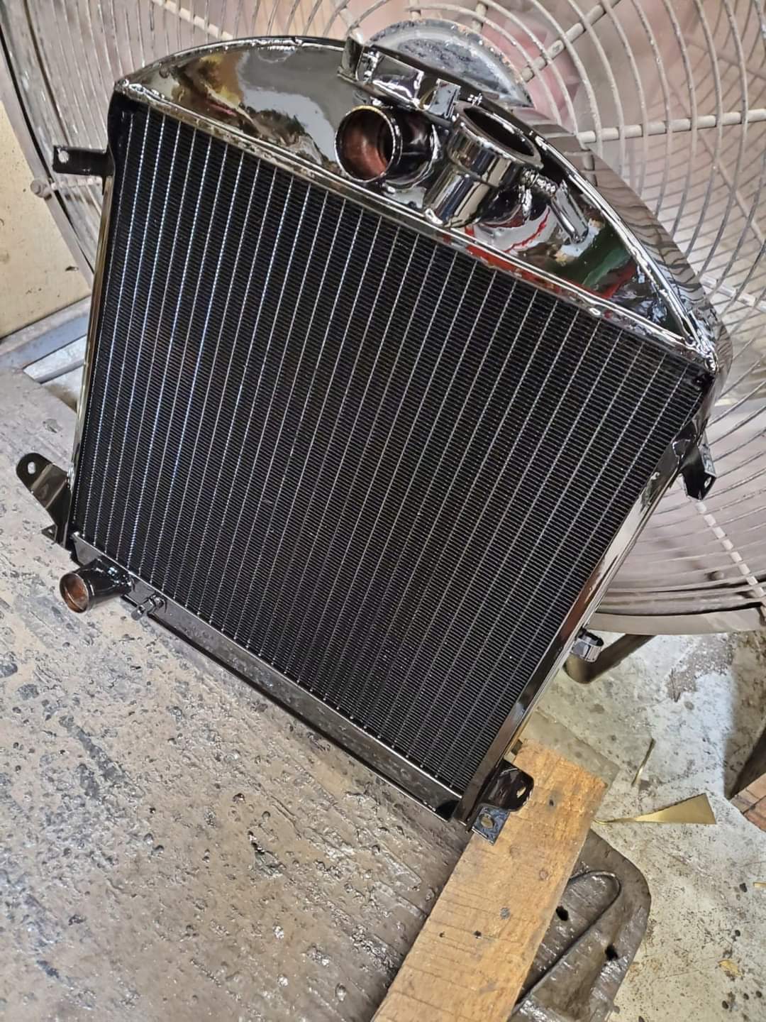

  27. Mechman_22
    Joined: Mar 18, 2014
    Posts: 215
    Mechman_22
    from Nc
    Yes sir had a custom radiator made. Believe it's 20in tall, was made by
    independent antique radiator out of illinois very happy with it as it was a complete custom build l. Great communication and kept me up to date on build until I got it at the house

  29. atch
    Joined: Sep 3, 2002
    Posts: 6,406
    atch
    That's a good lookin' radiator.
    These folks?
    Independent Antique Radiator Manufacturing, Inc. - Algonquin, IL - Automotive Heating Equipment (industrynet.com)
    Looks like there was a lot of communication about dimensions and tab/filler/inlet/outlet locations. How did you do that? Did you have to send them detailed drawings?
  30. Mechman_22
    Posts: 215
    Mechman_22
    from Nc
    Yeah I believe that's them. Yeah I had pulled measurements and sent him the details. He builds alot of old style so wasn't to bad just really short
