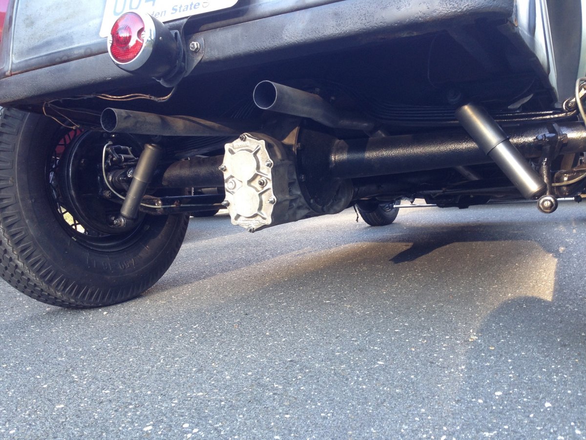

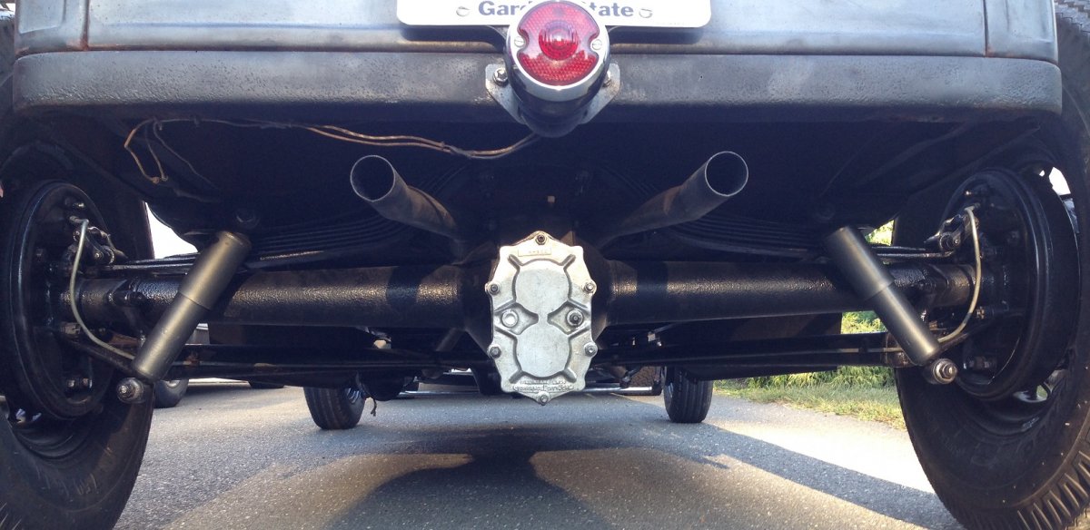

    Halibrand quickchange installed and set up by Andy at Kohler Kustoms. This guy just gets stuff done and done right. Can’t say enough about him. Ended up going with a final ratio of 3.20, reversed eye t spring with tube shocks in the rear. Car cruises great and I’ve been racking up the miles. Working on a few things this week and then will be ready to run her down the sand next weekend.

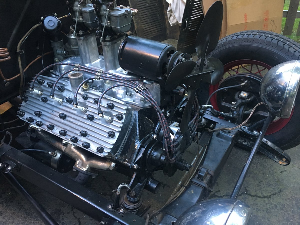

    Needed motivation to put the new engine in so 2 weeks before TROG 2018, I pulled my old engine. Ran decent but was smoking a bit and was a little low on power.
    Got the weiand goodies (high rise manifold and FR heads) on top of new short block, installed eFire destributor and put it all back together.

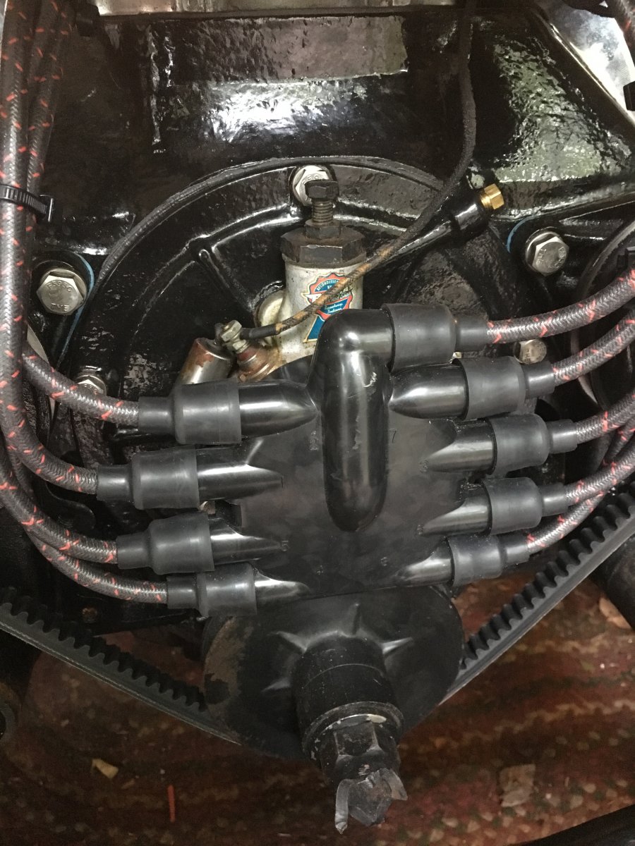

    After the race and driving around town, my ignition was kicking in and out until it just let go. Thought it was coil and chased the problem around until I figured out it must be the new eFire distributor. Pulled the cap and the wire were fried. In the early versions of the eFire, they didn't have a clip to hold back the wires and if you pulled them tight they would rub on the rotor. Put the stock distributor back in and the Stromberg guys refurbished my distributor. Took a little while but they stood by their product. It's been a few years and I haven't put it back on yet.
