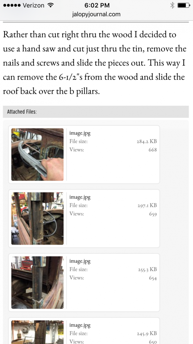

    Here's one way to chop without cutting thru the wood.
    Hot Rod Brando likes this.

    [​IMG][​IMG]i did mine the same way Pete did. Pull the nails, cut the metal , lift off the roof trim and reshape the wood then put it back on.

    onecoolkat1950 does show the "best" overall way.

  15. I really like that way. Next time I have one with useable wood in it I'll be going at it that way for sure.
