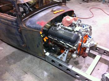

    The motor and trans are bolted in. Wasn't sure how the suspension would react to the rat motor, but it is just fine, thanks.

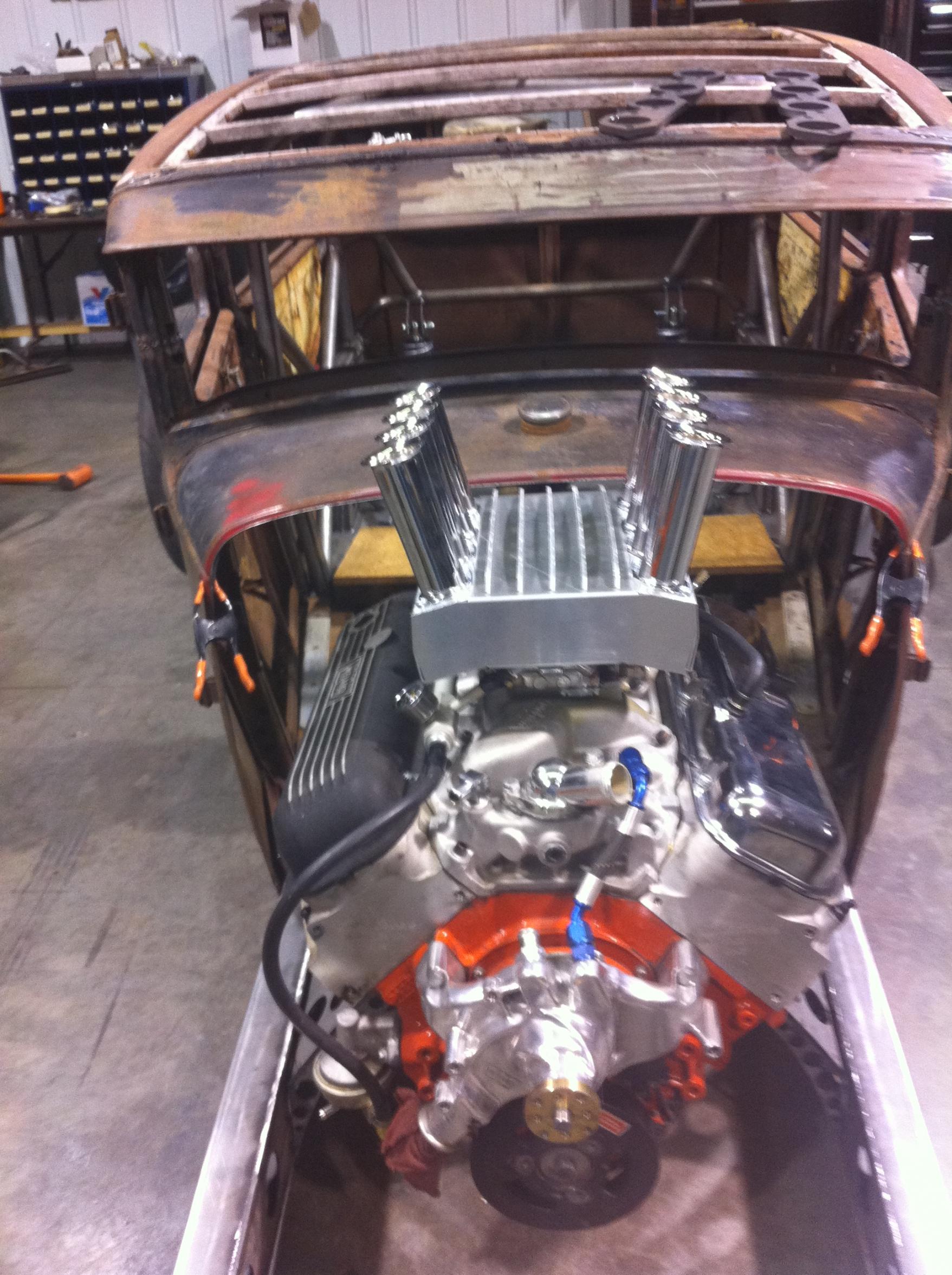

    This motor was dyno tuned, so I don't want to change the induction system. I also don't want some boring-***ed single four barrel sticking out like a sore thumb. I fabbed this airbox out of .090 aluminum and bought some 6" stacks that fit on Weber carbs. The box will be crinkle black powder coated and the ribs on top will be exposed aluminum so that they will match the valve covers.

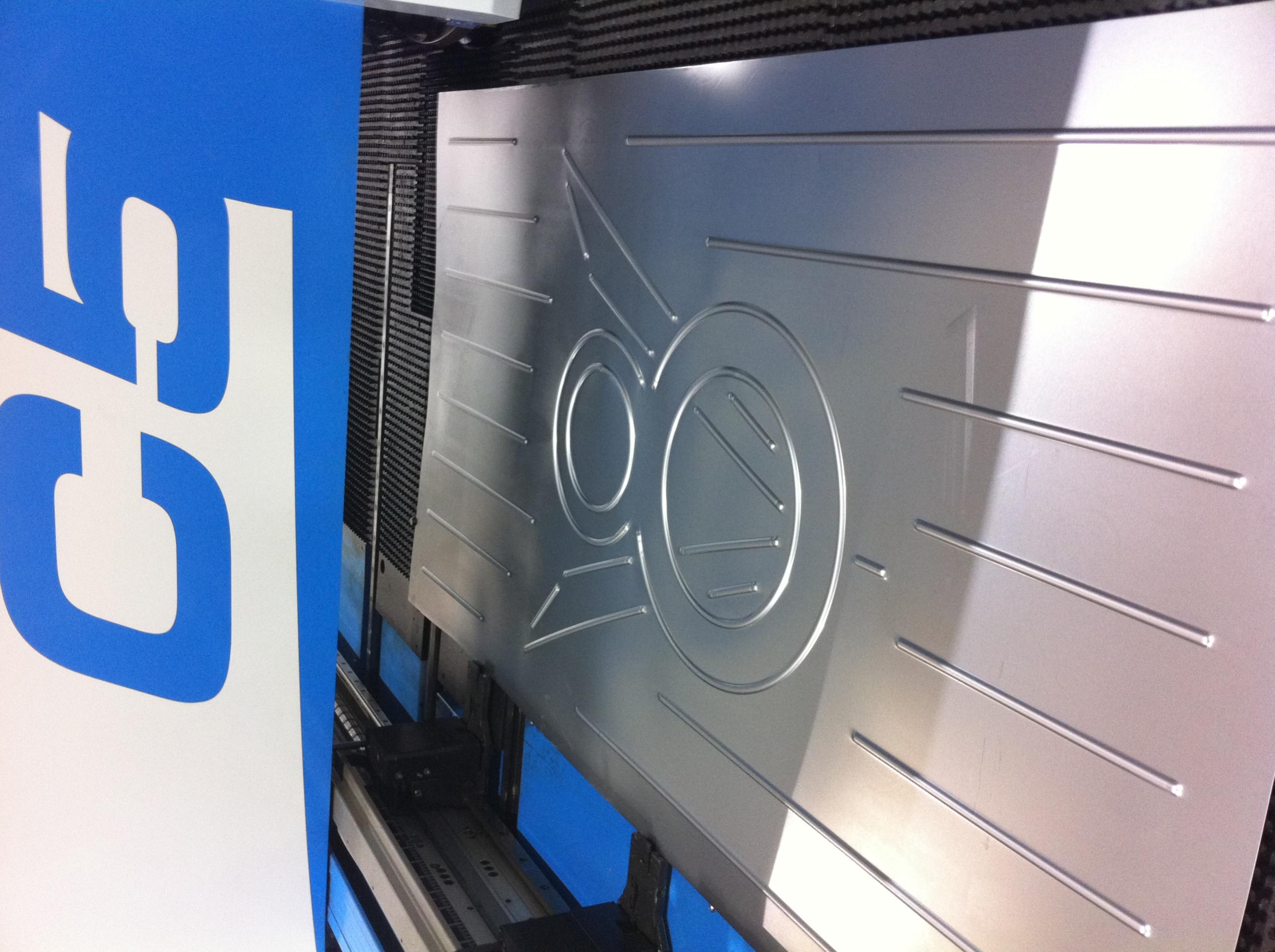

    I used my CNC turret punch and a rib forming tool to make this unique roof panel.

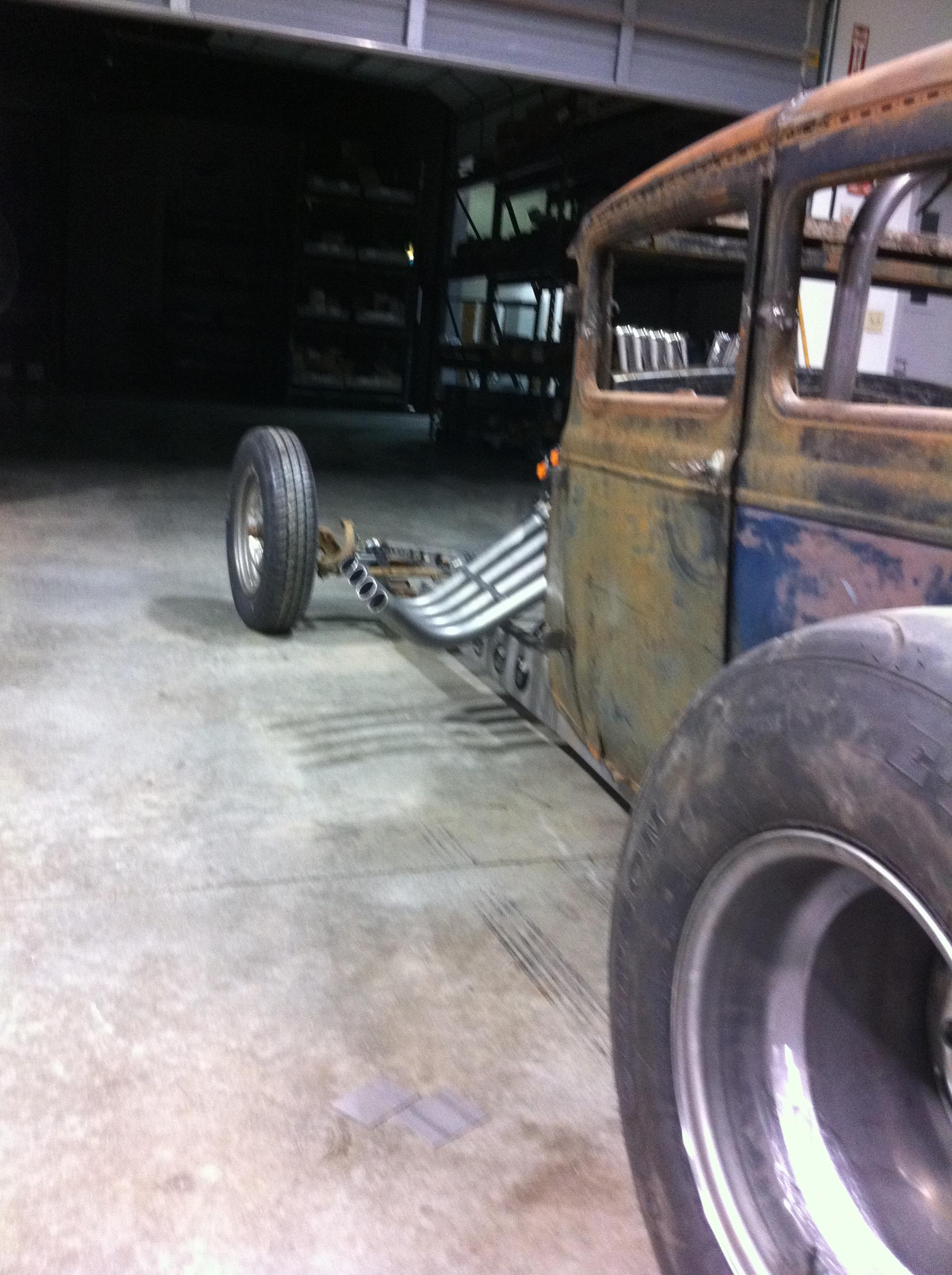

    Just finished the zoomies.

    I really like the roof insert and the zoomies. I really like the work you are doing and hope you go to the HAMB drags. That wrecker looks amazing. Keep us updated , I really enjoy watching what you are doing.

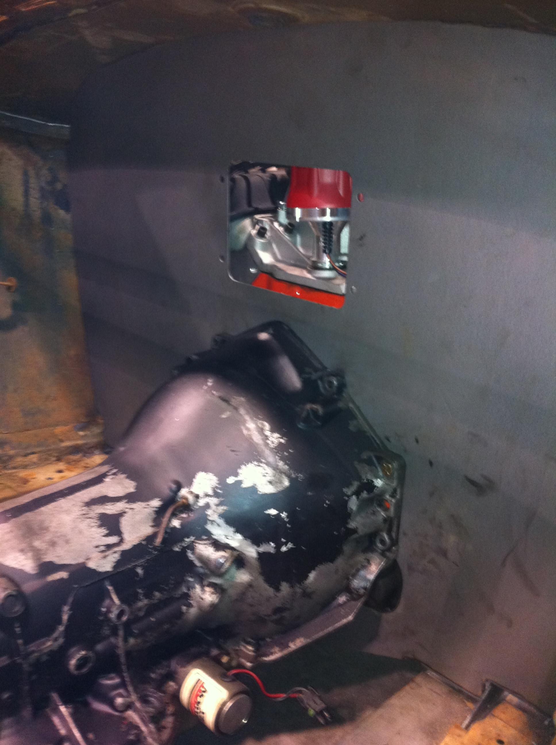

    More pics. Worked on designing the firewall/motor plate today. Two hoops under the cowl will support the firewall, cowl steering, and reversed master cylinder.

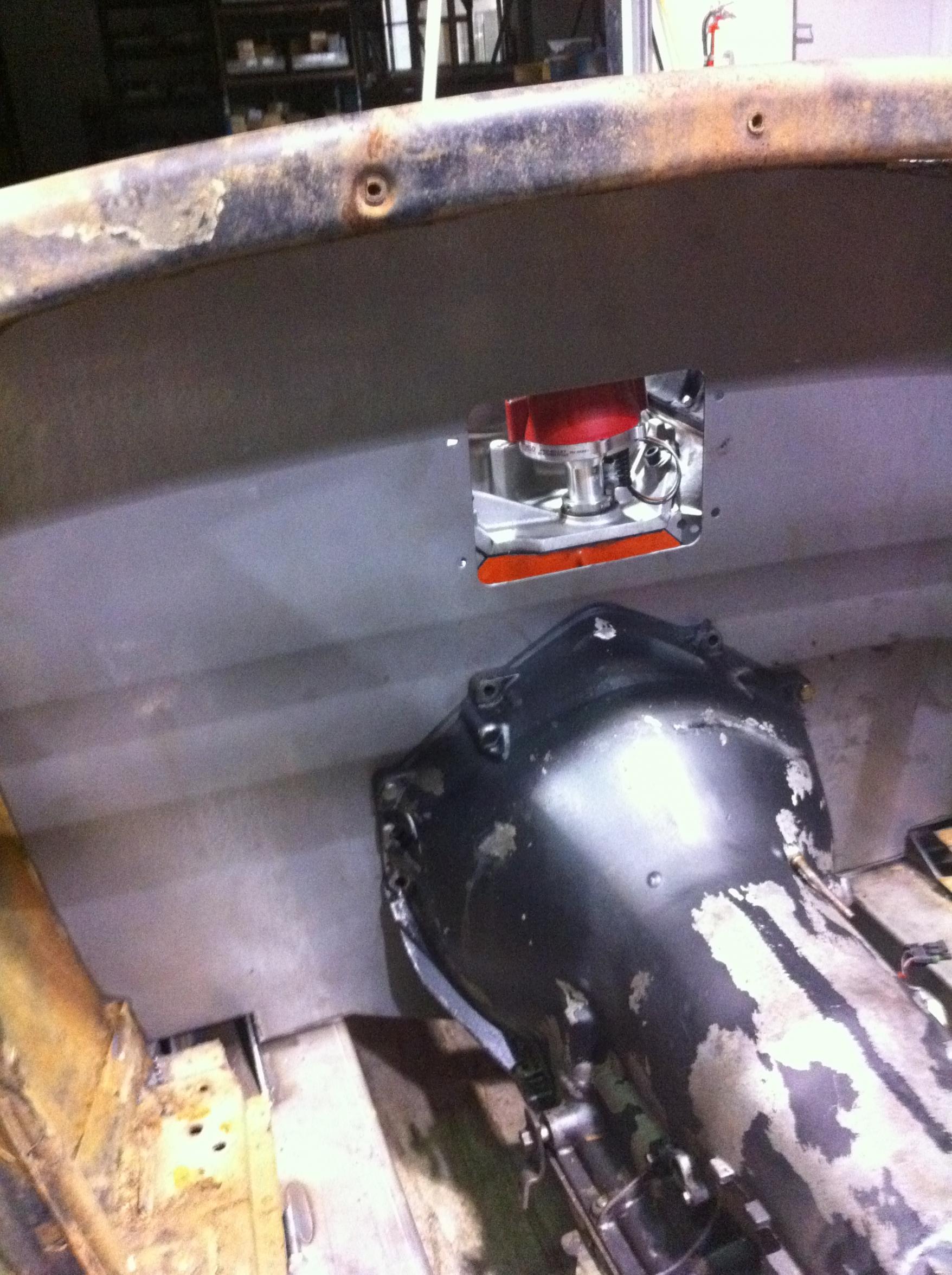

    Firewall/ midplate is in. Combined with the two hoops that will be under the cowl and the door bars, she should be pretty rigid. Floor/ seatpan is next.
