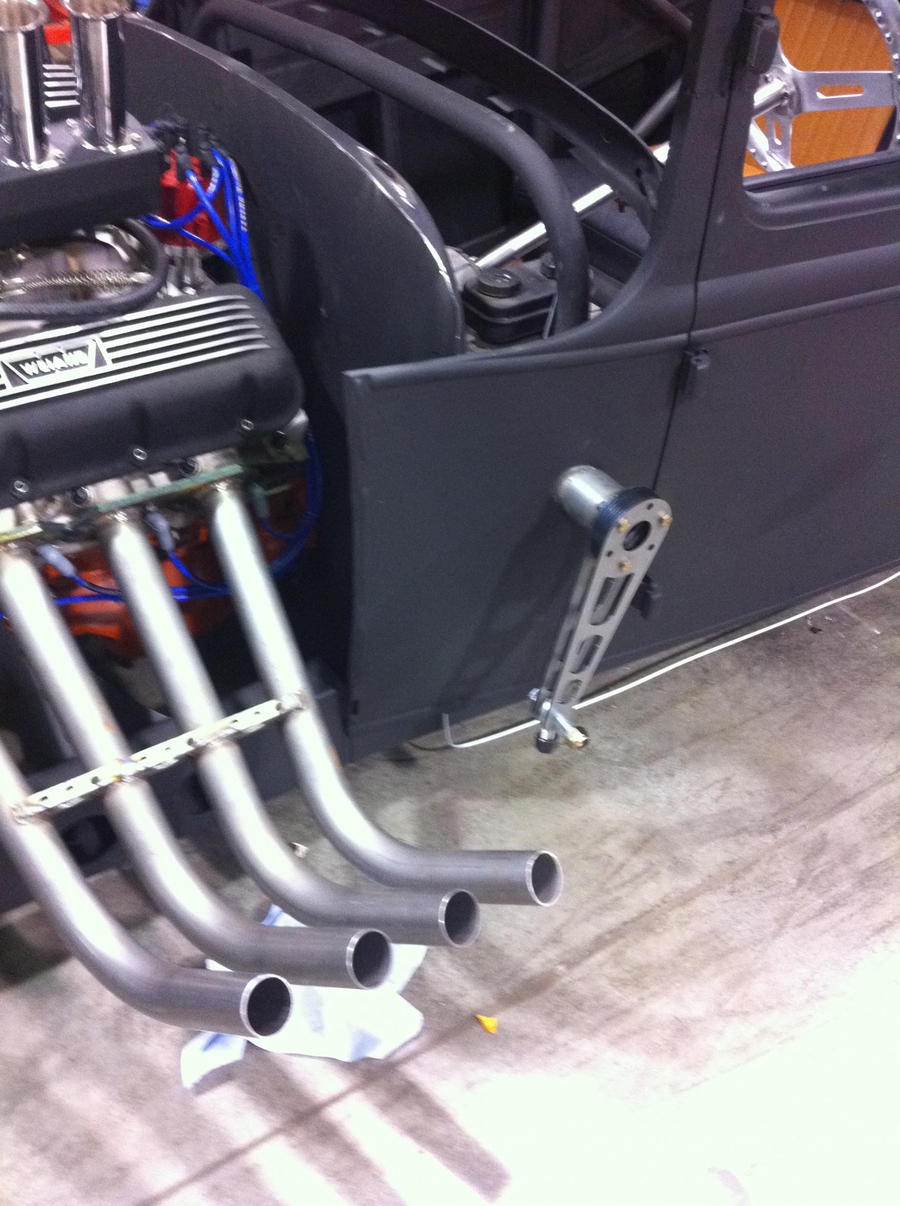

    Big day today. Started the motor because I couldn't wait to hear what the zoomies sounded like. Nice.

    MAM, yes, the steering wheel has a 10" section of column with a quick-release coupler on the end. I have tons of room to get in, and it feels cool riding in the back seat.
