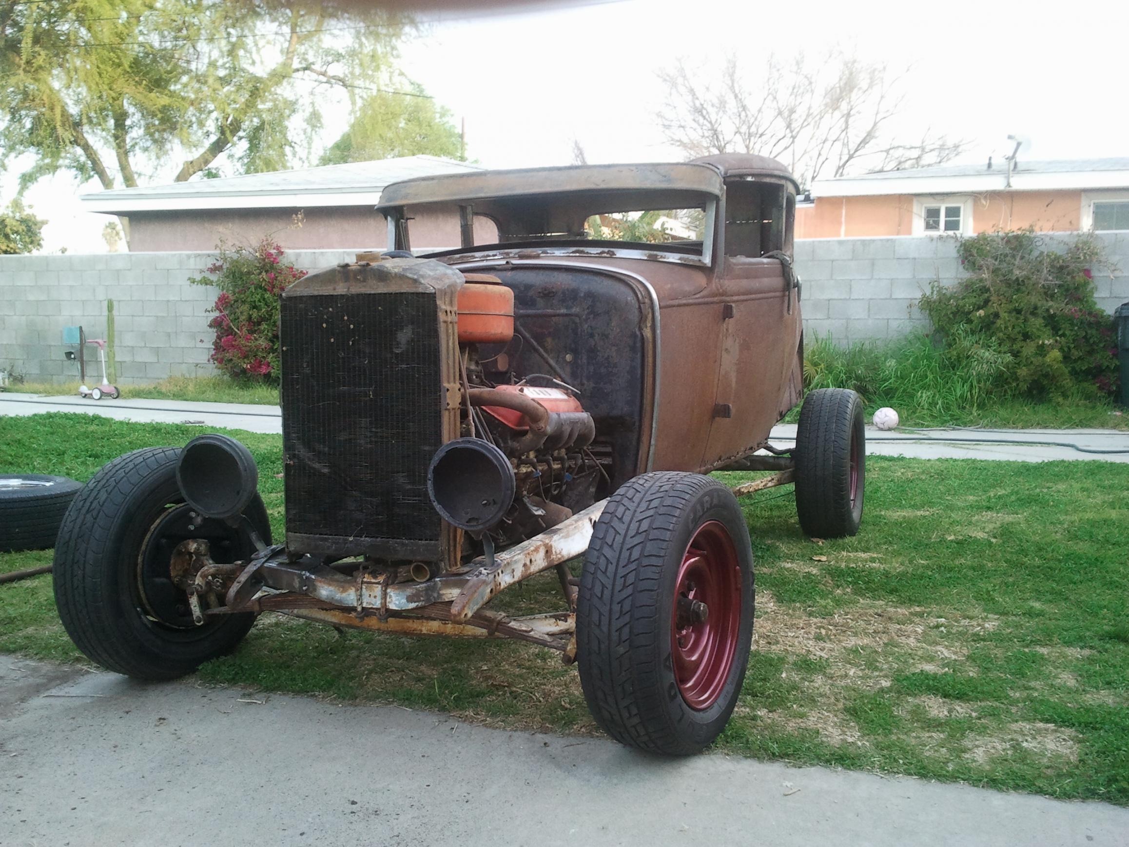

    Tom, sorry it took a while to get these for you. The pictures below show how much you would have to scoot the cross member forward to use the spring in front as the bones are made. I'm going to cut the spring mounts off and use a spring over axle as is shown. One other thing I noticed was the angle of the spring mounts if you mount the bones to the outside of the frame. You're either going to have to put a bend in the bones, or bend the cast iron spring mounts back so that the spring shackles line up. Also, here's a mock up of how I'm getting past the mounts blocking the stock steering location on the Model A frame. Once I get them measured out correctly I'm going to put some gussets above and below the mounting arm to make sure it's nice and solid. Also, I'm going to cut the lip on the cross member down to match the smaller area so I can move the block up another inch or so. Hope this helps out some.

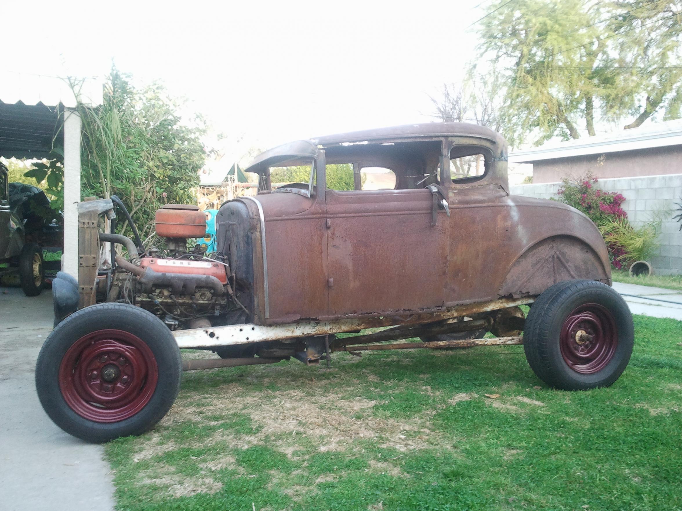

    Same ingredients 30/Y/40. I cut the crossmemeber into 3 pieces put it in front of itself & made "extentions" connecting it back to the frame on the sides. I hate drilling out rivets plus it leaves locators on the frame. Has a great oldtime look, untouched firewall, radiator will move a little forward onto the new extentions. Steering box will lay on top of frame with forward steering.

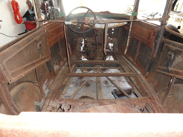

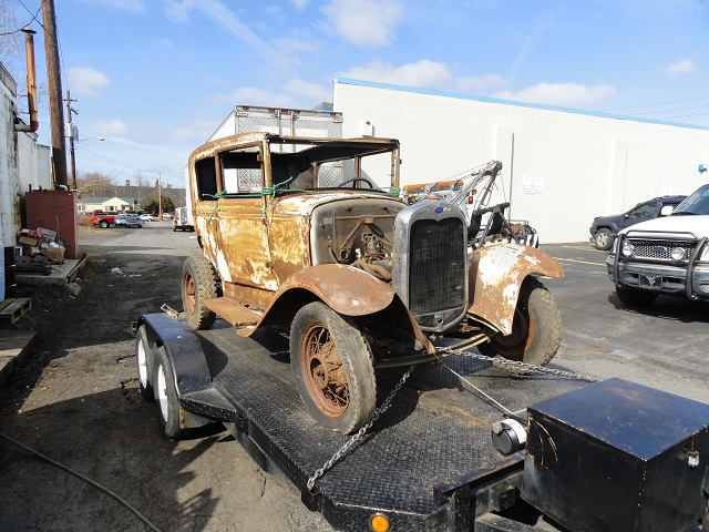

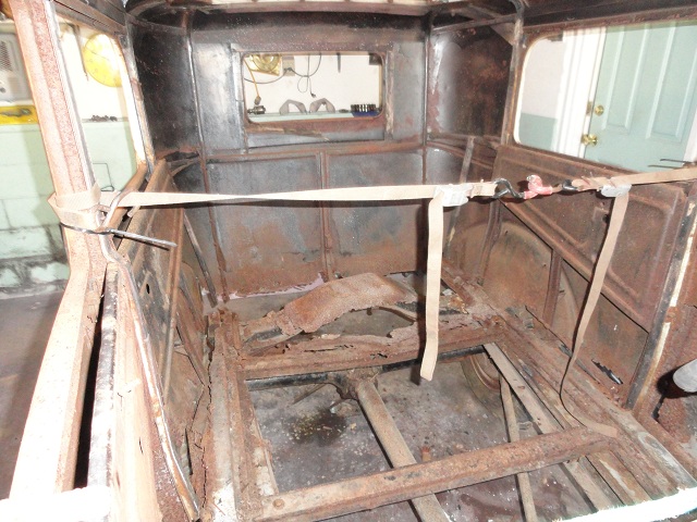

  18. So I learned how to post pictures, and here are some. This is when I was loading it up and just after I got the fenders off and got it in the garage. since these were taken, I got a subframe built so the body is in one piece and the doors open and close.
    Thanks for the help so far.
