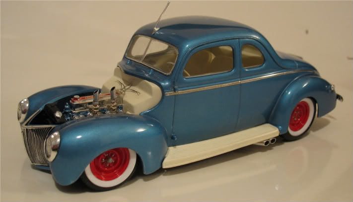

    Here is a shot of a plastic model with a chevy 6, looks like they modified the firewall to make it fit. That should work for the 300 Ford 6 in a real car to do that as well. Start at the radiator and work back.
  3. X38
    Joined: Feb 27, 2005
    Posts: 17,498
    X38
    I wouldn't be taking a plastic kit as full size evidence. People have enough grief with SBF's, let alone a big I6. Apart from that, break out the tape measure and start measuring.
