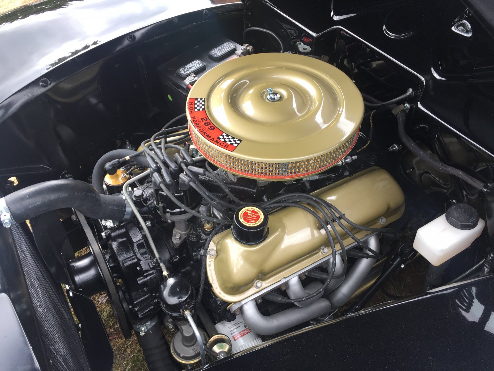

  2. C022B333-2E41-4468-A760-99D03D58C928.jpeg The deeper’41- up front crossmember to clear the “G” series Flathead six would help a bunch. I have several and they can be modified to fit the ‘39 frame.
    These deeper crossmembers are exactly what you need to avoid cutting the firewall on 39/40 Ford’s with SBF’s
