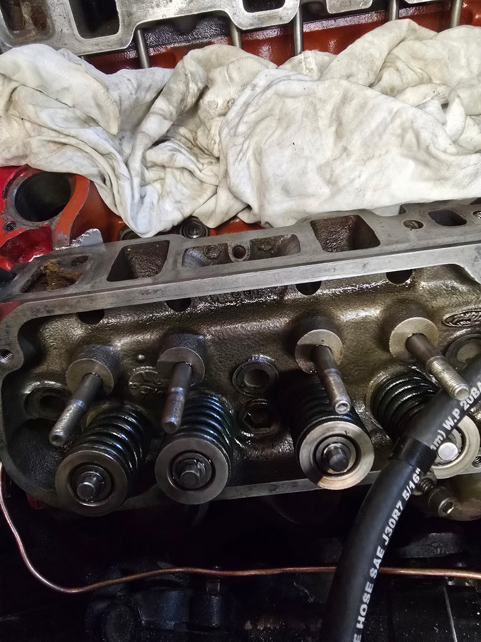

    We have a 72 Ford 302 that has a ticking lifter...it has rocker arm adjusting nuts that tighten all the way down (apparently) with no adjustment...however, looking on line, some guys say they are adjustable, others say they are just tightened down till the nuts bottom out...
    we took a 5/16 washer and put it under the adjusting nut and was able to take the ticking away...but are not sure what the heck to do...without the washer there is no way to adjust the valves to no lash plus 1/4, 1/2, 3/4 turn...like a SBC...
    this is the first SBF I've ever worked on, always been SBC or flatties...any help here from the Ford folks would be great....thanks Ron

    they are 5/16 thread with 3/8 into head 1585280248862531823.jpeg
  6. Put a straight edge across the studs and see if they are all the same height.

    do they screw in?
  8. Ford built small blocks with the ball-style rockers where you just ran the nuts down until they stopped starting in '68 according to a couple of sources. These weren't designed to be adjustable. There is some confusion however. My '69 factory Ford service manual does show an adjustment procedure for the 302, but the 351 had the positive stops. But if you're running the nuts down until they stop and then have to add a washer to eliminate the noise and the motor is running smoothly, it's a pretty sure bet that's what you have.

    If everything seems to match, I have seen lifters start to collapse or not fully pump up when the oil gets thin. That was a thing before the bottoms started tearing up. The tolerances between the body and plunger were too loose. I wouldn't swap lifters to check for obvious reasons, but you can try running the engine and using a hammer handle or wood dowel, lean on the pushrod end of the rocker to force the lifter plunger in and see if it fills up properly. A bit of dirt can cause them to stick. Judging from the picture, you are a lot deeper than that, though.
