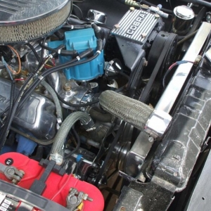

    Are you running this style HEI ? Mine likes 12-14 degrees advance. 1firewall (1).JPG

    No, I didn't have room for the large cap, using the small cap, module mounts on the outside of the base.
