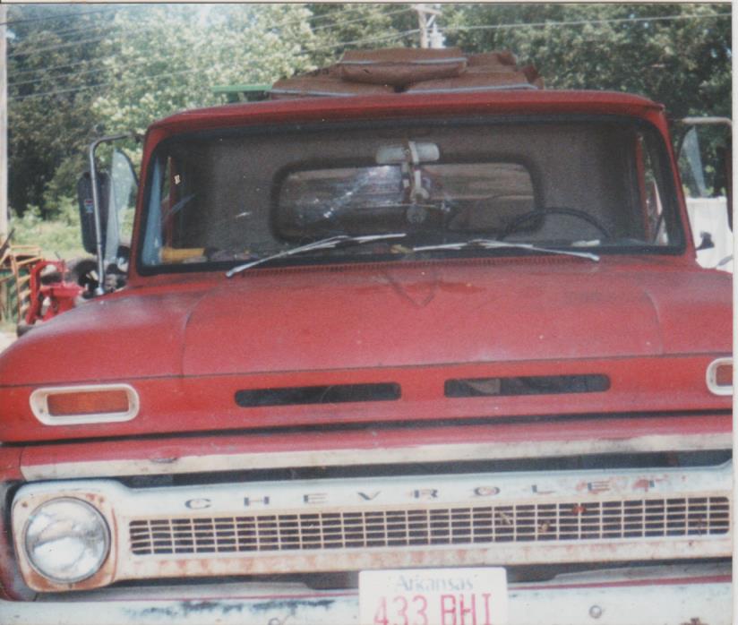

  1. My wife has a 66 chevy 3/4 that her daddy bought new. 292 six granny 4 speed and 456 rear gears. Its a puller but guzzles gas. I plan to swap the entire front suspension and rear end from a 86 60 thru 66 trucks 001.JPG dads truck loaded w feed.jpeg 3/4 ton under it. that way she gets disk brakes on the front and taller gears in the rear.
