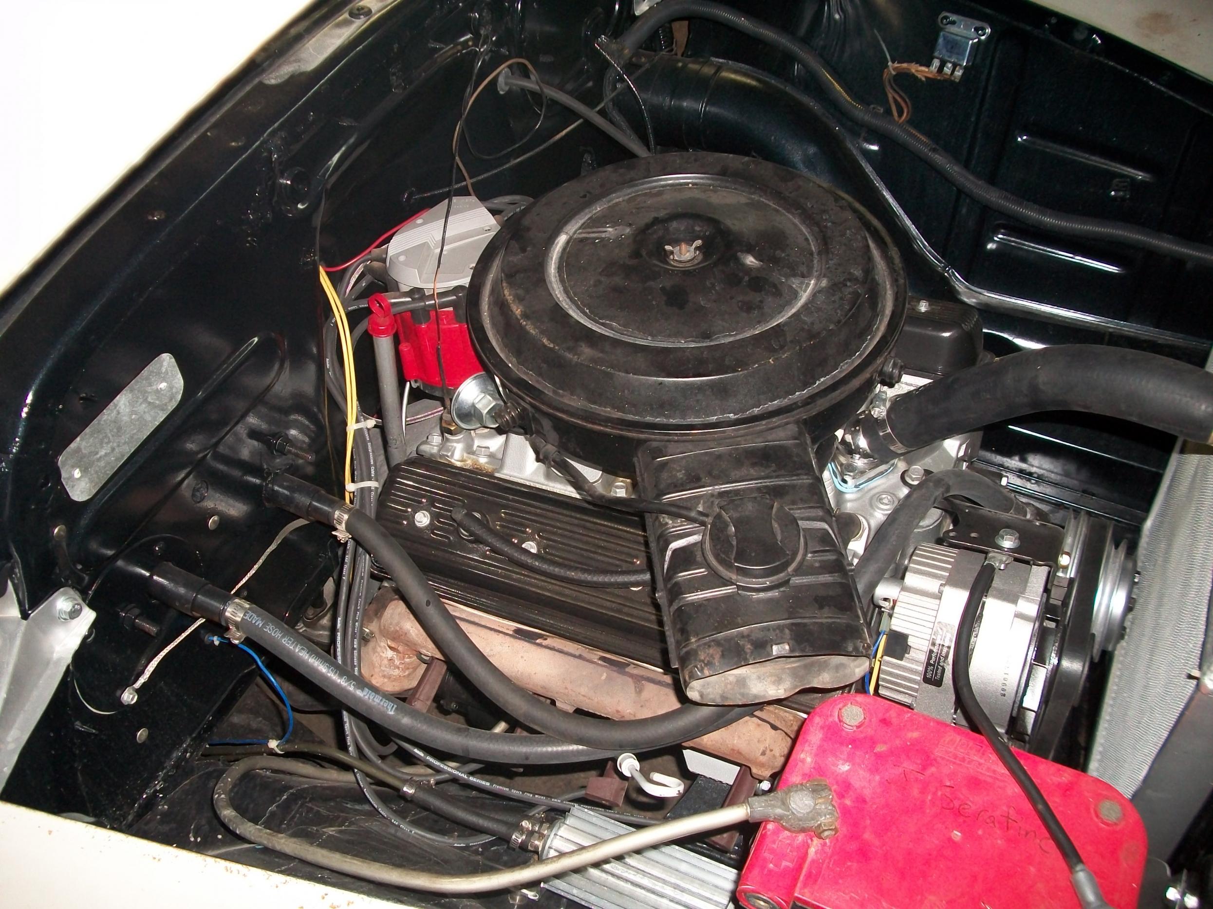

    I have one in my '37 Plymouth, plenty of power for me, I'm not planning on racing it.
