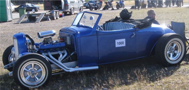

    Sorry little ot,but cant keep my fingers off from this talk.Here is my version from 1930 roadster with nailhead and´35 or´36 doors.Sad,but stock grill is gone,i dont have idea when,because first customizing happened in early ´50s.So i still have to go with Ford grill,but someday i will change it,and stance maybe coming up again.
  23. studhud
    Joined: Jan 6, 2006
    Posts: 1,403
    studhud
    Ok dont get offended the look of the motor doesnt thrill me but that back 3/4 photo of that is Bad ASS! Maybe a tripower would cure the front end?
    Dave Hitch
  24. motorpsycho
    Joined: Feb 3, 2006
    Posts: 45
    motorpsycho
    from Finland
    Yep.you´re right,engine screaming more carbs.I have a 1 set of Krieg´s 4x2 intakes for the IDA Webers and old Hilborn setup,but its not ready yet,i have to converted it to efi system,cause Hudson is my daily driver.I try to hide all of extra wires and other stuffs as well i can.And those Webers are too expensive for my wallet at the moment :( wheelbase is also little too long,but have to live with that so far.
  25. jimi'shemi291
    Joined: Jan 21, 2009
    Posts: 9,499
    jimi'shemi291
    MotorPsycho, I think it has an overall GREAT look, including the wheelbase/length. The engine & headers have a NICE look. Myself, I think RODS are ALWAYS a work in progress, and I don't know too many guys who EVER get "satisfied" with their cars! LOL
    Multi-carb? Fine, but you can get around to that when the $$$$ are available, right? AT LEAST you have a GREAT car to work with! Salute!

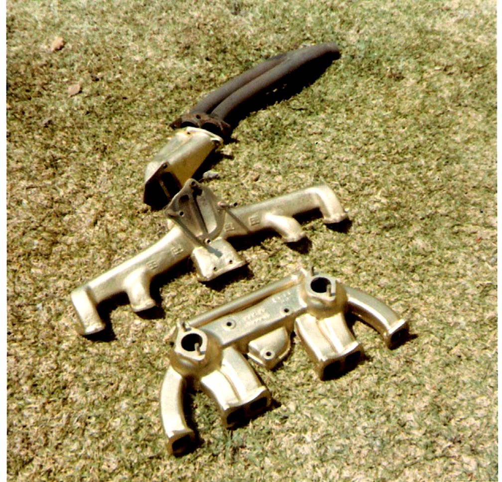

  28. My timing isn't good right now since y'all are in the middle of the crankshaft problem but these are scans of my little 3" x 3" photo prints from May of 1970 when I was restoring the yellow 1953 Hudson Hornet sedan and getting ready to install the Twin-H and 7X manifolding onto the car in the garage of my home in the Porter Ranch area of East Pasadena, CA. I thought "Now when will I ever get to take a picture of this stuff off the car again?" so I laid it out on the front lawn and shot it. I'm sure glad I did. That is a genuine 7X main exhaust manifold without any heat riser and genuine 7X elbow and genuine factory 2-into-1 head pipe. Had to share.
      214.1 KB
      289
      200.7 KB
      286
  29. studhud
    Joined: Jan 6, 2006
    Posts: 1,403
    studhud
    "had to share" you mean had to rub it in. That is one of the few I have ever seen and I have been into hudsons for a bit now. I think a "good" header would produce more ponies but that is kewl as shit.
    Dave
  30. jimi'shemi291
    Posts: 9,499
    jimi'shemi291
    Gotta run with no hood so you can SHOW off THAT kinda hradware!!! LOL
