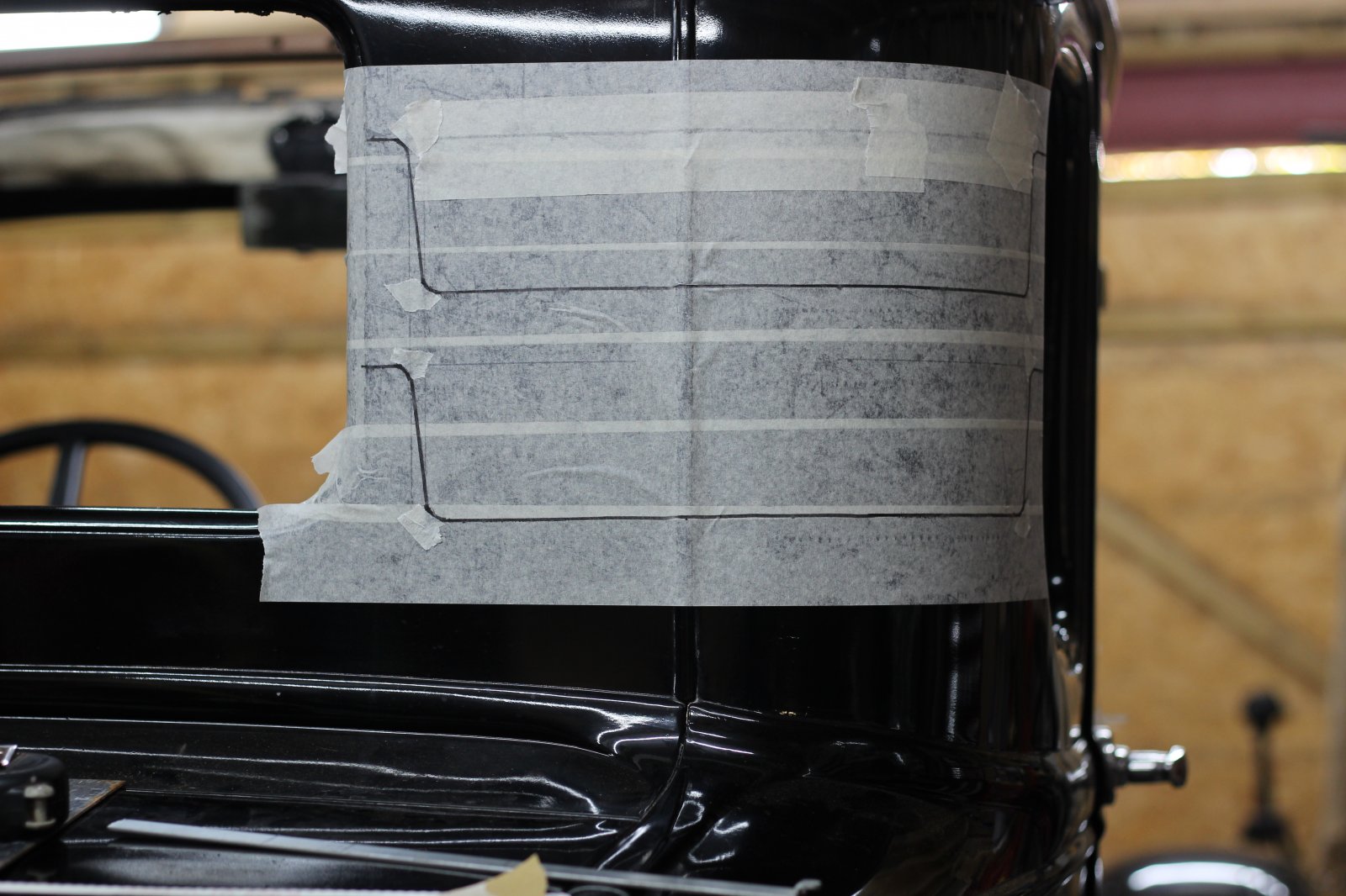

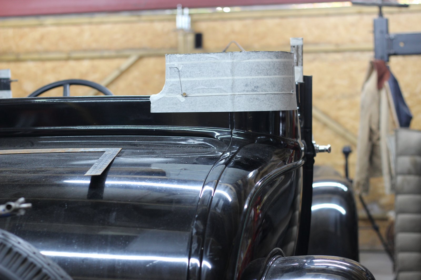

  1. I don't usually like chopped tops, but I gotta say I like the way you did it... radiused corners (the RIGHT way to fabricate), and not a straight-across cut... you did it right! I always grimace when I see square corners on cutouts, especially on frames. Good job!

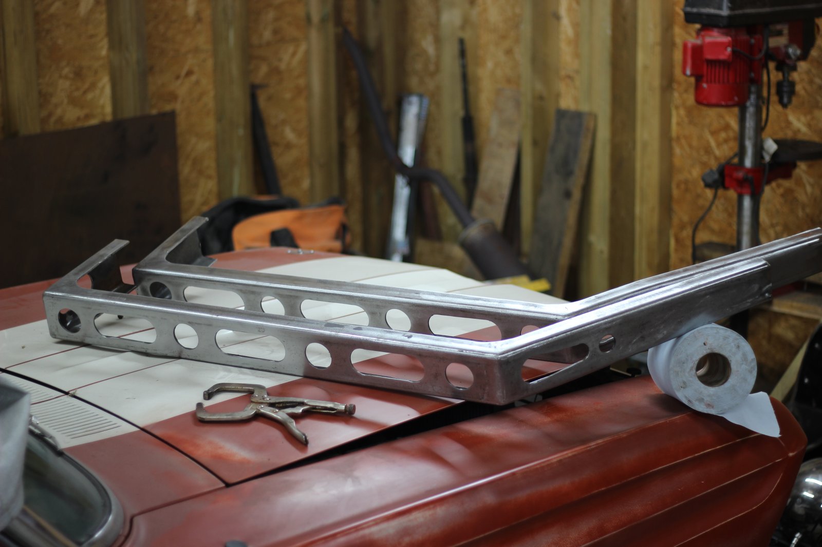

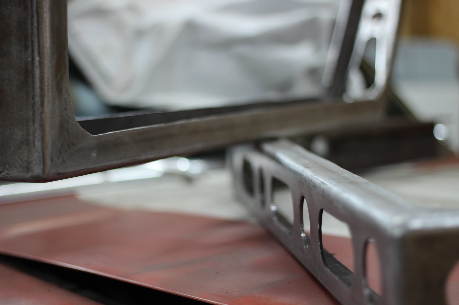

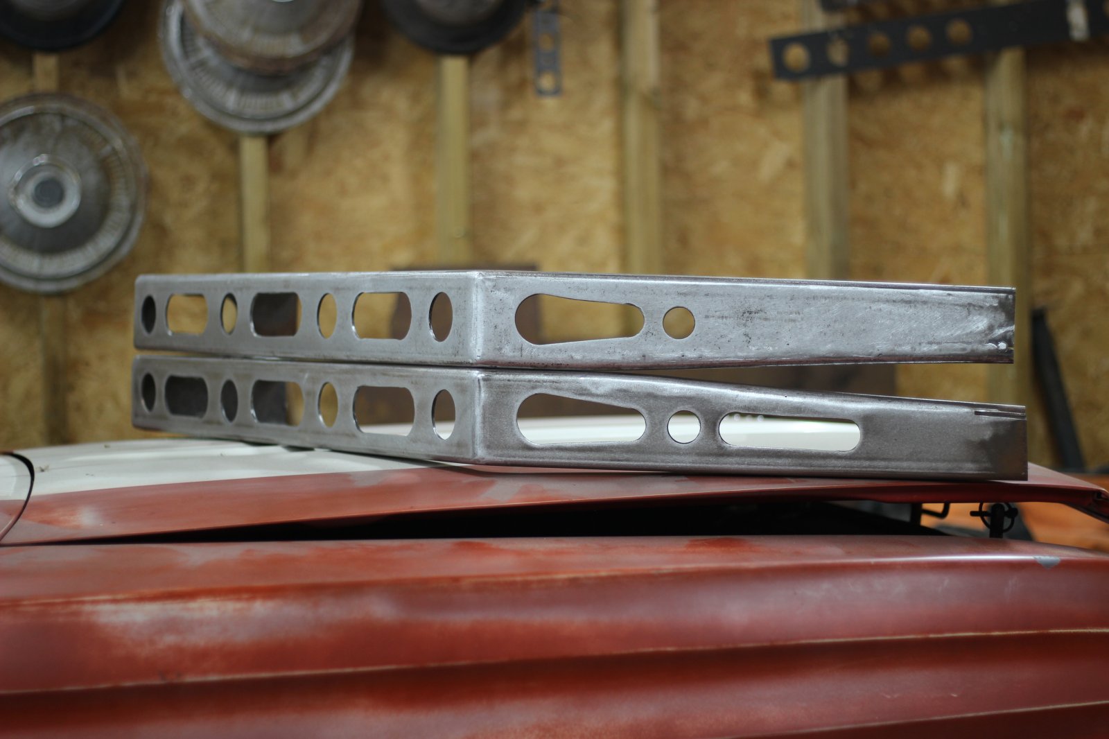

    Made a little progress. I made some templates and transfered to steel for the ch***is boxing and welded them in...

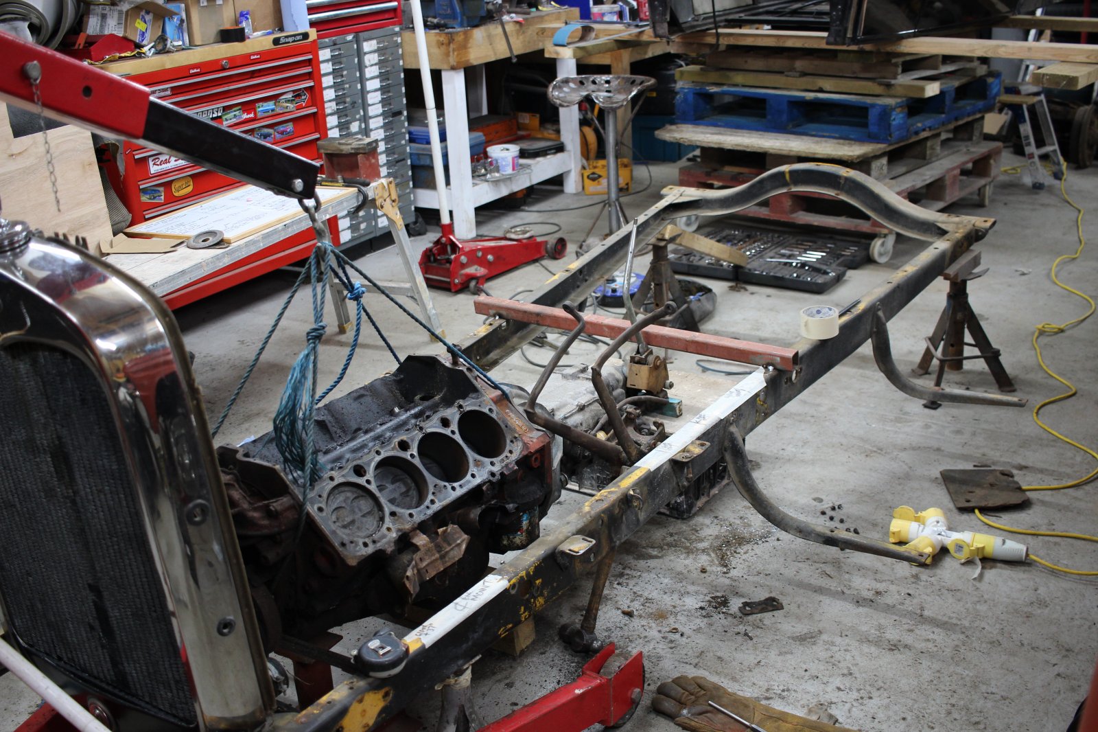

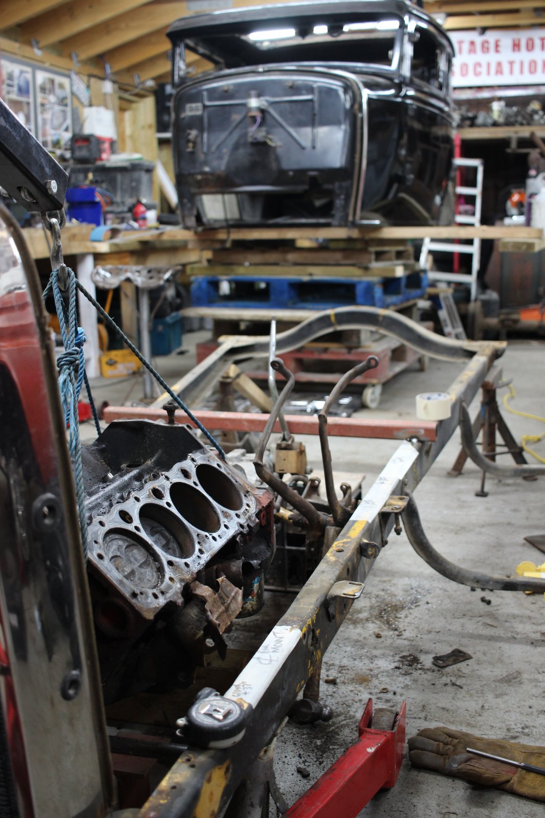

    Not meant to criticize anyone's methods so PLEASE accept this as sincere. Based off of one of the posted pictures the motor and transmission are rigged to your cherry picker with rope. Poor choice. And to my old eyes there isn't a safety clip on the cherry pickers hook? I'm new here but have worked steel and heavy equipment my entire life and I've witnessed some sad endings when improper rigging was used. When such things fail any damage to immanent objects is the least of anyone's worries.
    Feel free to tell me to piss off but I just couldn't ignore what I saw and really want you to be safe so you can get your awesome project on the street to enjoy.
  27. v8coupe
    Joined: Dec 8, 2015
    Posts: 48
    v8coupe
    from UK
    Guilty as charged! Thanks for pointing that out.
    Hope you didnt see the picture of the angle grinder with no guard:(
