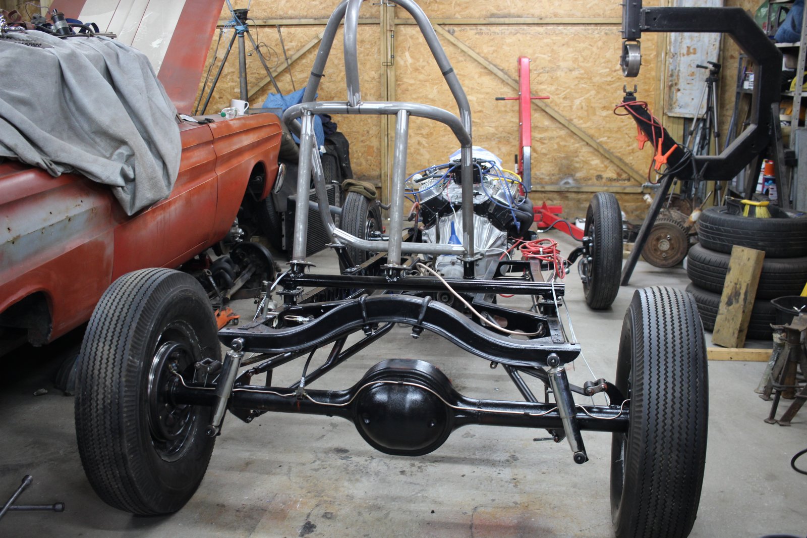

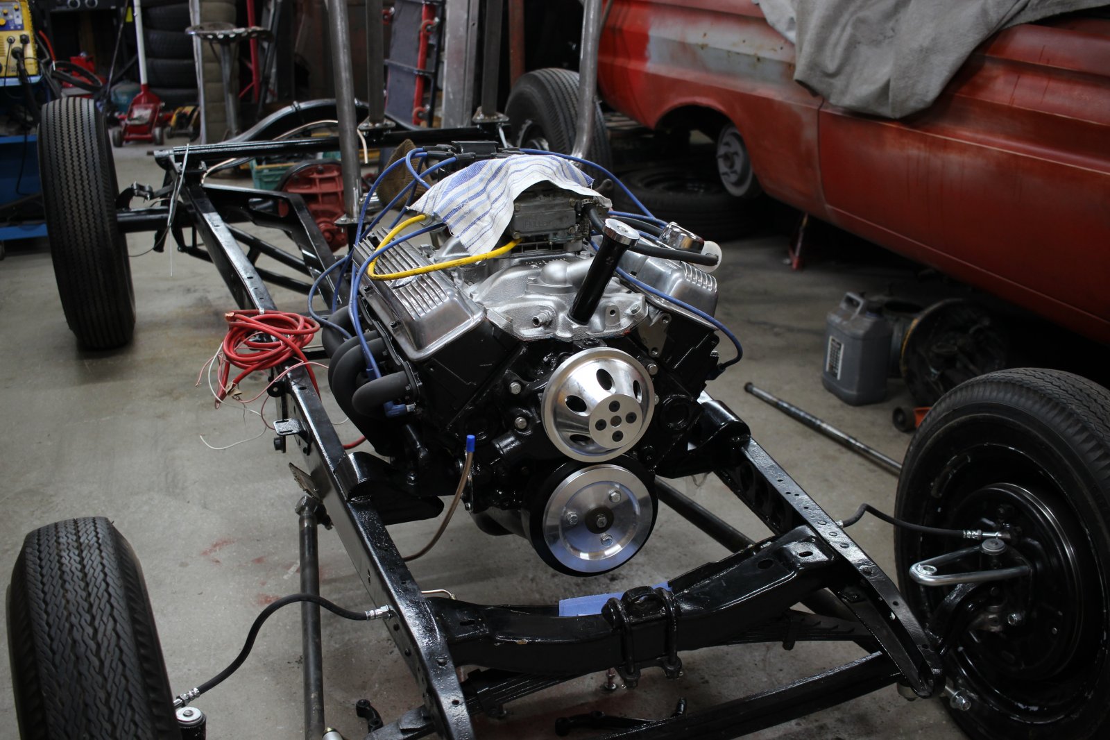

    Progress has been a little slow but a couple of jobs can be ticked off the list.
    I positioned the engine and gearbox where I was happy and made the mounts up. The gearbox mount bolts in so I can remove the gearbox easily.
    Next up is sorting the rear axle spring perches.

  8. v8coupe
    Joined: Dec 8, 2015
    Posts: 48
    v8coupe
    from UK
    A quick update..
    Made up a crossmember to carry the ladder brackets and welded that in. Fitted the rear axle and spent way too long wrestling with the rear spring and shackle bushes (I realised one shackle was binding so wasted time on that).
    I split the front wishbones, welded in brackets for them to the ch***is with a small gusset.
    Only thing left to do is weld the ladder bar brackets on and sort out positions for the cage cross members - to do this I put the body back on, so my next job is see where I need to sit - being on the short side means if I sit almost on the floor I cant see over the dash so will need a raised seat but then I think the top of my cage will have to be above the roof line. The cage is a necessary requirement to race at Pendine.
    Also picked up a cheap 305 which hopefully will get me on the road until my crate engine arrives.

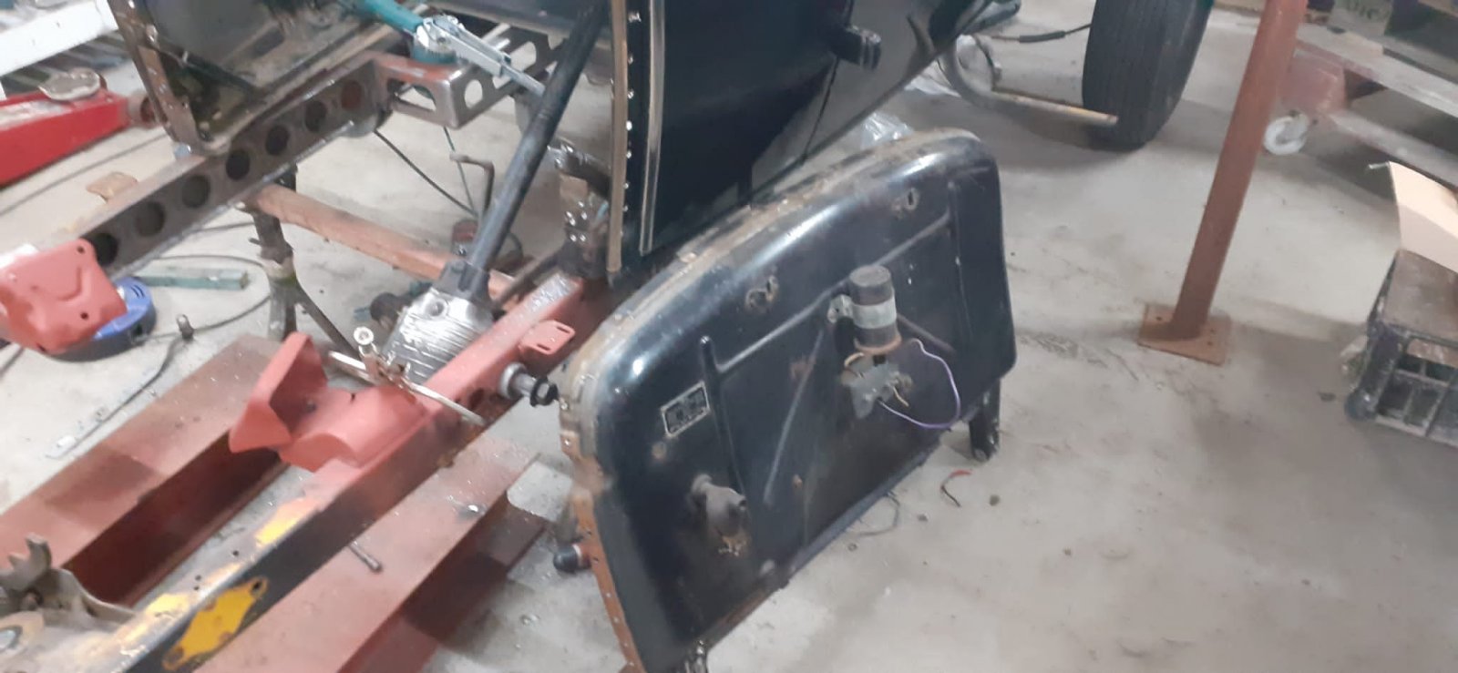

    Decided to sort the firewall out so everything fits. It seems to have taken a lot of effort and im not entirely sure if im happy with the result, i dont have the time now to alter it again so for the moment it will have to stay as it is, if it bothers me later on i will do something about it. Im frustrated with myself more than anything. But looking at the positives, the engine and bellhousing will fit and the dizzy will be removable!
    I reversed the firewall, i was going to double reverse it, so cut out the beads and flip those around too, but in the end the beads being the "wrong" way round didn't offend me at all - but i did reverse the concave section to gain some more room. I obviously also had to cut the tank to make room for the firewall. I removed and refitted the rad support rods and the ford tag to the new side.
    I made up a recess for the pedals to sit in, this is the part that bothers me....

    My tube arrived for the roll cage, but they sent 2" so that delayed things until the correct size came. I did manage to get the rear end stripped down and taken to Hauser to fit a locker and new bearings etc.
    Finally made a start on the cage, havn't finished it but have made a start, its only tacked together so far and the rear legs arent on it yet.. Im well chuffed with it so far. It uses a lot of tube that's for sure.

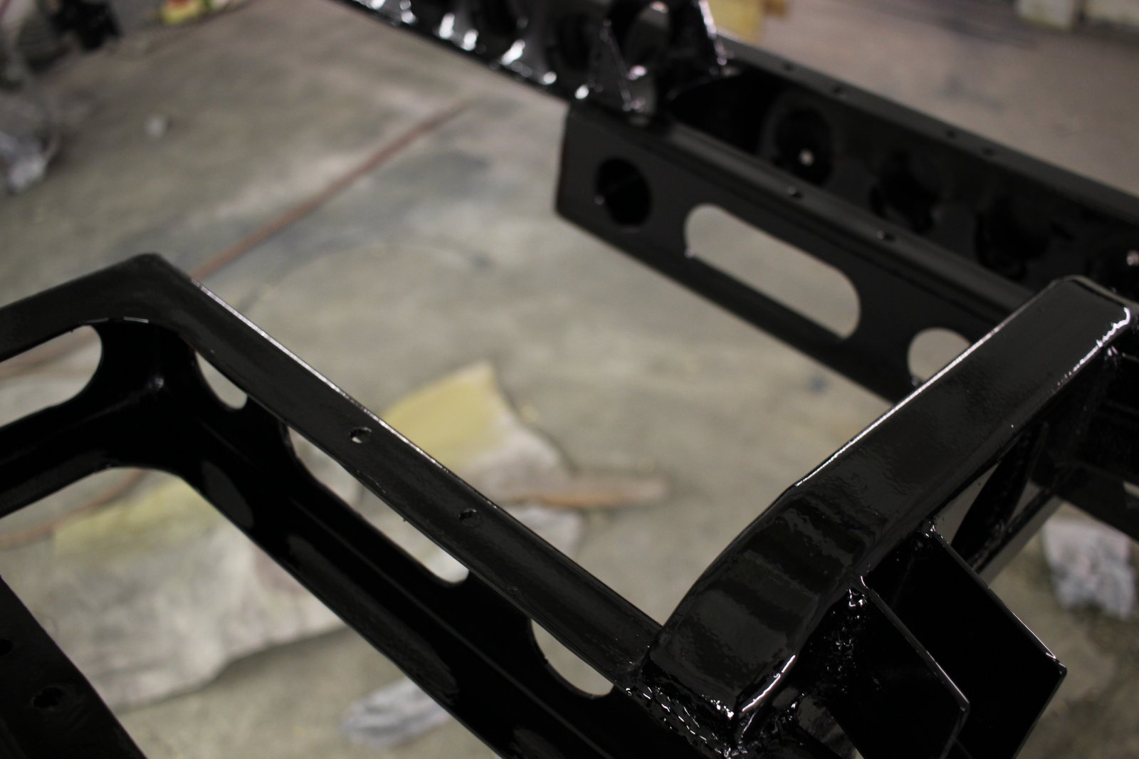

    Another job completed, that's the ch***is painted...
