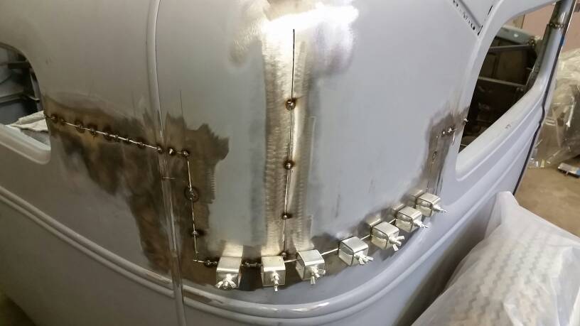

    FinnishFireball

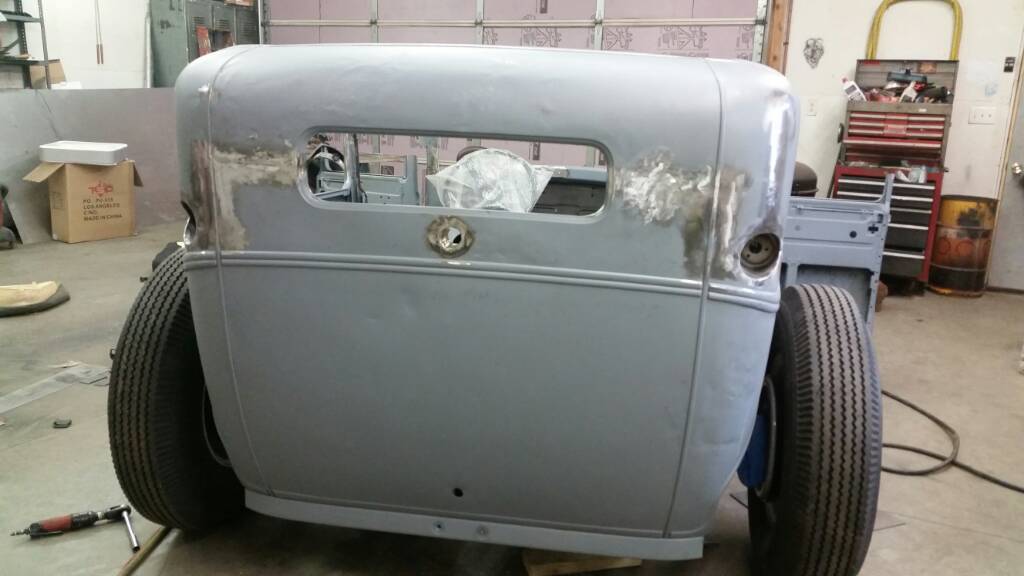

    Looking good! Btw. whats the benefit of cutting rear pillar this way versus straight line cut? I chopped mine with one horizontal p*** and had no probs that way either. Although few vertical reliefs were necessary. Can't wait to see this finished.

    PanelDragger
    It's just the way I have been reading about, from what I understood, keeping you cuts close to body lines helps with reducing warpage.

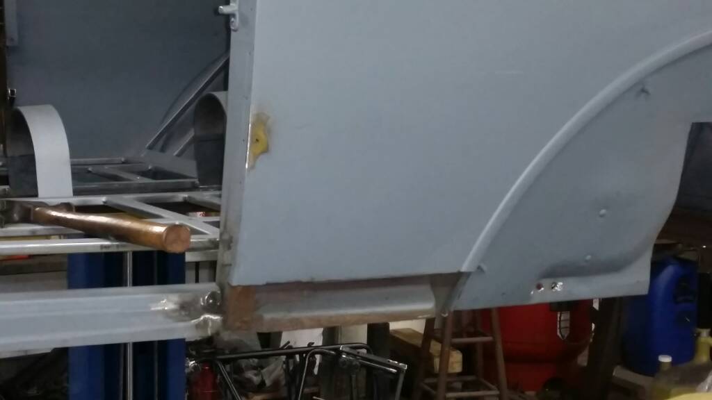

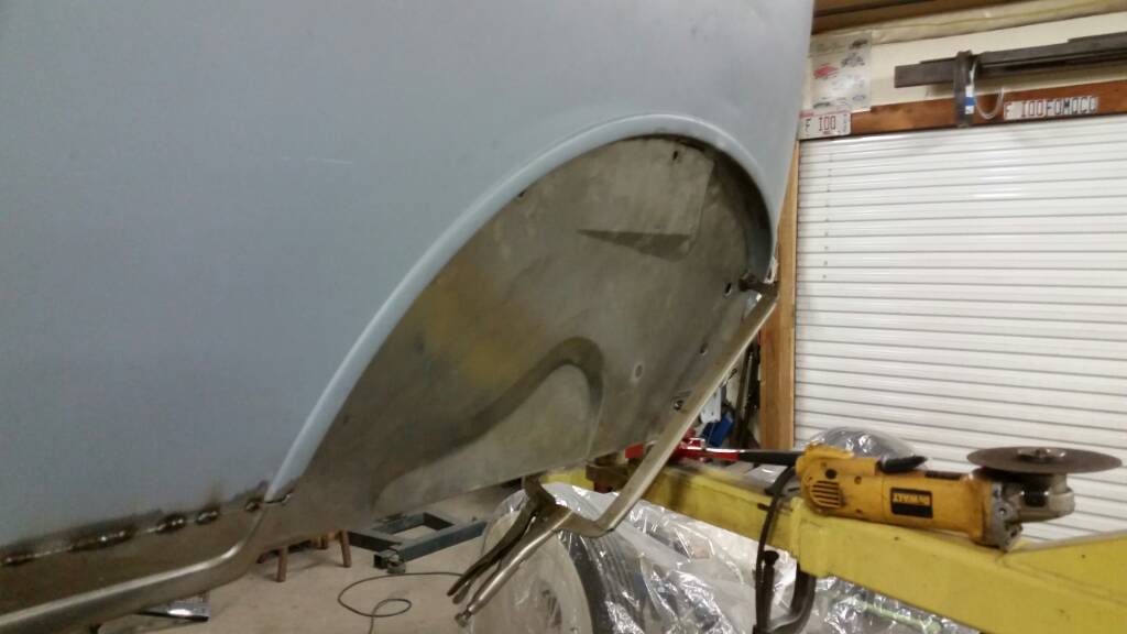

  4. Hey Matt, I couldn't send pictures in a PM. But these are the relief cuts you need to do in the rear roof area. ImageUploadedByH.A.M.B.1419212800.637009.jpg
    If you look close you can see the weld where the cut is. ImageUploadedByH.A.M.B.1419212855.973791.jpg ImageUploadedByH.A.M.B.1419212872.675105.jpg
    PanelDragger likes this.

    Thanks that helps me a bunch.

  6. If you notice the 3-4" horizontal cut on top. When you get the vertical cut tacked up the top corner will seem to have a point or too much crown. Cut the smaller line on top and hammer and dolly it down to get a better crown.

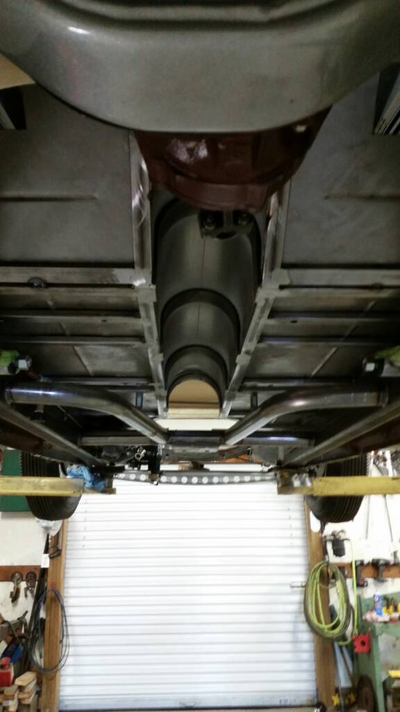

    PanelDragger

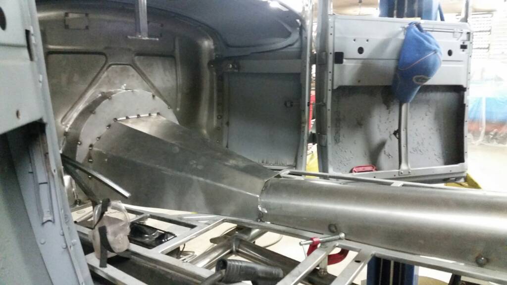

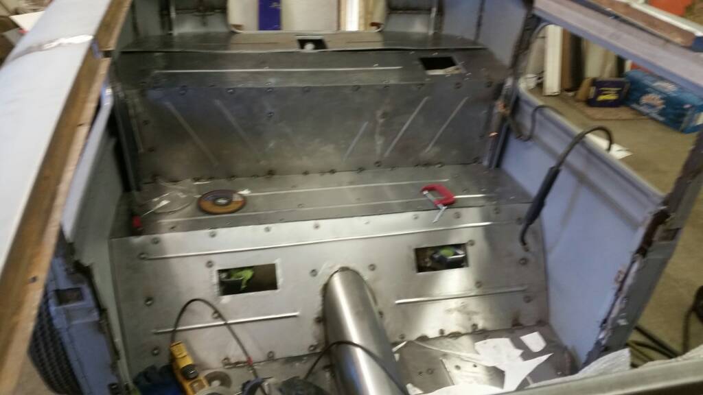

    Transmission tunnel, driveshaft tunnel, and firewall recess all done

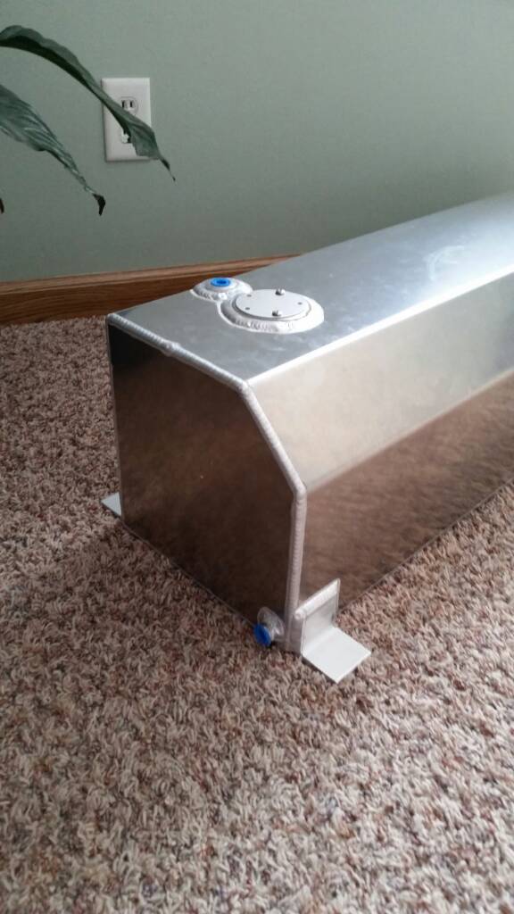

    PanelDragger

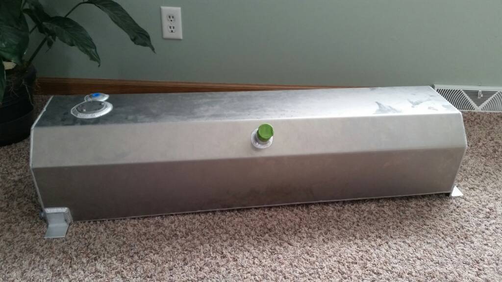

    Had a tank built at boyd welding. They done a great job. Car is back home now and I will be starting the ragtop this week. Had to do a little work on the side. I.e. brown thing. Running low on funds :D

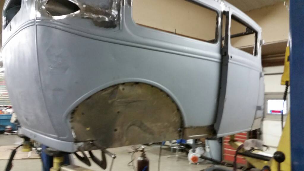

    PanelDragger
    Floor is 95% done, replaced side wood with steel, replaced top rails and header. Starting roof
